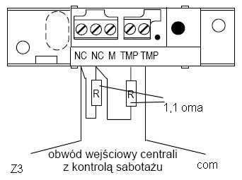

    I have a problem with connecting Satel S4 reed switches.
    I connected them as in the attached drawing, but on the CA-6 KLED-S keypad they flash every 2 seconds. diodes from these inputs. This probably means sabotage.
    What did I do wrong??
    The connection diagram is from the Reed Switch manual
    Please give me a quick tip :|
  • #10 3781358
  • #11 3781702
    milek99
    Posts: 197
    Help: 15
    Rate: 9
    In my hurry, I forgot to attach the drawing :D
    Maybe if you see the drawing, you will tell me whether it is connected OK and how it should be programmed in the control panel.
    I will add that I can program it as: NC, NO, EOL, 2EOL/NC, 2EOL/NO.
    I have it set as 2EOL/NC.
    And I`m not opening a new topic because this one was not closed and corresponds perfectly to my problem.

    I solved the problem.
    I checked the resistances and everything was OK, but I still had a sabotage on reed switch 2.
    First, I had it connected as in the attached diagram (red), on reed switch 2.
    After thinking about it, I connected reed switch 2 to another COM (blue in the attached diagram).
    From that moment everything started working.
    I will add that I installed the alarm for the first time and now everything works fine :) but I would still like to find out why the red connection was sabotaged :|
    Thank you very much sharp for very quick and specific help.
    • Wiring Surface Reed Switches to Satel Integra 24 System Kontaktrony.jpg (28.59 KB) You must be logged in to download this attachment.
  • #14 3785339
    adamjur1
    Level 42  
    Posts: 7051
    Help: 771
    Rate: 1000
    And how are your siren sabotages connected - in parallel?
    This is not smart because it does not protect these elements.
    If changing the ground of the inputs changed the operation of the control panel, this indicates damage to the comma, which is rather difficult and unusual......

    In fact, in parallel, I will change it to serial, and as for the COM, the tamper of the external and internal siren is connected to it and it works without any problems, but when I connect the COM connector from the reed switch to this connector, I still have tamper.
    I have the tamper input type set to "Enclosure", but this applies to inputs, not COMs.

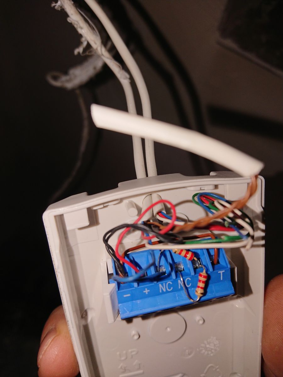

  • #17 20397312
    plucinskil
    How to connect the BL-4 satellite reed switch in series with the Bosch PIR detector? In the photo below, the PIR sensor is connected and the cable is led out under the reed switch
    l Wiring Surface Reed Switches to Satel Integra 24 System
  • #18 20397331
    bhtom
    Posts: 4495
    Help: 445
    Rate: 602
    In series with the detector`s alarm contact. But why such tinkering? Isn`t there a separate line available at the headquarters to do this properly?
    Regards.
  • #19 20397341
    plucinskil
    This is how the installer connected the detector and led a white 6-wire cable from it to connect the gate reed switch. The reed switch has only 2 wires, so I ask which contact should I connect them to?
  • #20 20397354
    bhtom
    Posts: 4495
    Help: 445
    Rate: 602
    First, check whether you have free lines in the control panel; if so, connect the wires of the reed switch to the free wires of the detector cable, which probably goes to the control panel.
