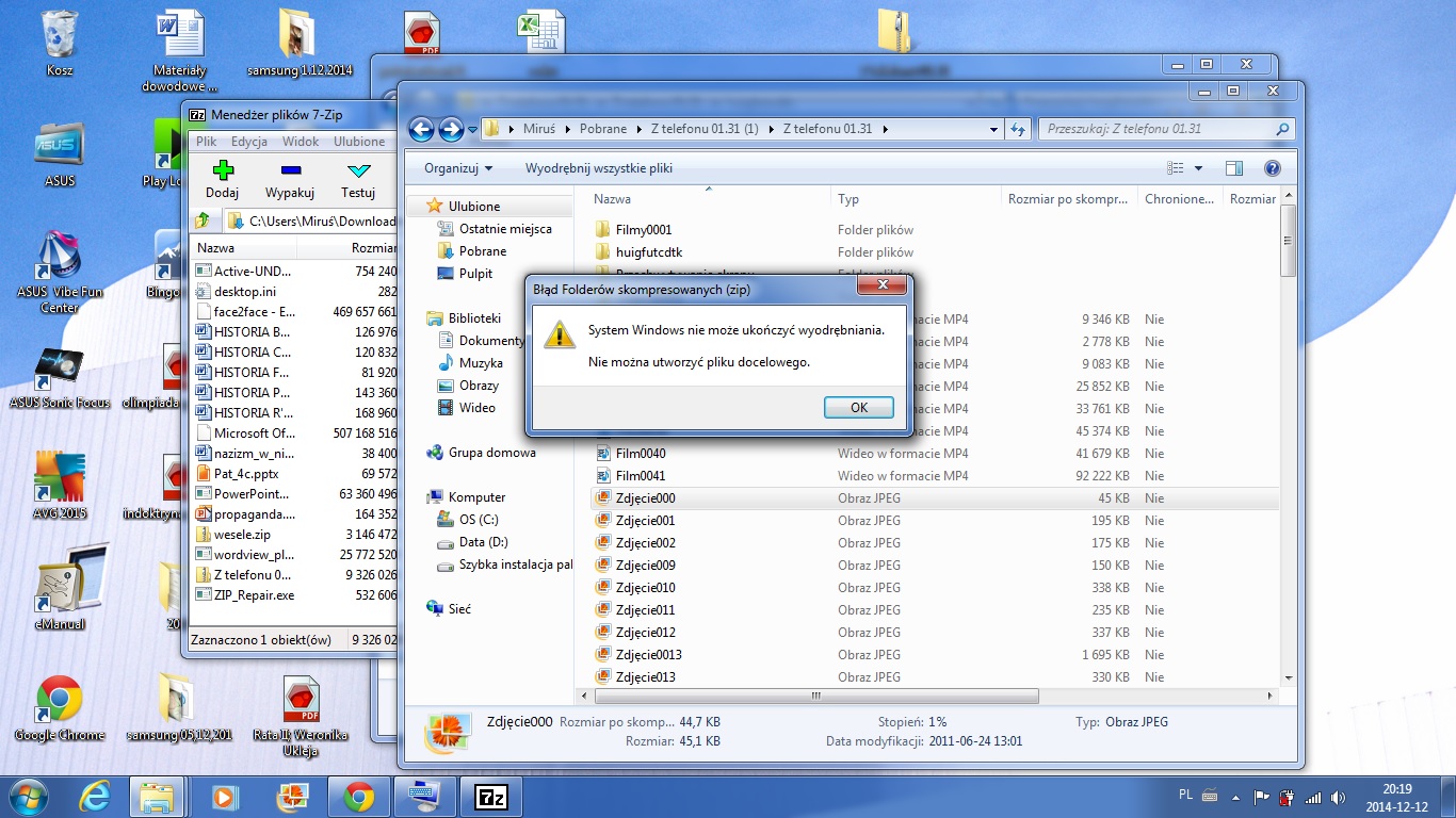

    Hello. I have a problem with compressed folders, it looks like the attachment, i.e. zip folders cannot be unpacked. I will add that I tried win7 and it also failed. Additionally, I tried to repair folders with zip repair, but also without any positive effects. Can anyone help me open folders correctly? I am asking and even begging for help ..
    Regards

    Why don't you try to pack through the 7zip I see in your screenshot? ;-)
    If you packed it with it, I am not surprised that the Windows zip is not overwhelmed by it. In 7zip you can set various compression methods which this Windows archiver cannot cope with.
    If 7zip is not very intuitive for you, you can always download WinRAR :)

    The files were packed with Winrar and when I try to unpack them with 7zip there are also problems as you can see in the attached picture. I haven't tried to unpack with Winra'rem yet, but I will download it soon and try ...

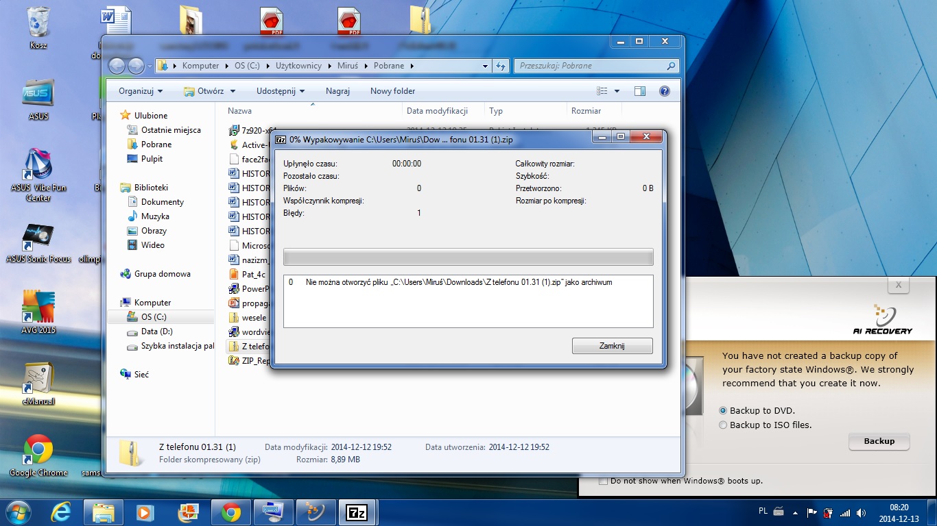

    Unfortunately, Winrar did not manage either :(

    All archives from all sources or only this particular one?
    In the first case, it is worth checking (testing) the efficiency of RAM and disk.
    In the second one, make sure if the source exists, if it is not a problem on its - or the way of data transfer - side, or check if another version of RAR will not allow for proper extraction (such "strange" related to the versions of this program already were described).

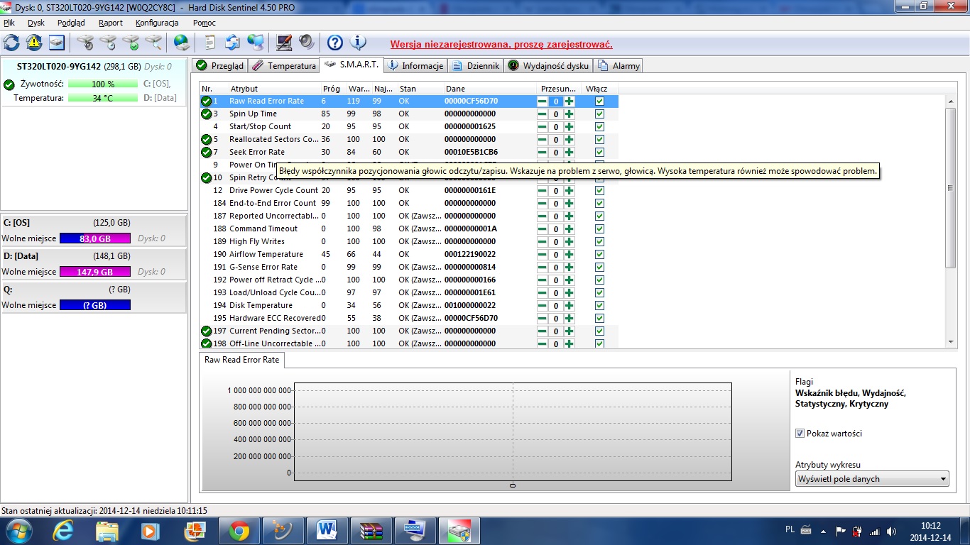

    Strange messages. Can you show SMART disk?
    www.hdsentinel.com

    I don't think this is the program's fault, because from several downloaded folders in zip format, one unpacks normally. :(
    In any case, please give me further advice on how to solve the problem
    And as for SMART - how to do it?
    (maybe it's funny, but I can't ..)

    Click on the link and download the program.

    Due to the fact that I do not know the program and the information that I show, I am throwing screenshots ... ;)

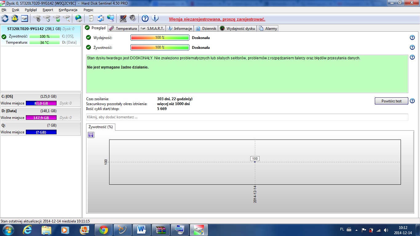

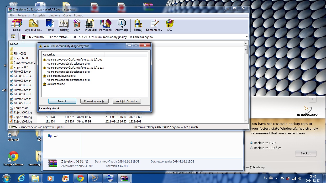

    The disk is in good condition.
    Archive damaged.
    From what I can see from the last WinRAR screenshot, it was an archive split into lots of small parts. In the folder under the WinRAR window I don't see enough of them (the program has 113 number, so there should be about that number.
    You have to find the rest of this archive, or you can comfort yourself with the first 8mb of data (this is what one part of the archive takes from what I saw in the screenshot).

    The condition of the drive is good. But it received a whopping 2,068 unacceptable impacts during operation, which could damage the surface. It cannot be said without the MHDD scan.
    Reading:
    https://www.elektroda.pl/rtvforum/topic2649888.html#12740428

    http://www.memtest.org/download/5.01/memtest86+-5.01.usb.installer.zip
    and make a bootable pen from which to boot the computer.
    But after so many hits on the disk, it also needs to be scanned.
    Weronikazaq wrote:
    Is there a chance that I will unpack these folders correctly?
    I doubt it because the archive is incomplete.

    Hmm ... Where did you pack this data? Were they on your computer? There is still a shadow of a chance that they will be recoverable if you have removed them.

    The files must have a common string in their name. Search like this.
