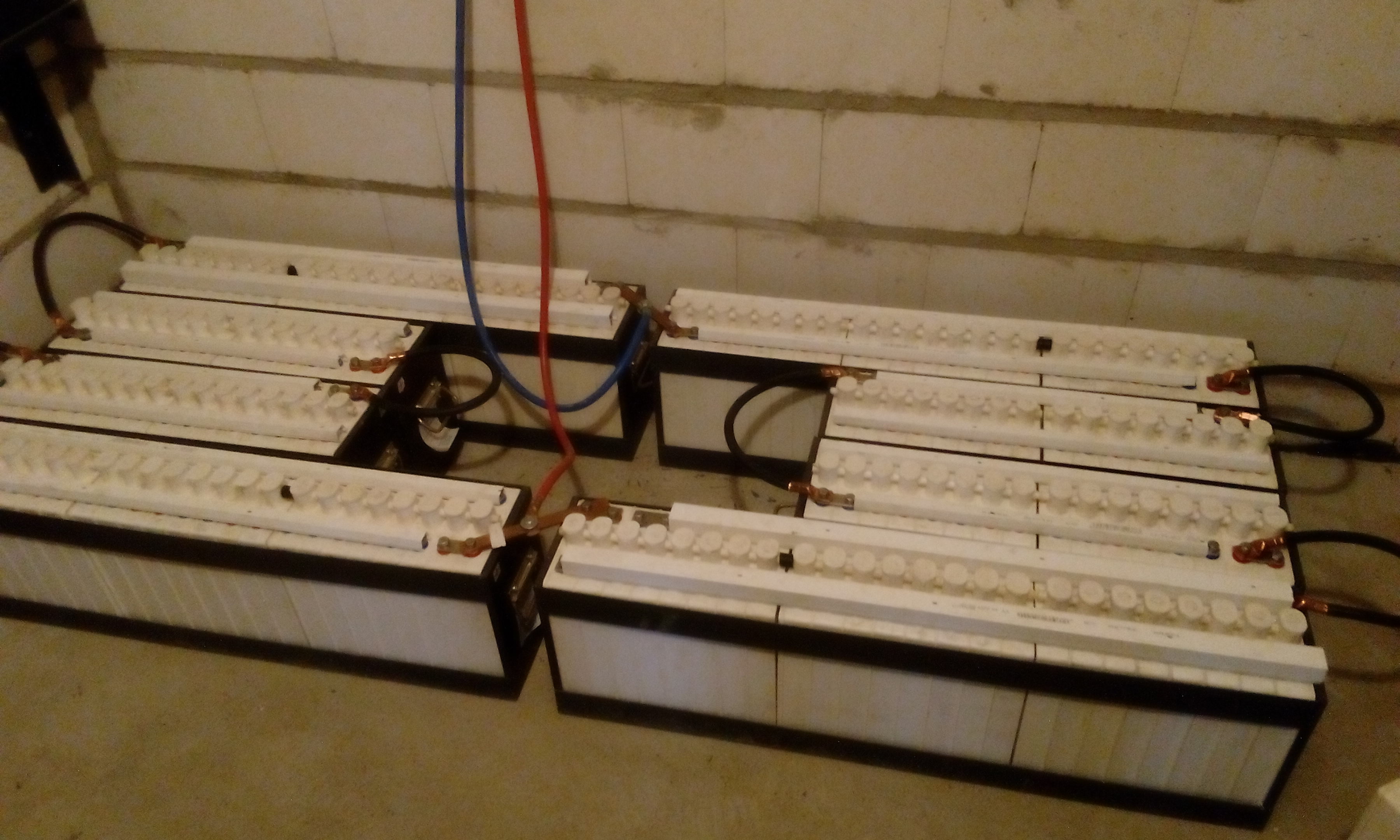

  • 5 kW MPPSolar inverter with 18 kWh alkaline battery bank
    #49 19055730
    rezydent1
    Posts: 279
    Rate: 155
    Yes, from my own backyard, I have a 5kW MPPSolar inverter (basically it's a UPS with the possibility of connecting PV panels) one phase with an 18kWh battery and the battery voltage is from 56V to 40V, additionally (especially now, at this time of the year), recharging these batteries is from the 2nd tariff (such a simple timer and contactor). There are not too many panels because 7kW. For my 4th person, the family is just right. I recommend alkaline batteries, they especially like long discharges, so for me they fulfill their task perfectly. I've been using it for 4 years now. This year I added about 5l of electrolyte to all batteries, which is not a big cost, in 5 years I will have to change the electrolyte, charge and then another 10 years from the head. I keep wondering why people don't use alkaline batteries.
  • #50 19057807
    TechEkspert
    Editor
    Posts: 7352
    Help: 17
    Rate: 5719
    I have never used, or even seen a live alkaline battery with topped up electrolyte ...
    Maybe you can write something about your experiences and about alkaline batteries in general in articles ?
    Basic Ni-Cd batteries with KOH electrolyte
    KPL, KPH, KPM, such a series, depending on the application, appropriate types are used. The best is KRH, and as in the case of acid, you can draw a lot of electricity without harm to the battery.
    And this is how it looks with me, you have a photo and a catalog card because I was buying from them.
    For me, they work in conditions from -10C to plus 28C - this is the maximum temperature that I have recorded over the years, cold is not afraid of heat, it's important not to overload, and so you forget about their existence for a year. As cooler, I raise the charging voltage, and warmer I lower it. The most important thing is that they are the most durable on the market and the average number of discharge / charge cycles is (in my case) 12000. The disadvantage is the loss of 5% of energy while charging, a lot of weight, but for me it does not matter.
