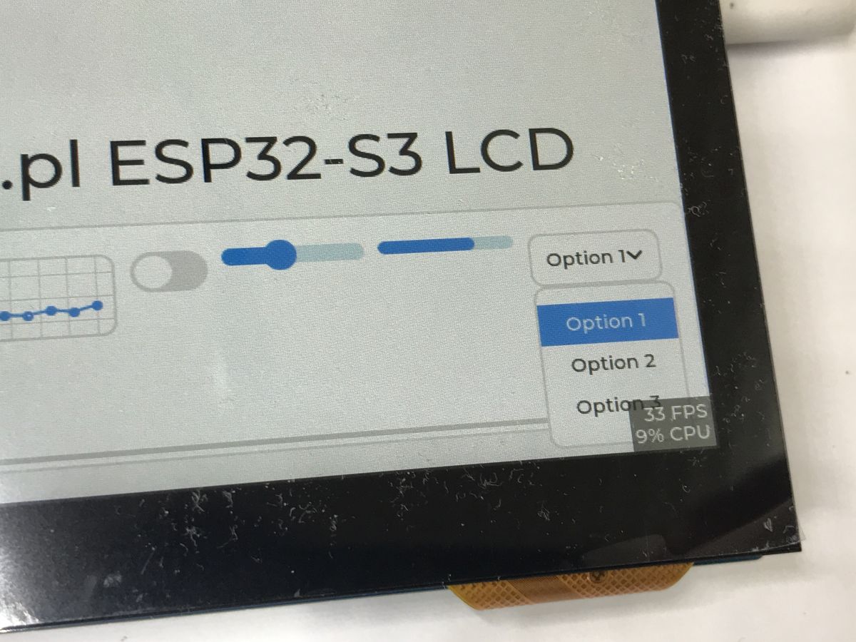

  • It behaves almost identically to the 5-inch version, but the frame rate still feels low and the display is less responsive than a modern phone.

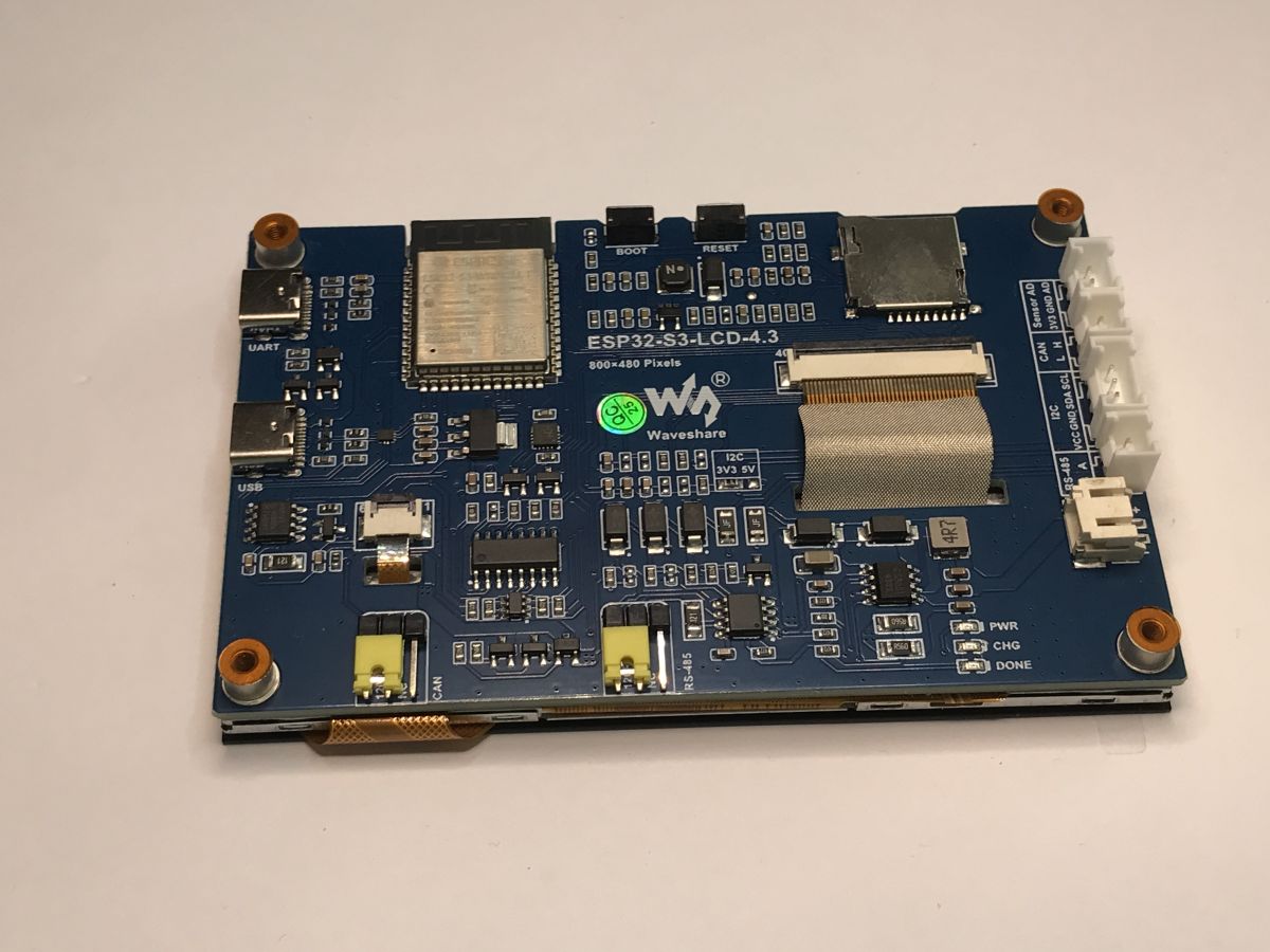

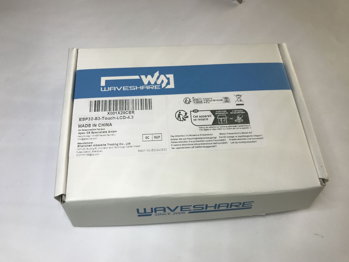

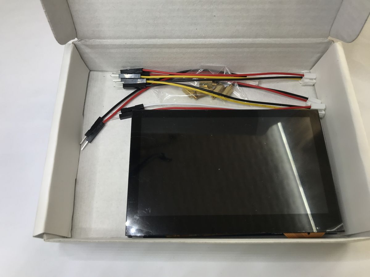

    The ESP32-S3 Touch LCD 4.3 is, as the name suggests, a module featuring a 4.3" touchscreen controlled by the ESP32-S3, which is a dual-core, 32-bit Xtensa LX7 processor clocked at up to 240 MHz with 8MB Flash and external 8MB SRAM. The whole is enriched by various peripherals such as RS485, CAN, I2C, a 3.7V lithium battery charger or there microSD card slot and not one, but two USB Type C connectors.
    The module can be bought in our country for about 175 PLN, from abroad you can import this board cheaper.
    ESP32-S3 Touch LCD 4.3-inch module and power cables in a white cardboard box. White box with a blue stripe, labeled Waveshare and ESP32-S3-Touch-LCD-4.3 product sticker. Waveshare ESP32-S3-LCD-4.3 development board with visible connectors, chips, and ports. .

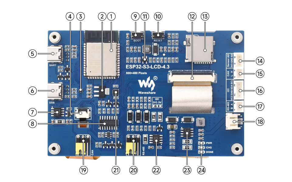

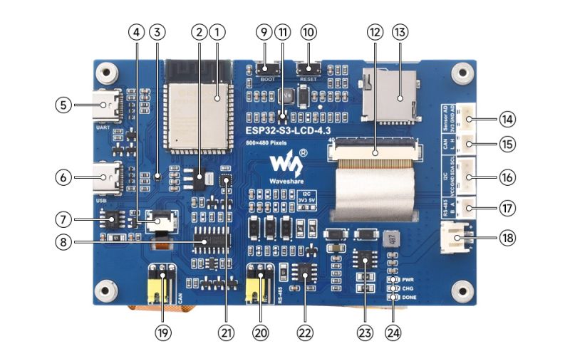

    Information about the board is best checked on the official manufacturer's website . The connectors and on-board circuitry are described there in detail:

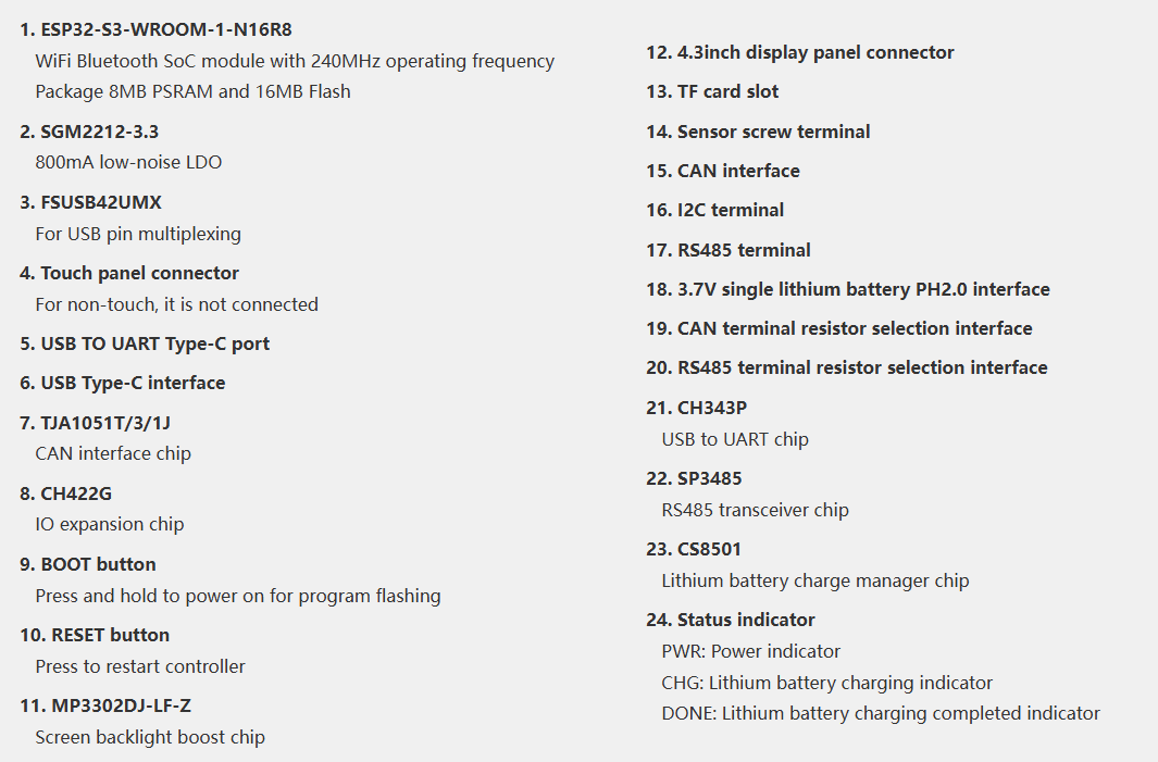

    Diagram of the ESP32-S3 Touch LCD 4.3 board with labeled and numbered connectors and electronic components. .
    A list describing components and functions of the ESP32-S3 Touch LCD 4.3 board. .

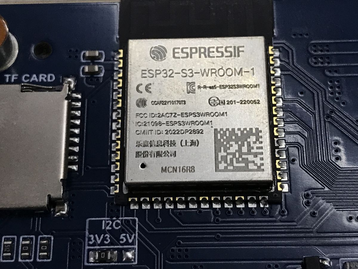

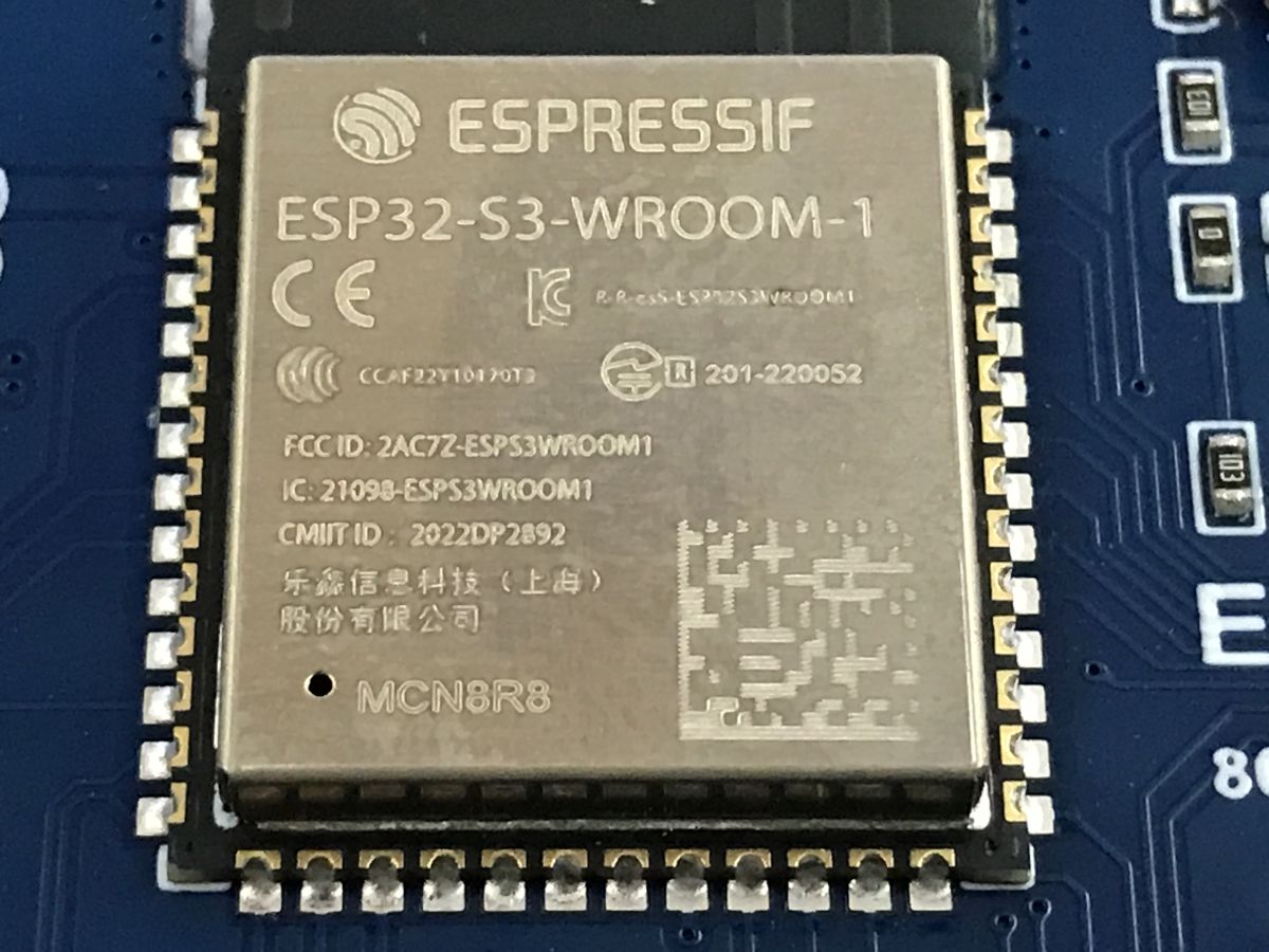

    ESP32-S3-WROOM-1 module on a PCB, next to a TF card slot and I2C, 3V3, and 5V markings. .
    ESP32-S3-WROOM-1 module with detailed markings on a PCB close-up. .
    Both are ESP32-S3-WROOM-1, but one is MCN8R8 - 8MB, the other is MCN16R8 - 16MB Flash. RAM 8MB in both. The program from the 16MB version does not even start:
    E (31) flash_parts: partition 3 invalid - offset 0x650000 size 0x640000 exceeds
    flash chip size 0x800000
    E (32) boot: Failed to verify partition table
    The solution turned out to be editing the BOARD_CUSTOM.json file - changing the default_16MB.csv partition table to default_8MB.csv, I also changed the Flash size in the upload section.

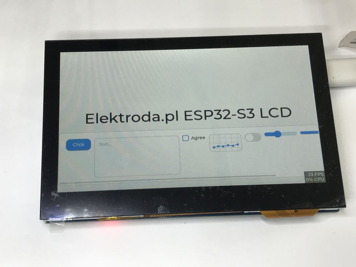

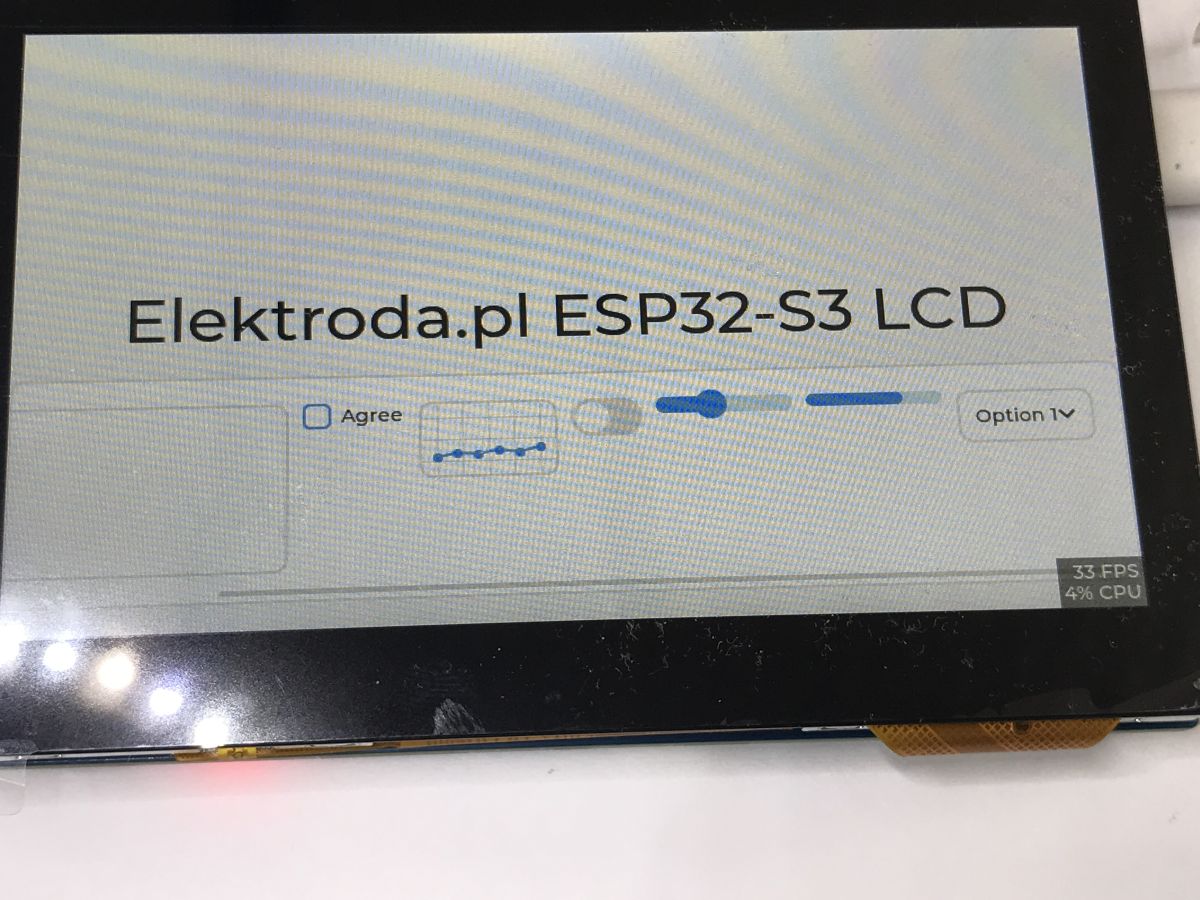

    I have prepared simple example code for this, which sequentially creates different types of components within a single template:
    Code: C / C++
    The above code creates successively:
    - a label (lv_label) with text in large font, centred on the screen
    - a container/template (lv_obj) with a flexible horizontal layout (LV_FLEX_FLOW_ROW) and spacing between elements
    - button with 'Click' label
    - text box (lv_textarea) with hint text "Text..."
    - checkbox (lv_checkbox) with the text "Agree"
    - line chart (lv_chart) with sample data
    - switch (lv_switch)
    - slider (lv_slider) with a range of 0-100 and a set value of 40
    - progress bar (lv_bar) with a set value of 70
    - a dropdown menu (lv_dropdown) with three options to choose from
    Result:
    Close-up of an ESP32-S3 touchscreen showing a LVGL app UI with GUI components, a dropdown menu, and FPS/CPU stats displayed. The ESP32-S3 LCD 4.3 touchscreen displays a graphical interface with a label, checkbox, chart, slider, and dropdown menu. .
    Basically, that's it - you can programme.

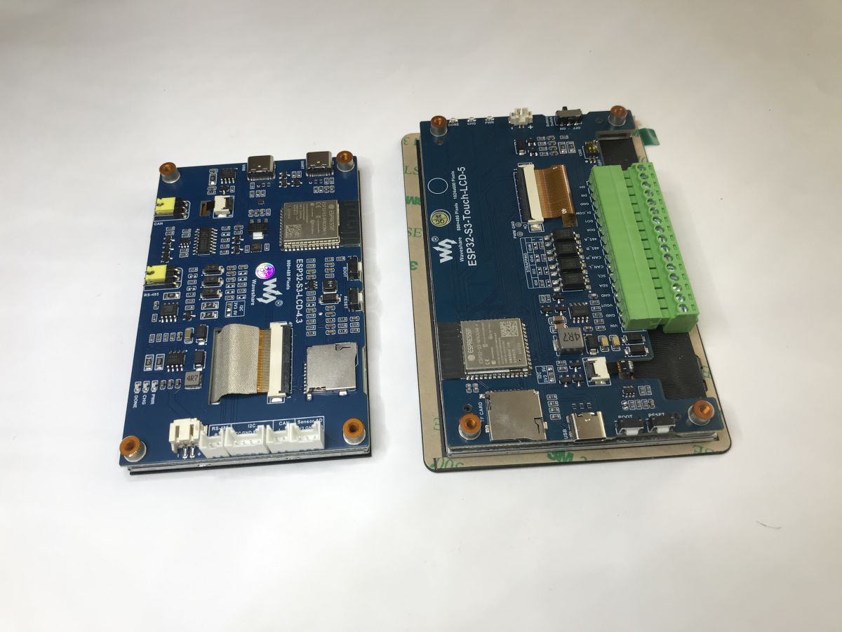

    Finally, a comparison between the 4.3" and 5" versions:
    Two ESP32-S3 touch displays on a white surface – the smaller one on the left, the larger one on the right. Two ESP32-S3 Touch LCD modules of different sizes, placed on a white background. .
    In summary , this was a very similar board to the already discussed Waveshare ESP32-S3-Touch-LCD-5 , there were no differences on the display control side. Only the ESP32 partitions had to be changed and it managed to be programmed just like the "five".
    The rest is identical to the "five", here too the display seemingly looks good, But the frame rate often drops quite low and it feels not as responsive as today's mobile devices.

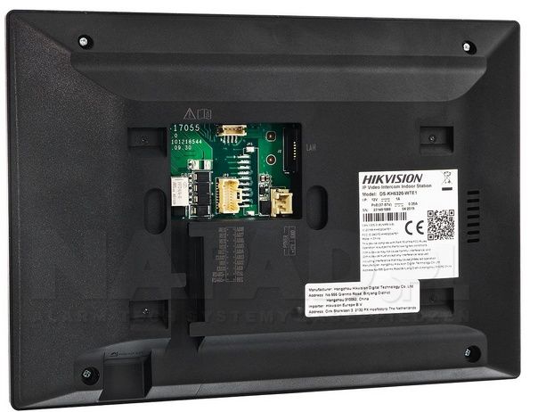

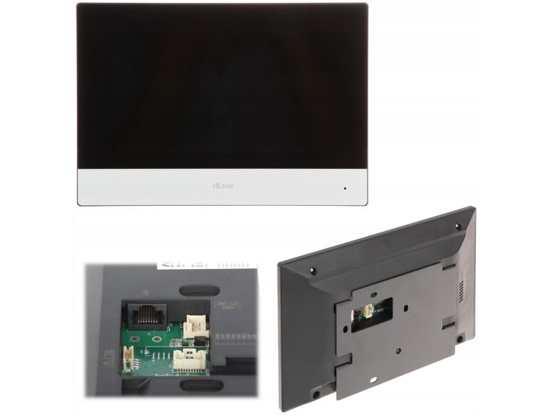

    What puzzles me is why manufacturers do something like this. What is the purpose of this device? If I fix it on the wall, am I supposed to run wires out in all directions?
    The same if I add a stand for a free-standing device. Are the wires supposed to go off in different directions?
    Here is an example of how something like this is done (IP intercom example):
    ESP32-S3-Touch-LCD-4.3 i.e. ESP32-S3 and touchscreen - launching at PlatformIO .
    All connectors fairly central, at the rear and perpendicular if possible

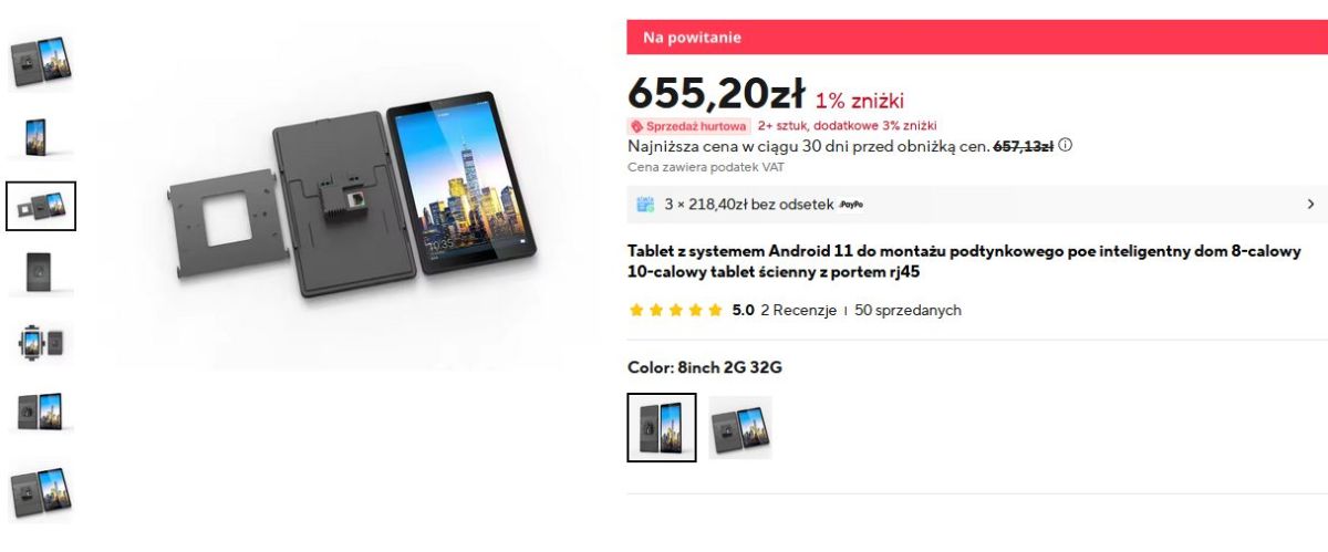

    Has anyone bought or analysed buying something like this:
    Link . I am concerned with how it performs.
  • #7 21563535
    chemik_16
    Posts: 1001
    Help: 75
    Rate: 128
    >>21563523 .
    You buy any tablet and lan card on usb as you need.
    I generally use android tablets for HA but they have all sorts of flops, they reset, battery swells after a while etc.

    This microcontroller is too slow for such resolutions, 10 FPS is however not enough - we are talking about a touch-controlled user interface, the data display itself as OK.
  • #13 21563934
    chemik_16
    Posts: 1001
    Help: 75
    Rate: 128
    >>21563864 .
    120fps needed to turn something on with a button ? :)
  • #14 21563970
    dktr
    Level 26  
    Posts: 937
    Help: 45
    Rate: 732
    120 is not necessary, but the 30 must be so that the device gives the impression of being modern and not a mulled crisper made a dozen years ago ;)
