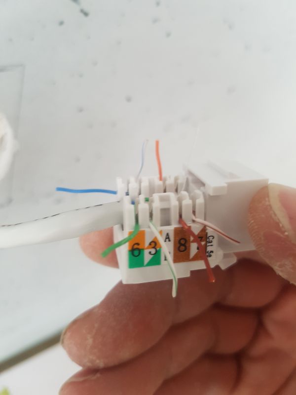

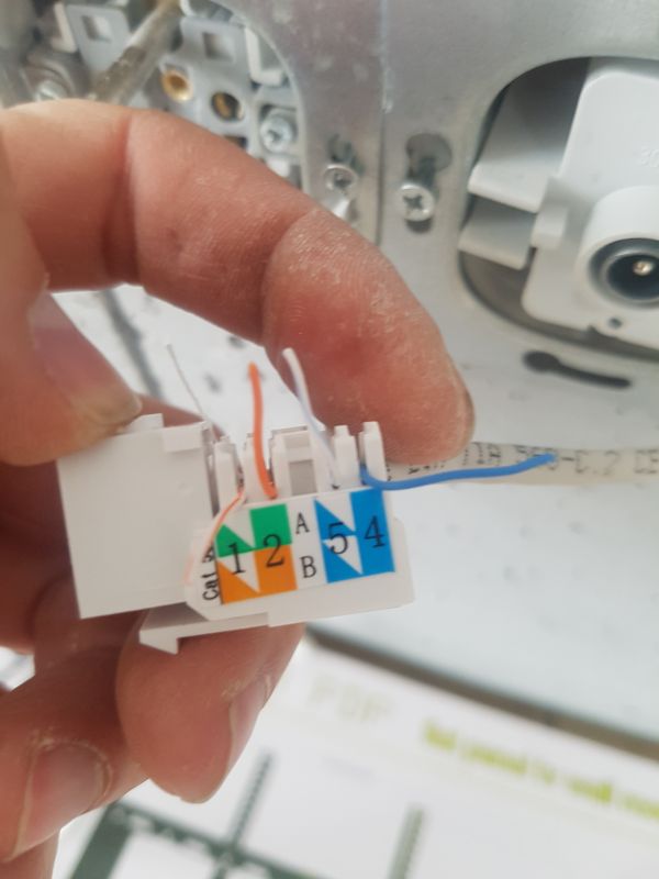

    I sewed the socket in the wall with a twisted pair in accordance with the B standard.
    I earned a plug in the switchboard according to the B standard, i.e. white-orange, orange, white-green, blue, etc.

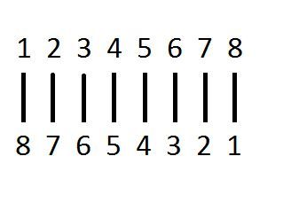

    On the cable tester mi shows wires 1-8, 2-7, 3-6, 4-5, 5-4, 6-3, 7-2, 8-1 etc
    If I put a ready cable into the tester, it shows 1-1, 2-2, 3-3, 4-4, 5-5, 6-6, 7-7, 8-8.
    Will my connection work?
    Ps. I thought that I gave the plug the other way around when I earned money, but when I changed it, the tester showed the circuses ...
    Please hints.

    Thanks. The question is whether you can see my graphics (maybe only I can see them for some reason)?
    Pinned as exactly as in the photos I uploaded in the 1st post. - according to me according to the B standard, the same plug and the tester shows that instead of 1-1 it is 1-8 and similarly ..
    I do not know if I do the same order, I do according to the labels on the socket (photo) and the order of the wires according to the same standard on the plug .. I plug the tester tip into the socket and the tester into the switchgear and it comes out 1-8 instead of 1-1. I can not find what I am doing wrong and I have no way to check if such a connection will work ;-(
    I found that e.g. RJ45 connection barrels support: RJ45 (8P8C) 1: 1 = 1-1, 2-2, 3-3, 4-4, 5-5, 6-6, 7-7, 8-8
    RJ45 (8P8C) cross = 1-8, 2-7, 3-6, 4-5, 5-4, 6-3, 7-2, 8-1 then maybe it should be like that, it shows 1-8 for me not 1-1?

    On the nest side, if I have mastered this confusion, it should be:
    1 - Brown
    2 - white-brown
    3 - Green
    4 - white and blue
    5 - Blue
    6 - white-green
    7 - Orange
    8 - white and orange
    By looking at the numbers you have on the keystone stickers.
