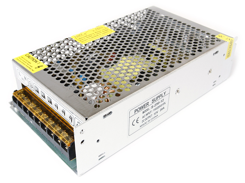

    I would like to get advice on connecting the RGB LED strip.
    My device data:
    RGB 5050 14.4 W tape per meter, I have 16 meters of tape (3 sections - 6 meters, 6 meters and 4 meters - connected to one controller and power supply)
    The first configuration that was on the tape was:
    230 V -> 12 V 8 a power supply (i.e. 100W - that's what the seller sold me) -> RGB controller (Chinese) 3 x 4a
    Connecting the led strip - unusual - pairing the remote control - one remote con Connecting the led strip - unusual - pairing the remote control - one remote con
    After about a year the power supply burned down, I bought a 12 V modular power supply 20 a = 250 W
    The set worked about 2-3 months because the LED controller burned out I decided to buy a 24 a controller!
    And now I got a lesson in the selection of devices cool and beautiful. Since I have a tape that draws 230.4 W power, I need a power supply and controller over 230W.

  • #2 16389652
    matej1410
    Level 25  
    Posts: 1085
    Help: 115
    Rate: 219
    betonuki wrote:
    1. Can I pair a 3 x 4a remote control (black touch - the one I don't use) with a 3 x 8a controller?
    It's best to just check it by trying to pair. If it goes wrong then everything is clear.
    betonuki wrote:
    2. Can I connect 3 controllers (Chinese) to each episode and pair one Chinese remote controller to them to control these controllers at once?
    From the pilot's point of view, you can control several receivers if the signal from it is understandable to everyone. In other words, if you buy 10 identical sets (10 receivers and 10 transmitters) then you will be able to control 10 receivers with one transmitter.
