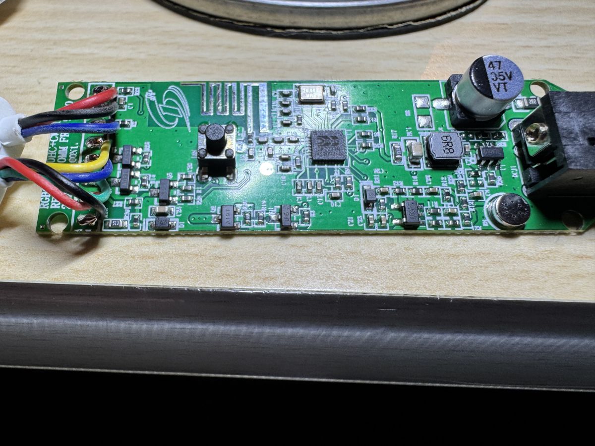

    jeroenvtec
    Posts: 14

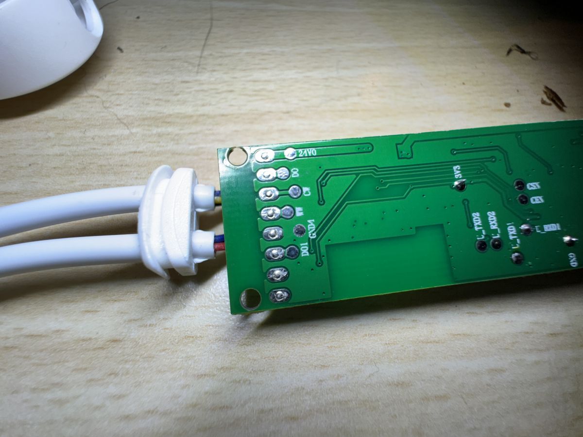

    I have flashed succesfully a other lsc controller but there is no led light at all. Even ww and cw are not working. It looks the same as de 2x5m version but it is not.
    Tried pwm op pin p24 abd p6 but nothing.
    This is the info from the flasher:

    - Microphone (TODO) on P23
    - LED Cool (Channel 4) on P6
    - IR Receiver is on P26
    - PWM Frequency 1000
    - SPI MISO 17
    - SPI MOSI 16
    - Control Pin (TODO) on P22
    - LED Warm (Channel 5) on P24

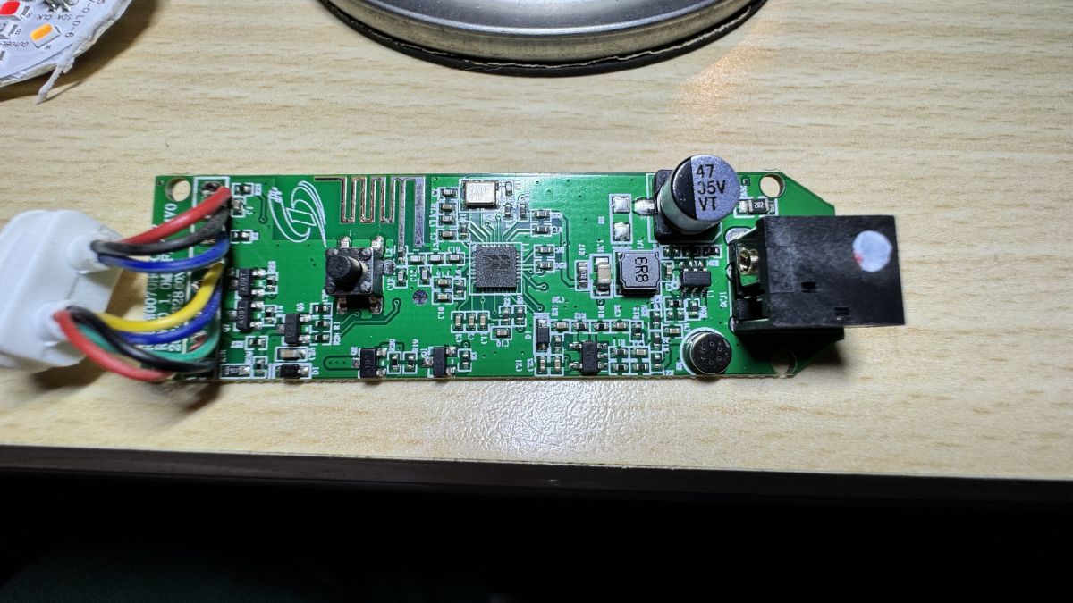

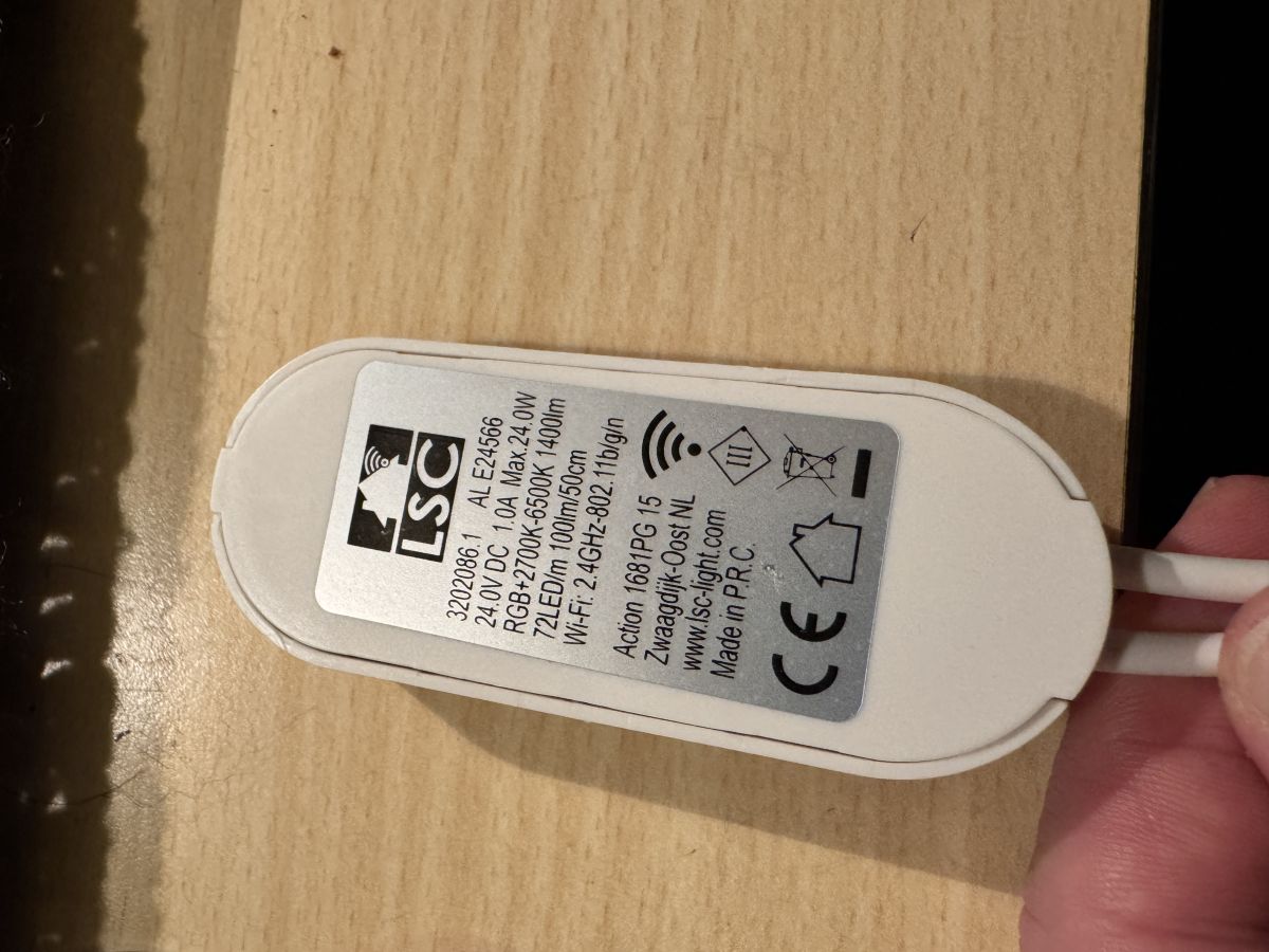

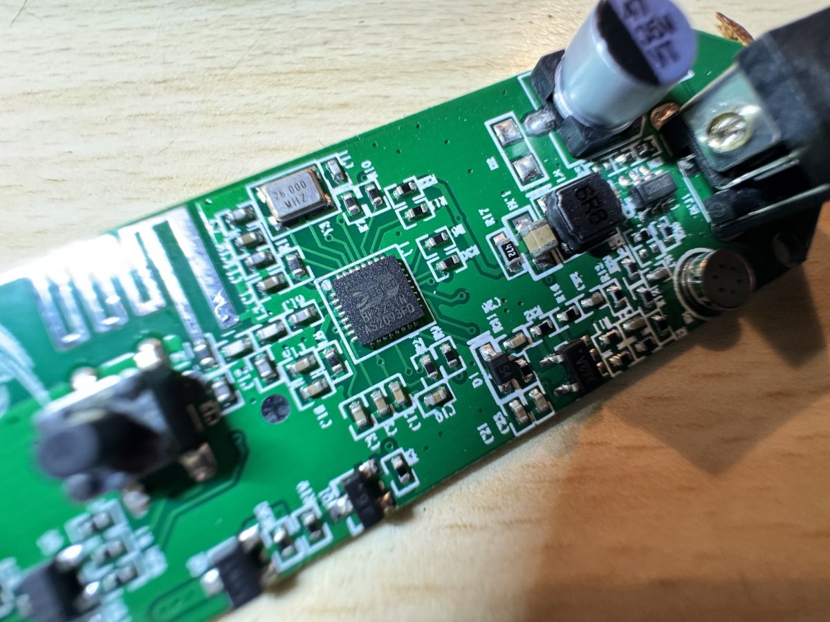

    Device seems to be using CBU module, which is using BK7231N.
    LED controller circuit board with visible soldered connections Section of LED strip with visible pins and electronic components. Box of LSC Smart XXL LED Strip with image of the strip and smartphone. LSC controller with technical label on a wooden surface. PCB with electronic components, including a BK7231 microprocessor. LED controller PCB with electronic components LED controller with connected wires on a desk
    What I am missing /doing wrong ?
    AI: Could you specify the firmware or software version you used to flash the LSC controller?
    OpenBK7231N_1.17.802
    AI: What are the specifications of the power supply you are using for the LED strip and controller?
    24v 1a

    This device is known to have extra pin used to toggle on and off whole LEDs. Use GPIODoctor to find out which pin is used for that.
    For RGB LEDs, you can use pixelanim driver:
    https://www.elektroda.com/rtvforum/topic4057187.html
  • BK7231N pin map works with DDP and IR copy
    #3 21361324
    jeroenvtec
    Posts: 14
    this works, also ddp, I copied IR from the 2x5m works also with that remote.

    Is the device fully working now? Did you also set autoexec.bat?
  • IR remote and power button not working on 10 m strip
    #5 21362075
    jeroenvtec
    Posts: 14
    Yes works fine
    rgb, white, warm white, dimming all working
    Effects are working fine
    DDP works fine
    what not works is original IR remote and the power button on the controller.

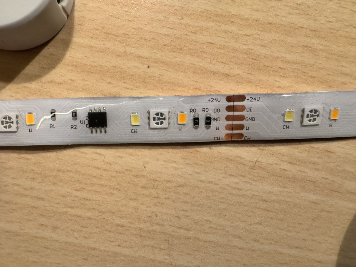

    Is is a 10m strip and "one" pixel is 24cm = 6 rgb lights and 6x w and ww leds, the picture on the box assumes other but is not ( just like the 2x5m version)
    I used:
    startDriver SM16703P
    SM16703P_Init 60 RBG
    startDriver PixelAnim
    startDriver ddp
