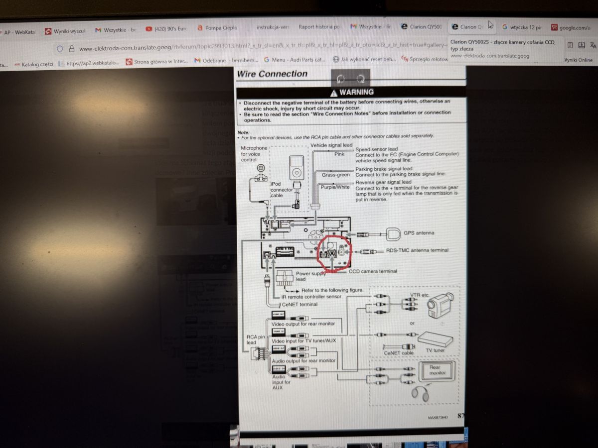

    I have a Clarion QY-5002S car radio (equivalent to MAX973HD). I wanted to connect a CCD reversing camera. The problem is that the camera has RCA plugs, and the radio has a certain "CCD CAMERA TERMINAL" input, which looks like in photo No. 1 (right).
    Clarion QY5002S – how to connect a CCD rear camera, what connector?
    Photo No. 1
    At the electronics store I was told that it would be difficult to get such a plug. There is no such cable in the official Clarion offer. In addition, it can be suspected that a direct connection of a CCD camera (taking into account all combinations) will not give an image anyway, because some "terminal" may be needed. In this situation, I decided to connect the camera to another input - RCA pin (photo 1 on the left). The problem is that I didn't have the right plug, so using the double pin and the diagram (photos 2 and 3) I connected the camera to the pins responsible for AUX (video in).
    Photo No. 2
    Photo No. 3
    The camera started working and it would be great if it wasn't for the fact that it only works when stationary. When driving in reverse, the video blocker on the radio turns on, because you can't watch TV while driving.
    How should I connect the camera to this input "CCD camera terminal", maybe someone knows where such a connector can be purchased? Does anyone have a diagram of this connector? And by the way, a question about the RCA pin connector separating to RCA connectors; is there any ready made or do i have to leave my homemade?

  • #4 14465462
    sosarek
    Posts: 83875
    Help: 9320
    Rate: 15527
    So disconnect the one labeled purple-white, and short the grass-green to ground. After such a procedure, the image from the source described as AUX (video in) should be constantly available.

  • #6 14465546
    sosarek
    Posts: 83875
    Help: 9320
    Rate: 15527
    It will be, according to the description, a cable for the handbrake sensor (according to Google translator grass-green).

  • #7 14469146
    marek407
    Posts: 6
    What's the ground cable? In the diagram, it is probably EARTH, but the diagram has a different cube arrangement than in reality. Should I assume it's the black one in the corner? I'd rather make sure because I don't want to fry anything.

  • #8 14472320
    sosarek
    Posts: 83875
    Help: 9320
    Rate: 15527
    Yes, described as EARTH (the mass will also be on the radio housing).

  • #9 14472614
    marek407
    Posts: 6
    Ok, I'll check after connecting the grass-green cable with black (ground). I checked yesterday after connecting to the housing as ground and the camera still turned off while driving.

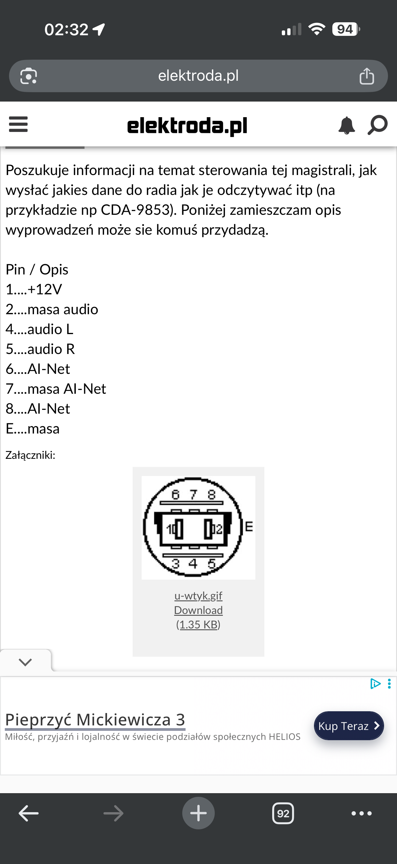

  • Clarion CCD connector pinout and reverse trigger wiring
    #13 21847053
    bernibernard123
    >>17622633 >>17622633
    Hello to all concerned 😎
    This is how I managed to connect the camera to the factory radio and to the dedicated CCD or Ai-Net connector 😎
    Added after 17 [minutes]:
    >>21847053
    Phone screenshot of elektroda.pl showing AI‑Net pin list and a connector diagram
    Pin 3 - ground trigger
    Pin 1 - ground/screen
    Pin 6 - video signal
    Connector with wire from Alpine changer RCAs added and AHD camera
    Signal + from Purple-white wire of plug 6 pin 3 wires manual reverse speed from car let go on relay so that it exposes ground from same wire 3rd wire to camera - power , ground from hatch and screen and camera goes on when reverse is fastened factory 😎
    Aux plug into RCA port pin lead 1 and 2 top left R/L
    Signal 1 and 2 from left bottom common ground and AUX is working, you can plug in the Bluetooth adapter and it works too
    Photo of a screen showing a “Wire Connection” diagram with a red circle marking the CCD camera terminal
    Chinese junk is no match for CLARION 😜
