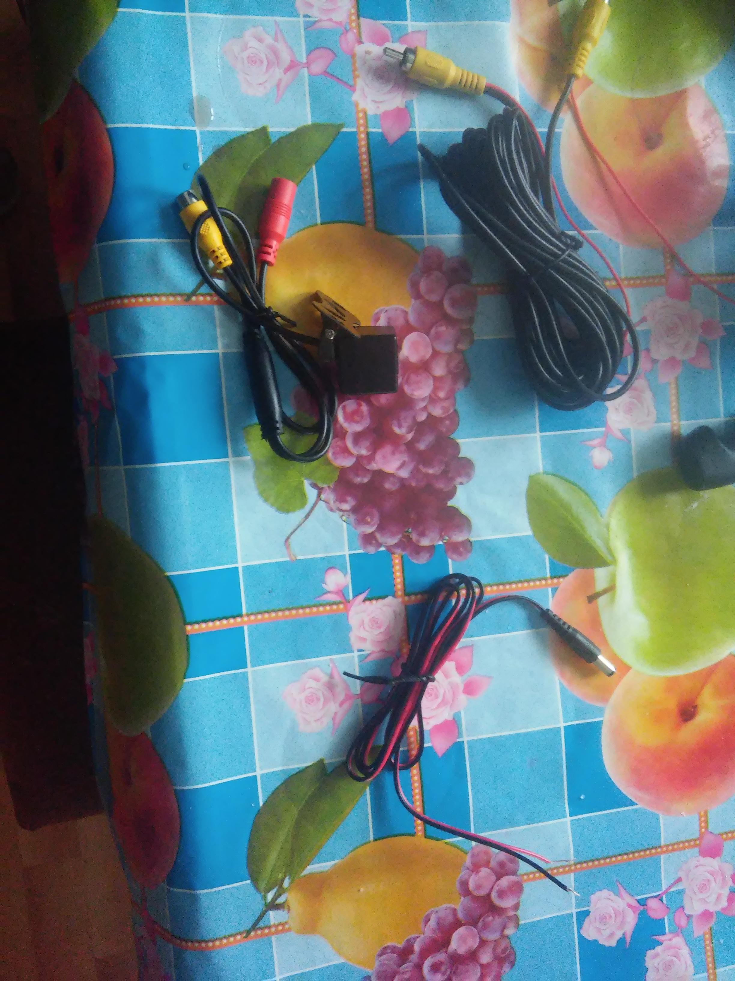

Radio 2 din MP5 7020G - hello I can not come to terms with connecting the camera

    I don't know how to go about it, so I attach some photos of the camera cubes, radio, etc. Please help in advance thank you Radio 2 din MP5 7020G - hello I can not come to terms with connecting the camera20180210_1..922.jpg (418.6 kB)You must be logged in to download this attachment. Radio 2 din MP5 7020G - hello I can not come to terms with connecting the camera20180210_1..649.jpg (641.96 kB)You must be logged in to download this attachment. Radio 2 din MP5 7020G - hello I can not come to terms with connecting the camera20180210_1..742.jpg (712.61 kB)You must be logged in to download this attachment. Radio 2 din MP5 7020G - hello I can not come to terms with connecting the camera20180210_1..922.jpg (418.6 kB)You must be logged in to download this attachment. Radio 2 din MP5 7020G - hello I can not come to terms with connecting the camera20180210_1..116.jpg (2.08 MB)You must be logged in to download this attachment.
    • 20180210_143803.jpg (1.24 MB) You must be logged in to download this attachment.

    #3 17027362
    goraj krzysztof
    Posts: 1329
    Help: 189
    Rate: 131
    You have a camin socket there. What else do you need? You connect them with a chinch cable to the camera, connect power to the camera and it's ready.
    #4 17027940
    mirksmo
    Posts: 12
    - under 17 you connect the camera signal '
    - under 9 you connect + 12v from reverse
    - and power supply for the camera + 12v and - (it should be after the ignition somewhere in the back)
  • #5 17028283
    goraj krzysztof
    Posts: 1329
    Help: 189
    Rate: 131
    Connect the camera power to the reversing lights. So that it turns on when you throw back. Connect the cinch cable between the radio and the camera and let them know if it works. There is a lot of info here: https://www.elektroda.pl/rtvforum/topic2764809.html
