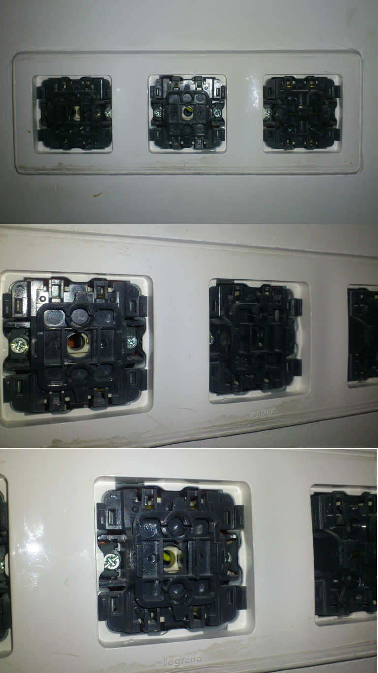

    At one point of extinguishing this wall lamp there is a triple frame and in it there are one single switch (at the end of which there is a meanwell 230v-> 12v converter), another single switch (from this wall lamp) and one more double switch (there are other wall lamps where I checked the bulb LED and works normally in them).
    In the second point, there is also a triple frame with a double switch (I have other light fixtures there in which I checked the LED bulb and it walked normally), single and single (from this wall lamp).

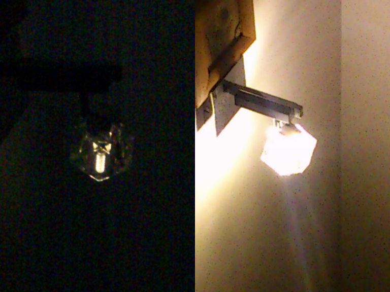

    I took off the covers of the switches in one socket (the other is identical). This is what it looks like inside (there are three in the holder, the middle one is from a flawed wall lamp). I added a photo of what this incandescent looks like and what a normal glow looks like.
    Wall lamp 230V G9 LED – why does it glow with the switch turned off? Wall lamp 230V G9 LED – why does it glow with the switch turned off?
