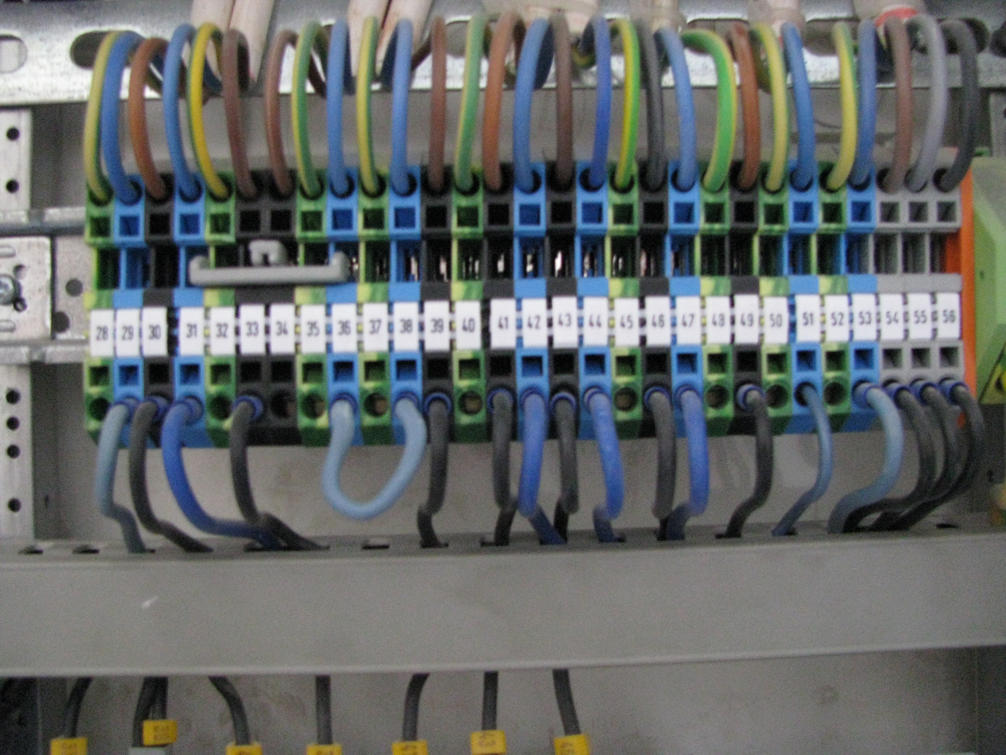

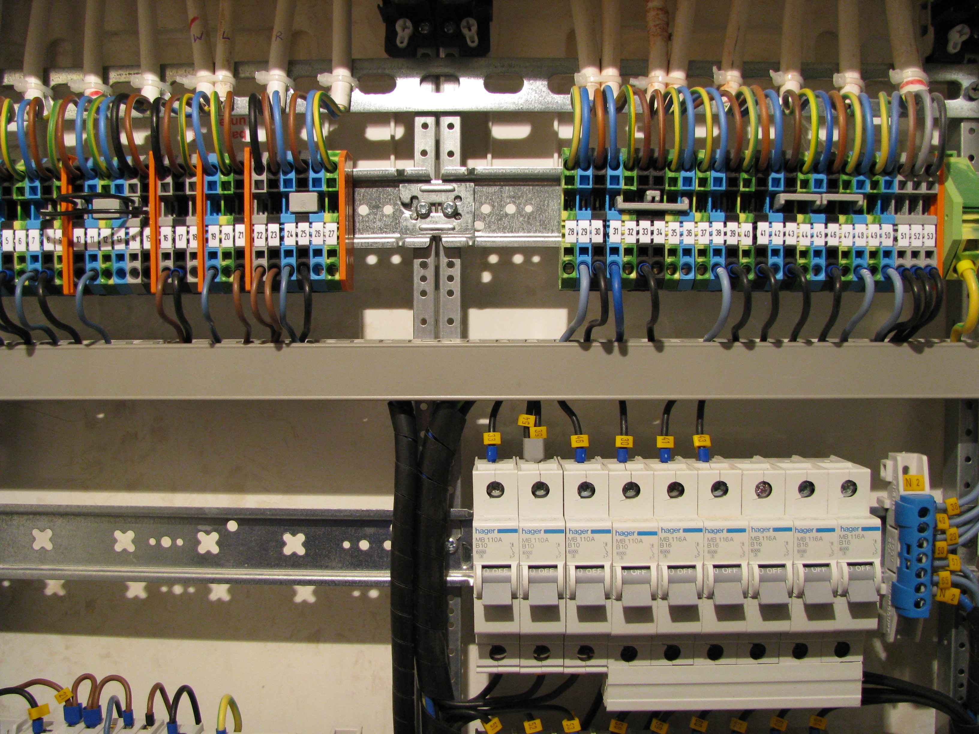

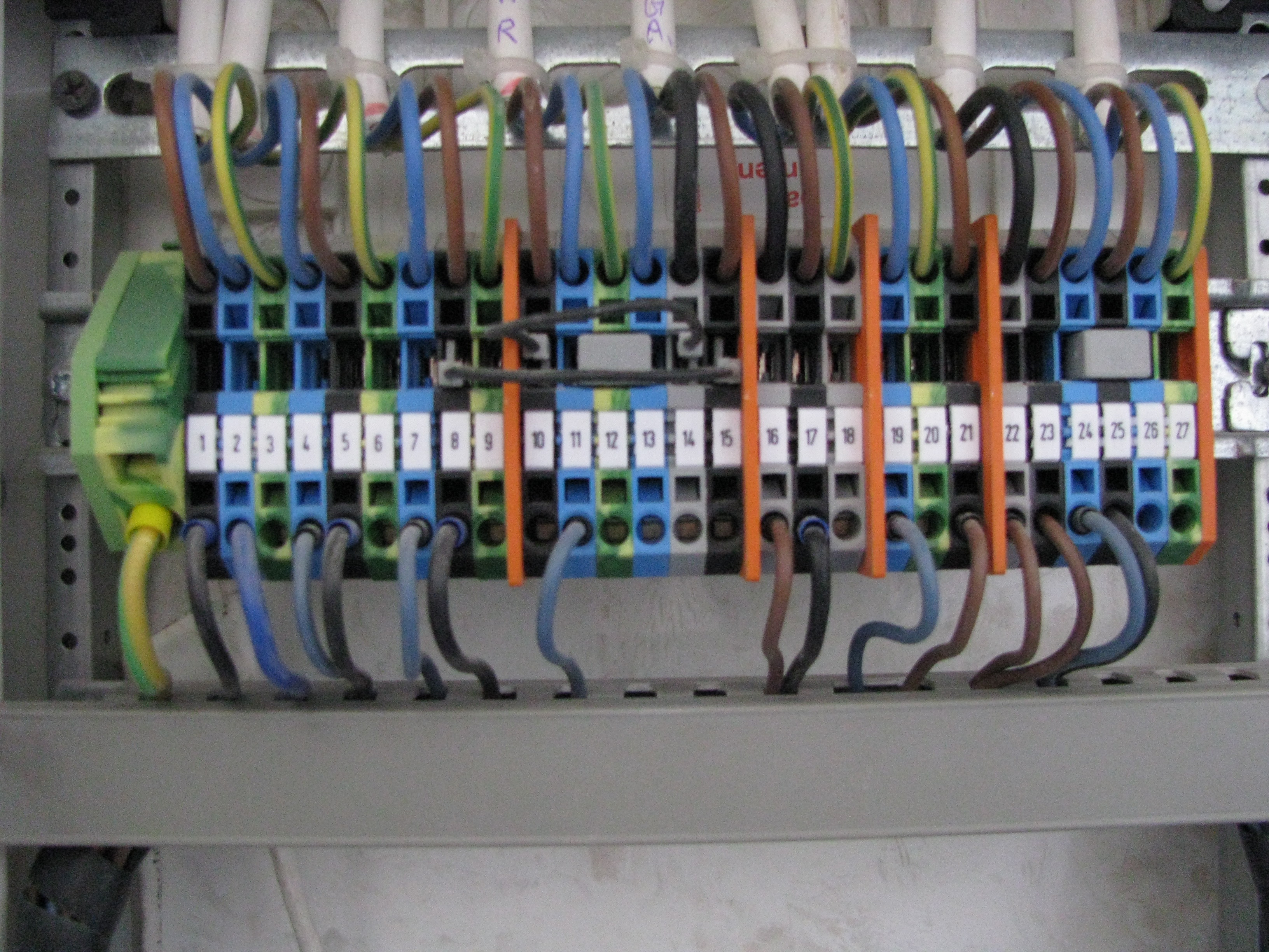

    Surely there will be no shortage if, for example, such badges are used -.
    Should the disconnector in the switchboard also disconnect the N line ? .
  • #12 14573198
    pqma
    Posts: 92
    elpapiotr wrote:
    Certainly there will be no shortage if, for example, such badges are used -
    But lovely, what is it called ? Are there any other patents of this type ??
    I would like to have so much space in the switchboard :(

    I would like to have that much space in the switchboard
    Then you have to use a switchboard with 80 fields, there will be space.
    And then it is done like this :
    Should the disconnector in the switchboard also disconnect the N line ? Should the disconnector in the switchboard also disconnect the N line ?
