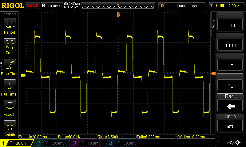

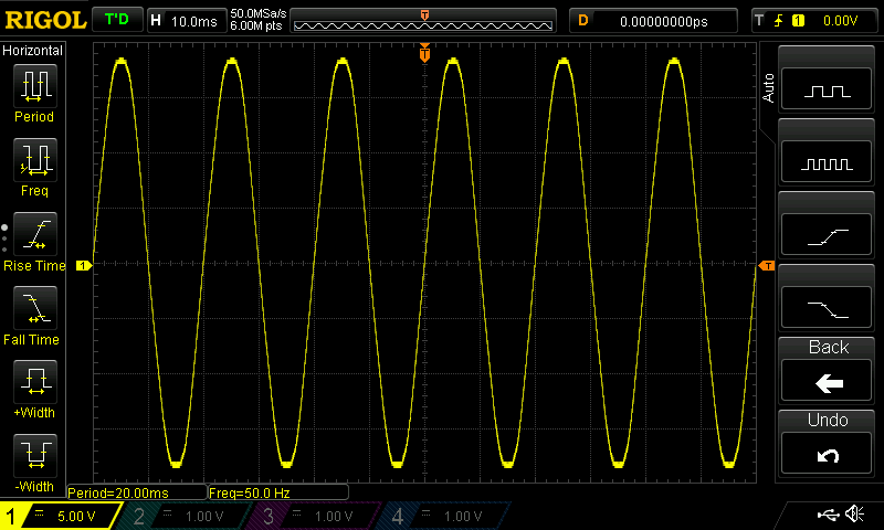

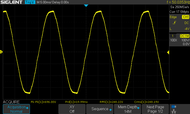

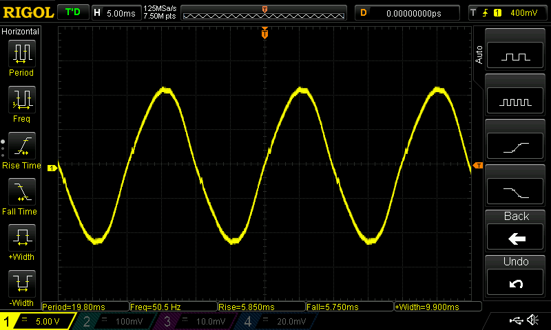

    Sorry for the delay but my estimates of when I will have free time turned out to be grossly wrong, today I went back to checking ups and I have surprising (for me) results. I did a small comparison of a few UPSs that I do not use anymore (I replaced them all with one large 2.5 kilowatt full sine wave operating on a 24V 110Ah battery).
    As a benchmark, look at the current straight from my home network:
    Modified Sine Wave vs Pure Sine Wave: Impact on Computer Switching Power Supplies

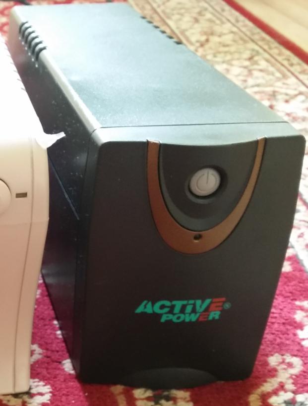

    So I present the waveforms of the tested models (all the ups were loaded with the cable TV modem, the dlink switch and the linksys wifi router - at the same time):
    1. UPS Active Power 600:

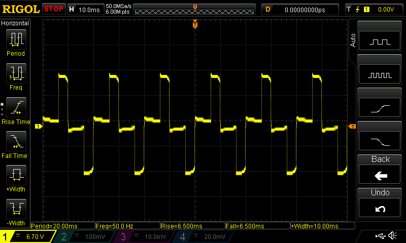

    2. Orvaldi 520PL UPS

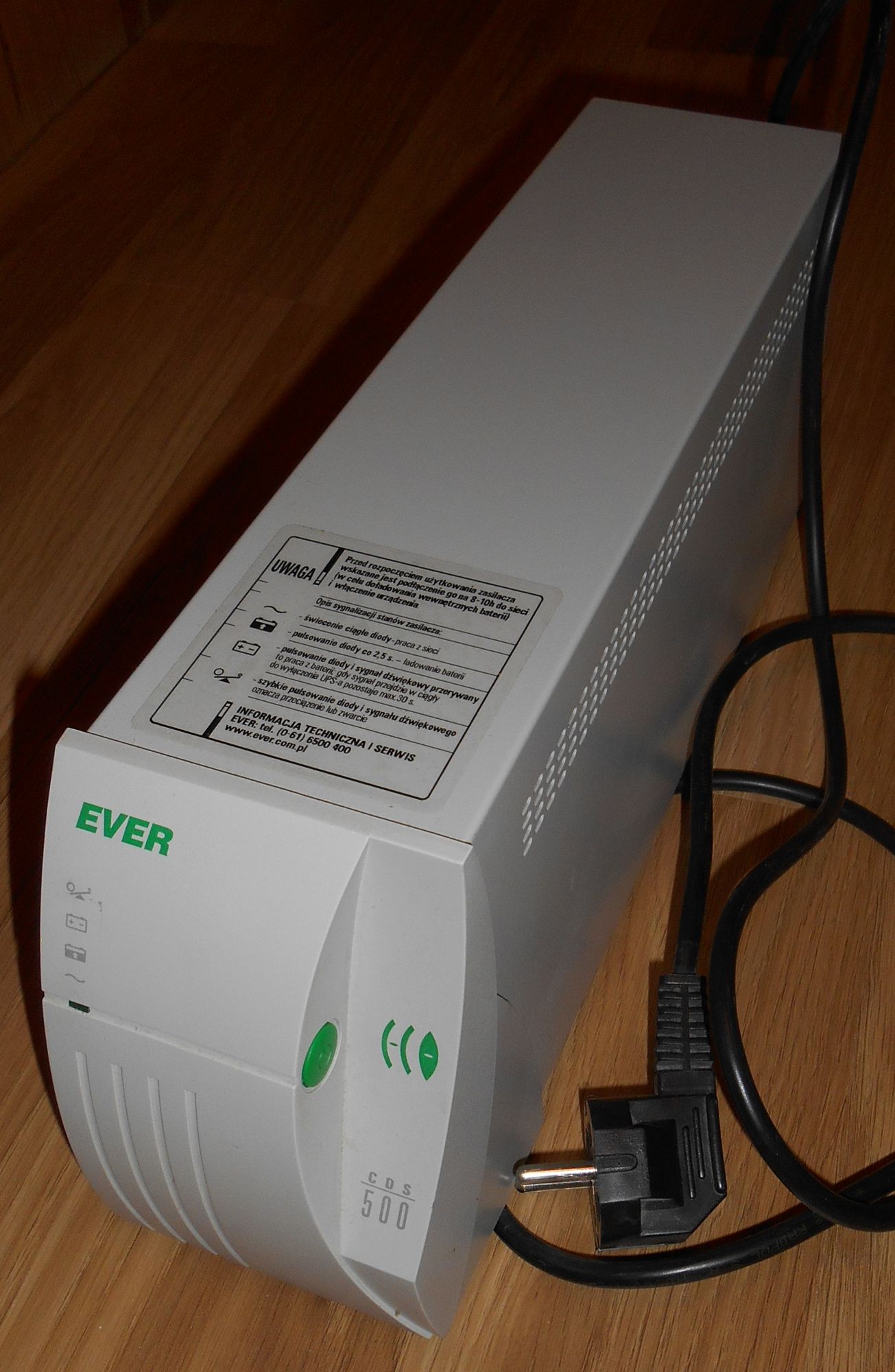

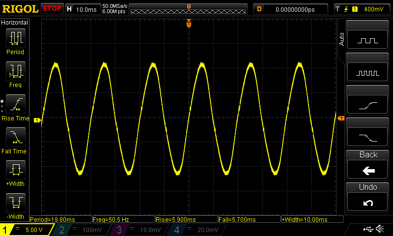

    3. UPS Ever CDS 500
    Modified Sine Wave vs Pure Sine Wave: Impact on Computer Switching Power Supplies Modified Sine Wave vs Pure Sine Wave: Impact on Computer Switching Power Supplies
    I was very surprised how nice the ups run ever looks, almost perfect in such a cheap model, wow.

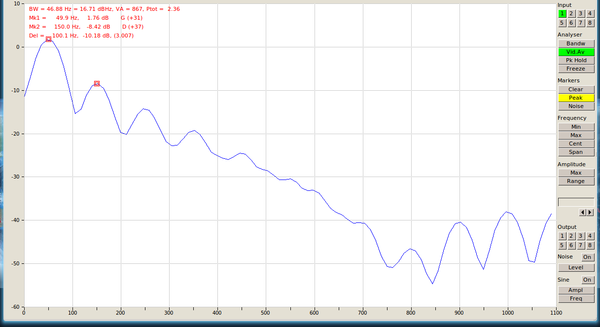

    Friend @akytam raised the issue of the appearance of an oscillogram showing the voltage in the electricity network at my home. I would have classified this waveform as distorted (in the previous video it is almost impossible to see at 200V / div), but I also did not see many such oscillograms to be authoritative. I'd love to hear from you other opinions.
    I recorded more detailed voltage oscillograms at home:

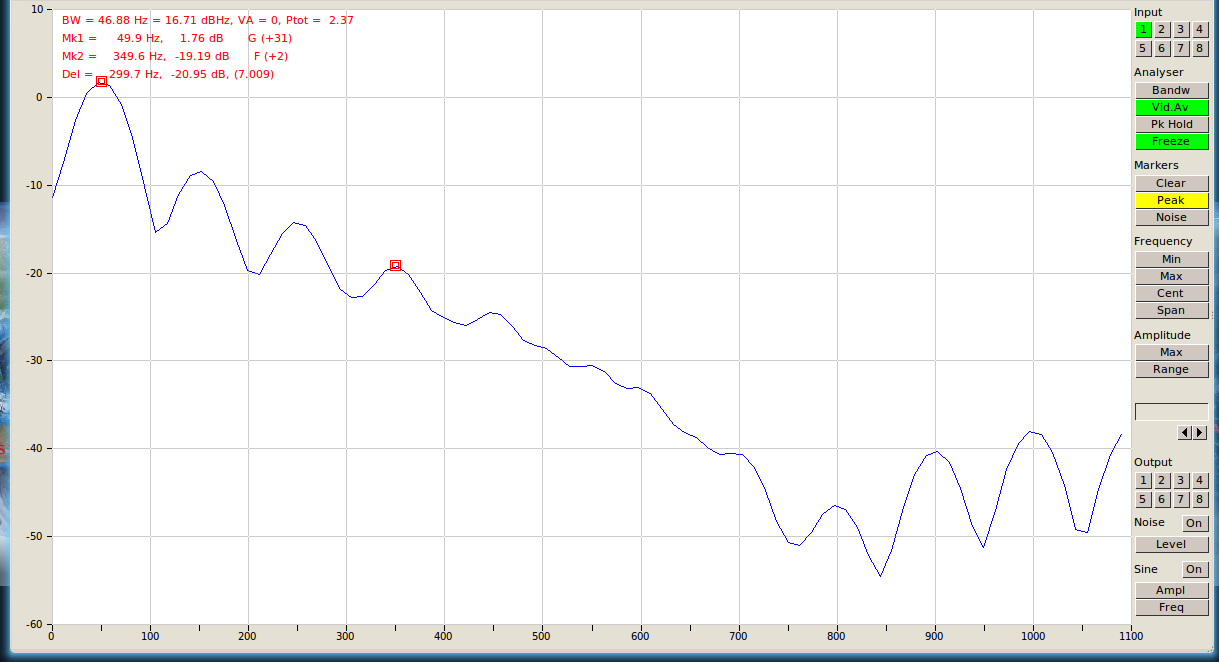

    I don't have a spectrum analyzer, unfortunately .. but using a voltage divider and a sound card, I got the following spectroscopic spectra:
    Modified Sine Wave vs Pure Sine Wave: Impact on Computer Switching Power Supplies Modified Sine Wave vs Pure Sine Wave: Impact on Computer Switching Power Supplies Modified Sine Wave vs Pure Sine Wave: Impact on Computer Switching Power Supplies
    I do not trust these measurements too much, but as a demonstration of what is happening in the mains, they should be enough.
    I wonder if the power generated by the "cheap" UPS has an impact on the operation of the computer, and if so what. Can greater distortions, higher harmonics penetrate the computer power supply and affect the stability of the computer? Maybe they interfere with the operation of the power supply itself and, indirectly, the operation of the computer?

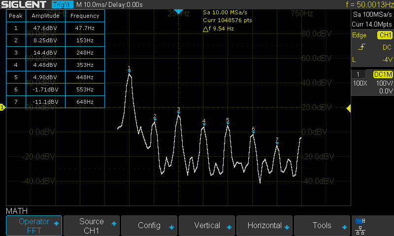

    Out of curiosity, I measured the voltage in my network and it is a little different from the perfect sine wave.
    There are 4 harmonics in the spectrum every 100Hz with a value above 1Vrms
