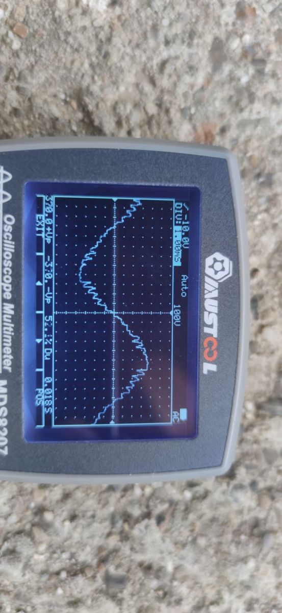

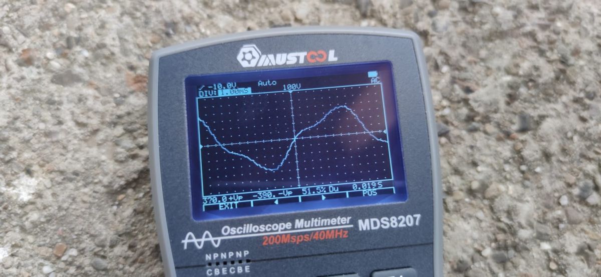

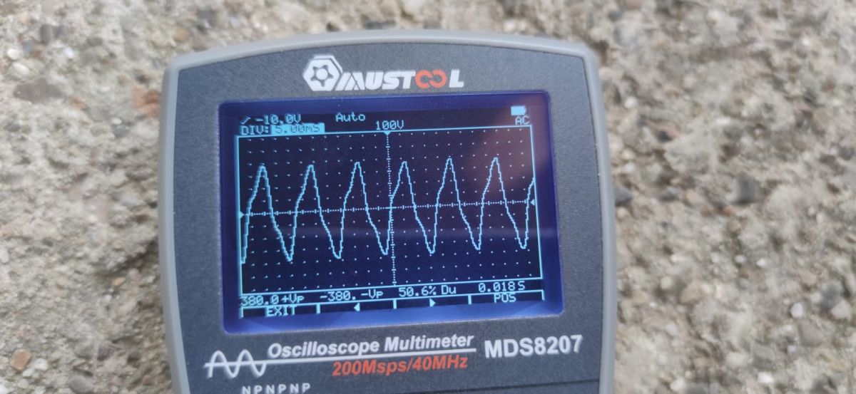

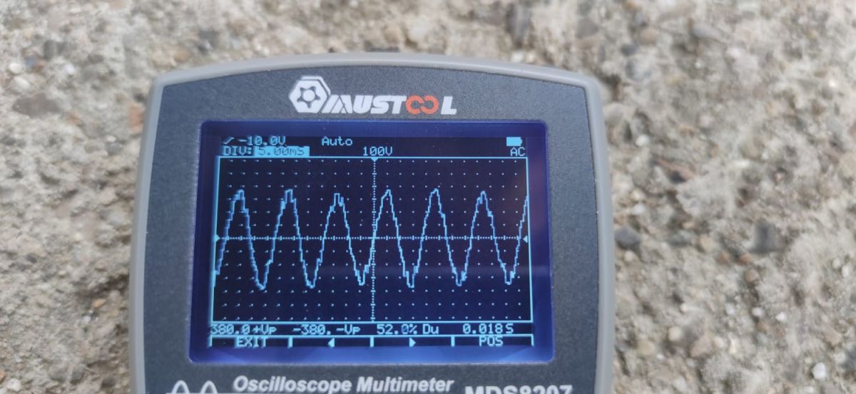

    #11 19904498
    marekmajdak87
    Hello, I changed the pitch to 100V.
    The pictures show graphs without load and with a load of 2000W (radiator). I also have a video, but unfortunately I won't post it here
    Quality of power generators - comparison of oscillograms of popular power genera Quality of power generators - comparison of oscillograms of popular power genera Quality of power generators - comparison of oscillograms of popular power genera Quality of power generators - comparison of oscillograms of popular power genera
  • #12 19904520
    kkknc
    Posts: 23782
    Help: 1916
    Rate: 6720
    It's far from ideal.
  • #13 19904526
    marekmajdak87
    Well, I already know from the beginning. My question is whether it is safe to connect to it something more than simple devices such as a refrigerator or a gas boiler.
  • #14 19904536
    kkknc
    Posts: 23782
    Help: 1916
    Rate: 6720
    If the gas boiler can check the most problems, the engine will run.
