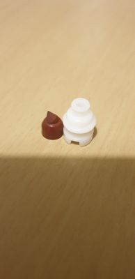

    Hello everyone, disassembling this part, cleaning and blowing it helped me. No mechanical intervention such as a needle. KRUPS EA8298 Cappuccino System: Milk Frothing Issue, Cleaning, Descaling & Service Options

    This white element gets dirty inside. All you need is an ear stick or compressed air.
    Never with a needle!
  • Cleaning and blowing fixed milk frothing issue

  • #39 19329844
    Margorg
    I cleaned the hole in the metal mushroom regularly and suddenly it stopped making foam, I took off the rubber cap, cleaned the metal part from the inside and the cap and it's ok.

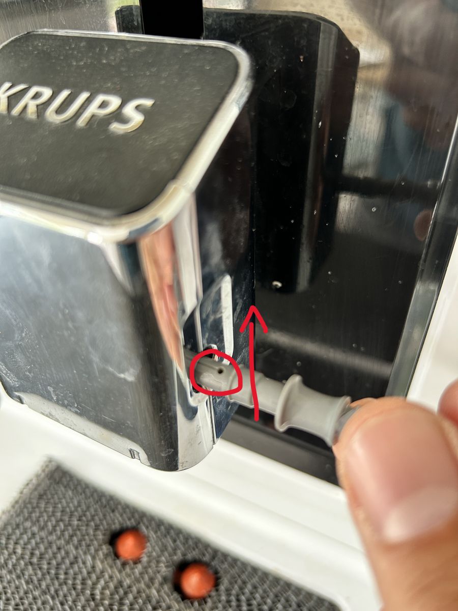

    #43 20632953
    rrrrrene
    OK... I was about to pull my hair out about this issue with my Krups Evidence (YY4860FD) not frothing milk most of the time for several months.
    AND I FOUND THE REAL SOLUTION! It didn't have to do with cleaning at all!
    You just have to make sure that the tiny hole of this one grey plastic piece attached to the tube is inserted correctly :) The tiny hole needs to be pointing upward when you insert it just like shown in the picture here. Only in that position, it is possible to attract air into the channel while frothing the milk. KRUPS EA8298 Cappuccino System: Milk Frothing Issue, Cleaning, Descaling & Service Options
  • #44 21278225
    joannamkstarter
    I agree with the following. You need to clean the mushroom hole (rubber band plus little white plastic). Then it foams beautifully. And I already wanted to throw it away. And how much nerves. Thank you for your help A glass of latte macchiato with thick foam on a wooden table. .
