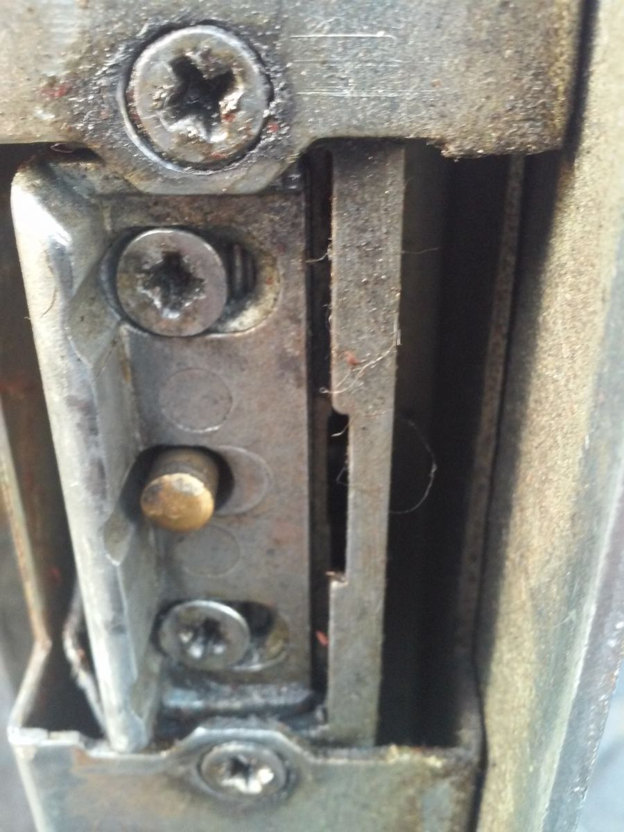

    For some time, the electromagnet in the locker sometimes held the lock, sometimes not, and finally I decided to replace it with a new one. After installation, however, it turns out that the problem still occurs, as if the magnet opening was turned on all the time. Maybe someone has an idea how to fix it?

    y2kbug81 wrote:
    However, it turns out that the problem still occurs as if the magnet opening was turned on all the time.
    Maybe the opening system provides some voltage? You should make sure and check it with a voltmeter. If there is no voltage, it is a purely mechanical issue.

    In my opinion - just a mechanical matter.
    The lock tongue in the gate after closing the gate
    it adheres to the lock catch, which prevents the locking latch from latching.
    Check if there is a gap between the lock tongue and the lock catch after closing the gate.
    The second possibility is internal stresses in the lock, which may occur after tightening the lock to the curve of the base in the post - but this is very unlikely - check if there is "play" between the gate and the catch - after closing.
    (Isn`t this a "memory lock"??? Because it changes things a bit, because after one "opening impulse" such a lock remains "open" for a long time until someone opens the gate and closes it again. This is a function used to operate the gate "one person". This means - I am alone at home and to leave, I can unlock the gate with one impulse. No one has to "let me out" - the gate closes and "holds" itself after I leave. But if you let someone in /let him out, and after he entered/exited, you "accidentally" pressed the button after the gate closed - then it turns out that "the lock doesn`t hold". )

    Yes, it is a memory lock, but it does not hold even when I open and close it 10 times.

    So it looks like it`s a "lack of play" (I`d rather rule out a "manufacturing defect", because the previous lock would have to have the same defect). It`s unlikely. And the "lack of play" could have caused the previous lock to not work properly.
    To rule out a manufacturing defect, instead of closing and opening the gate "ten" times, check the lock without closing the gate. If you pull the "catch" of the lock after pressing the button, and the catch always opens only once, it means that the lock is functional, and if it opens more than once - it means that the lock is defective (or voltage is constantly supplied from the intercom) - more there are no options. Just check it out.

    Thank you all for your help. The case is already solved. It turned out that when the plate holding the catch was tightened too much, it blocked the latch from closing completely. Thanks again for all the replies.

    Just for posterity. I had the same problem - the electric strike did not hold even though there was no voltage. The cause was insufficient movement of the locking element (the catch holding the tongue lock inside). A mechanical and partly electrical problem, because the restriction of movement resulted from a slight expansion of the electromagnet coil, which attracts the internal catch and thus releases the tongue lock. Under normal conditions, this small internal catch is pushed out by a spring after a power failure on the electromagnet. In my case, this element did not have full movement, the coil supported it. I cleaned everything, lubricated and preserved it, slightly sanded the back of the hitch near the axle on which it is mounted - literally 0.5 mm on the edge, polished it, put it back together and it works.
