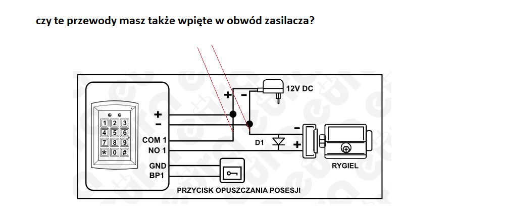

    I bought a code lock to open the gate and the electric door opener, but it does not work as it should, because I powered it with 12vDC power supply, when I activate it with a code or a key ring, there is no voltage on NO1 and NO2 contacts and thus it does not open the electric door opener, on NC1 NC2 contacts also no voltage. Is it possible that the code lock has been faulty since new or have I done something wrong?

    Describe how you connected it.

    2 wires from the electric door strike 1 to NO1 the other to COM1 of the code lock, in addition to the code lock power supply + to + from the power supply and minus to minus from the power supply, that's all.

    sharp wrote:
    How to say it, and not to offend....
    ...There will be no voltage on these outputs.... In any case not directly.
    could you be more specific?
    @U.P. Well, that's exactly how I wired it up

    sharp wrote:
    Of course - see in the instructions what you are missing. Because it is missing.
    aa I have already solved it, thank you, I have one more question, namely can I control the gate without a power supply, I mean only short circuit?

    sharp wrote:
    No.
    Didn't you notice that the striker has to be powered by something? You only have the control contacts.
    So I will have to change the electric striker to one that is powered closed?

    Yes it does, but the one in the combination lock

    Ok, I see, but in that case can I control the riffle from the intercom if the intercom, when pressed, applies power to it?
