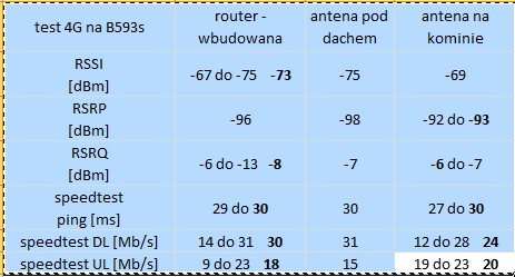

    The performance of the antenna - poor in my opinion. 2-meter thin cable, very delicate handles, brass M5 thread molded into plastic (one I broke). The plastic of both the cable and the antennas is the same as in bad gadgets - a lot of filler, brittle. No fit, not suitable for safe / permanent outdoor installation due to gaps. Connectors are solid and made correctly.
    As part of the tests, I connected it to the Huawei B593s router.
    Measurements in the picture in the attachment. Bold - these are the most common values.
    Router and antenna "under the roof" were placed in an optimal place, ceramic roof, distance from the installation "on the chimney" - about 70 cm. Direct visibility of the BTS antenna - 1.8km 2.8km. The characteristics of the antenna - difficult to determine, but rather not very directional - I turned to different sides and changes difficult to determine - looked quite random :) The tank is the most coarse - the strongest signal is probably when we direct the antenna with the "side suction cup" at the BTS. Measurements taken to a node in my supplier's network. So far, I have not been able to determine whether they work at 800 or 1800 MHz because these frequencies are used by my supplier in Ireland - Three.
    Unfortunately, I did not take the router to the roof - but maybe tomorrow I will try at least a few meters :)
    My conclusions:
    This antenna is lame, slightly inferior to that built into the B593s router. The value of profit is at your fingertips. However, if we can place it outside, we can count on a very slight (say 5dB) improvement of the signal in relation to the signal that the router has inside the house. In my opinion, on the outdoor antenna, both indoors and outdoors, the pings were slightly better (lower) and the RSSI more stable (jumped less) - even indoors. Interestingly, I still have the highest and more stable download speed on the built-in antenna - but on the external one.
    Now I plan to buy and compare one of the Cybertech or Sorensen antennas here - it depends who turns out to be more interesting :)
    Edit:
    I also took measurements of the B593s-22 router placed on the roof of the garage (i.e. the built-in antenna) - the garage is lower than the antenna on the chimney, but has direct visibility to the BTS. The signal is practically identical to that from the antenna mounted on the chimney. RSSI -69dBm, RSRP -92dBm, RSRQ -7dB. Ping usually 30 ms, DL 35 Mb / s UL 22 Mb / s. So the transfers are BETTER than on the external antenna.
    Interestingly, the roof is tin, flat, slightly inclined towards the BTS and if I put the router on a stand about 70-90 cm above it, the signal and transfers drop by a few dB / Mb / s.
    Three ISP support says that this transmitter is down and I have no coverage :) To quote Sexmission: "You have a nice brothel, sisters!"

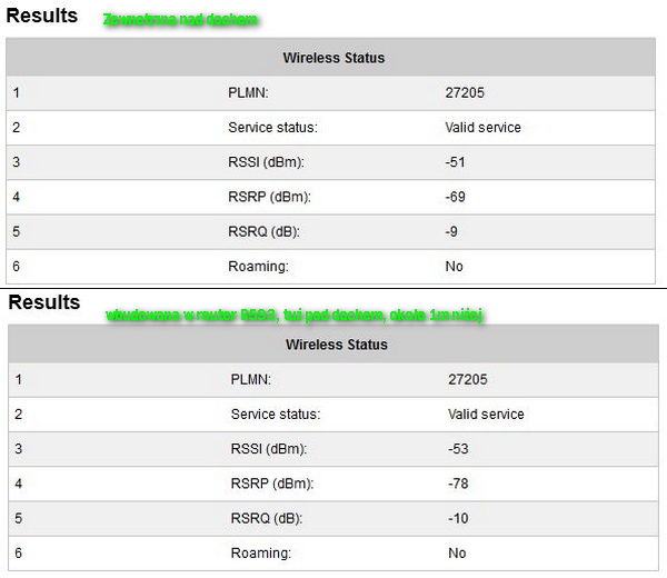

    I have been using it for almost a year and a half, attached to the chimney. It's bad, but it's better to pull the bad one outside the roof than to use the built-in one. Distance 2.8 km, direct visibility of the antennas, no interference - rural area. If the transmitter goes down (which happens sometimes in Ireland where I use it) - it catches the signal from the transmitter ~ 10km, which is not "in its axis" - but shifted by about 45 degrees. Unfortunately, very weak. I would not buy it for long distances, because the characteristics are probably the closest to two eighths. I also traveled with her and the laptop connected to the B593 (the power came from the cigarette lighter socket, I know it was risky) in the car looking for the best transmitter. At the level of the roof above the car it is bad, it does not knock down the signal quality. However, at home, above the roof, it is sufficient for my needs, it is slightly better in terms of transfers than a "bare" router - but the signal is still quite decent. When it comes to the antenna built into the router, in my opinion, the right location of the router gives a lot, a lot - and the difference of even 0.5m is significant, and 2m give a completely different signal.
    And the comparison of signals from a few minutes ago (location as described above):
