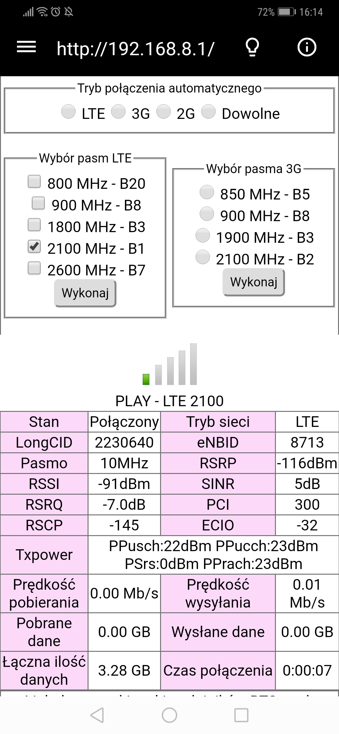

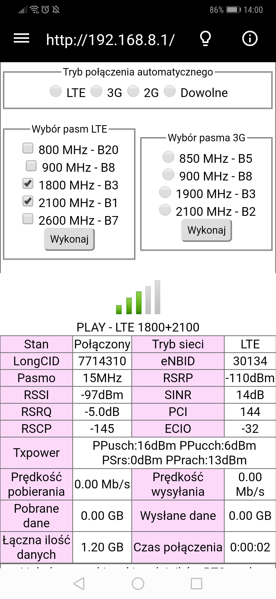

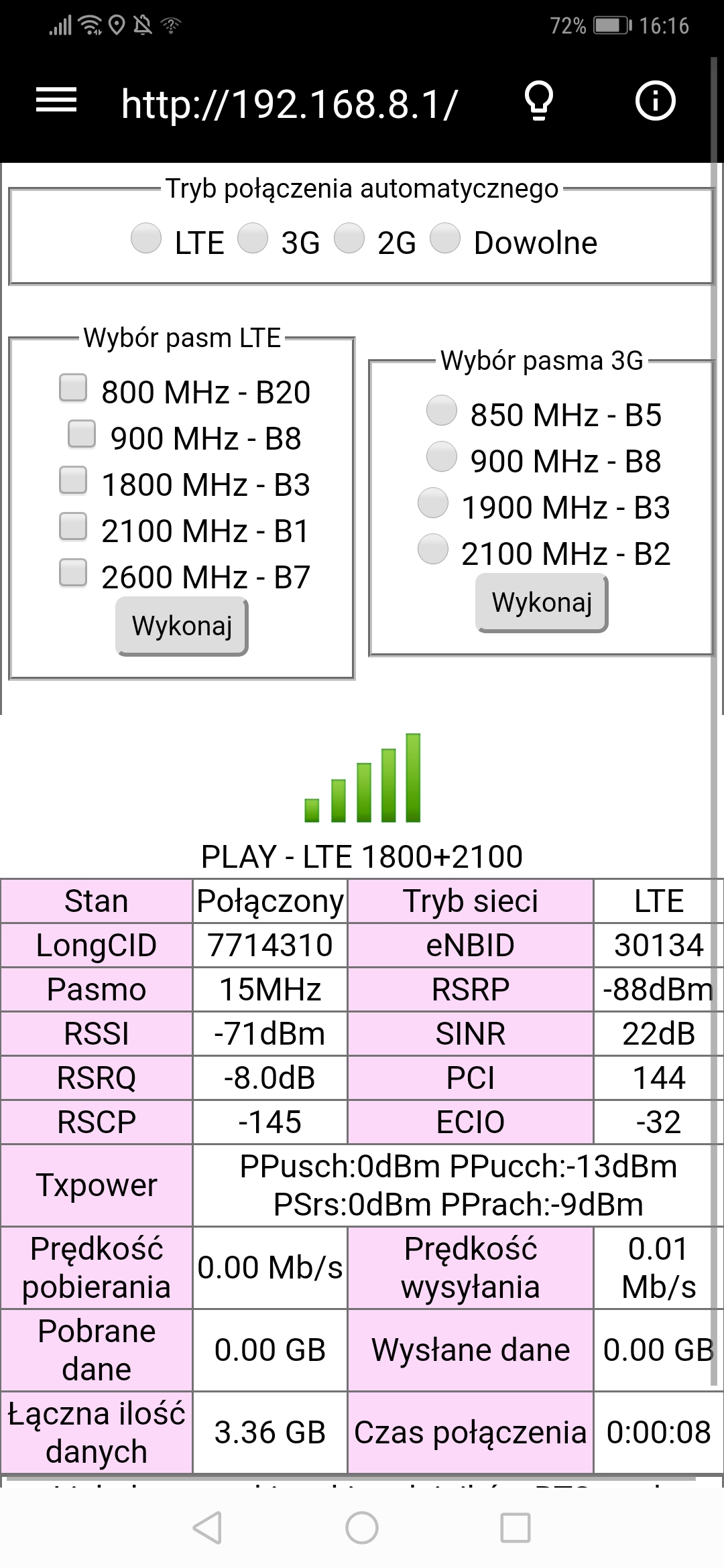

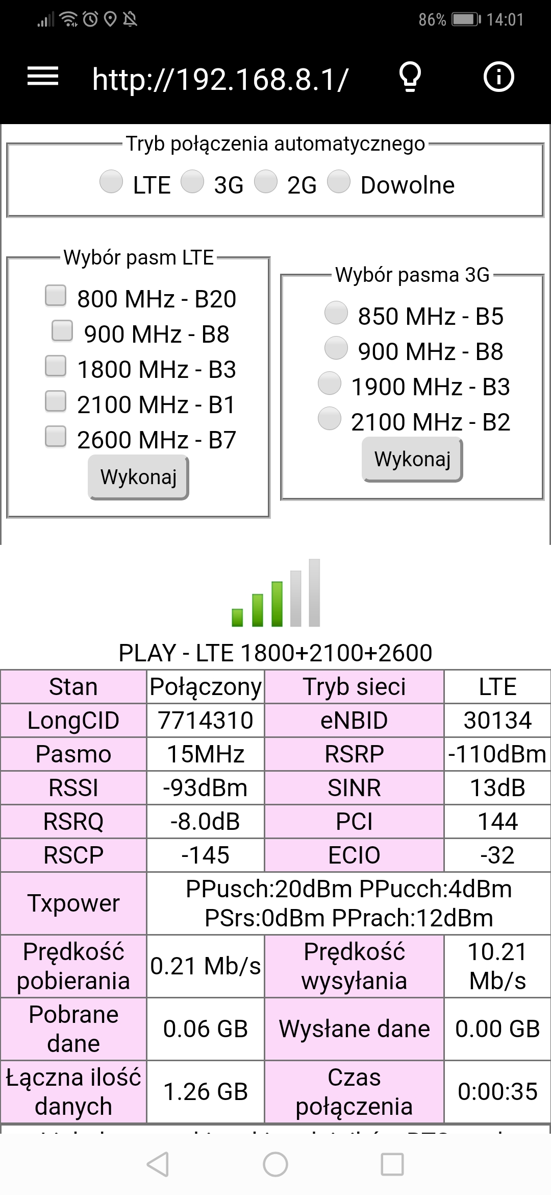

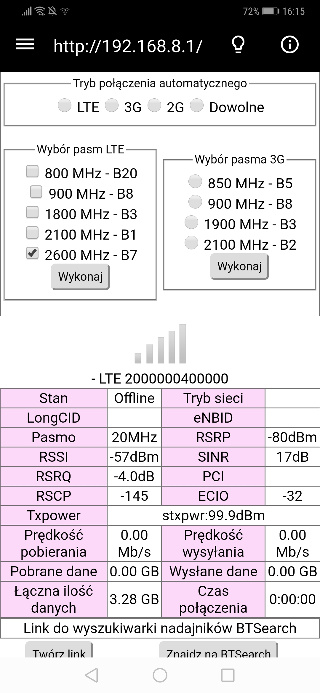

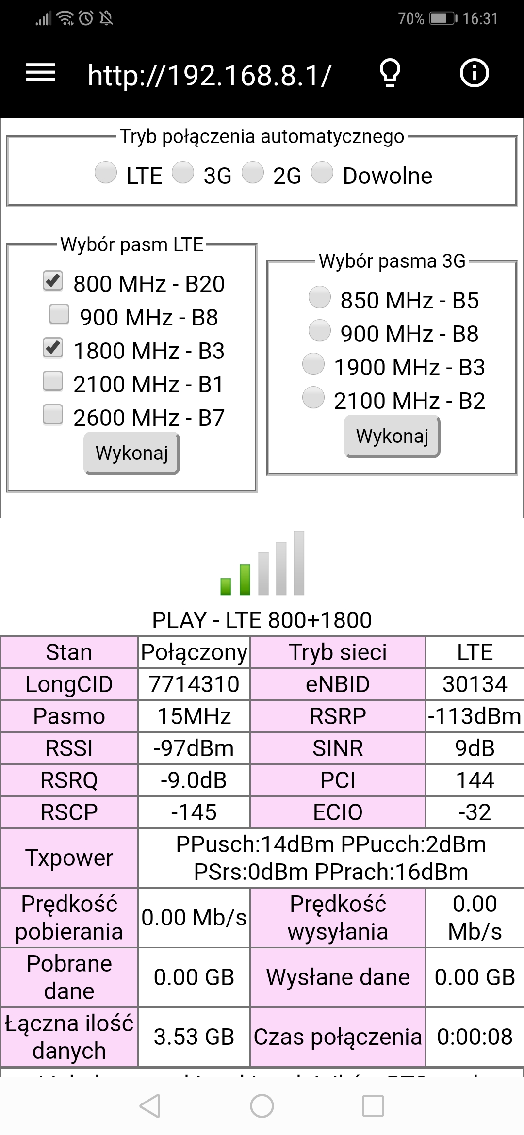

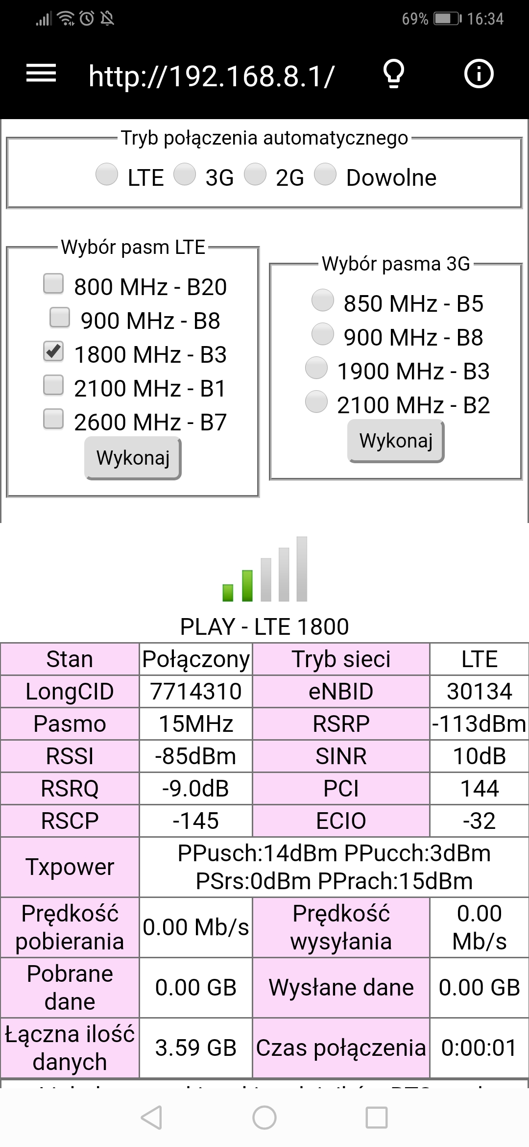

    Hello! I am new to the forum, I need help choosing an antenna for my location I would like to add that I know little about these technical matters, so I need a fairly clear answer what type of antenna and cables, inputs or other accessories I need and in which direction to place it. I have the above-mentioned Huawei B535 (4g router 3 pro) located on the ground floor in the living room by the window.
    Below I am attaching screenshots from HManager.
    300GB play network
    My Location:
    Mędrzechów 250,
    33-221 Mędrzechów
    • Searching for Huawei B535-232 Antenna - Need Help Finding a Compatible Model Screenshot_20191119_140136_com.nasser.huaweimanager.jpg (565.3 KB) You must be logged in to download this attachment.
    • Searching for Huawei B535-232 Antenna - Need Help Finding a Compatible Model Screenshot_20191119_140049_com.nasser.huaweimanager.jpg (558.63 KB) You must be logged in to download this attachment.
    • Searching for Huawei B535-232 Antenna - Need Help Finding a Compatible Model Screenshot_20191119_140203_com.nasser.huaweimanager.jpg (560.2 KB) You must be logged in to download this attachment.

    All the tests shown apply only to the LTE1800 itself, LTE band aggregation does not work on any of the tests, and no wonder, since LTE800 was not added to the LTE1800 in the test. LTE2100 does not work on BTS Play Grady, let alone LTE2600, currently 15MHz bands on LTE1800 and a meager 5MHz band on LTE800, i.e. 2 CC CA B3 + B20 (LTE1800 + 800). Signal RSRP parameters for 1800MHz at this distance are weak, high SINR and RSRQ are not surprising. The station is newly launched so it is unspoiled with few customers. Test on B535 outside, force only LTE1800 and LTE800 bands and then LTE1800 + 800. Show Mmanager screenshots for them and speed tests. Antenna selection depends on how LTE800 works today and whether it contributes to LTE1800 + 800 aggregation.

    So it looks like this:
    (name: download / upload)
    LTE 800: 24.9 / 10.4
    LTE 1800: 30.3 / 8.76
    LTE 800 + 1800: 32.3 / 18.9
    LTE 2100: 43.2 / 18.9
    LTE1800 +2600: 38.5 / 20.1
    LTE 1800 +2100: 28.9 / 22.0
    LTE 800 + 2100: 22.85 / 9.08
    The router outside the window towards BTS Grady
