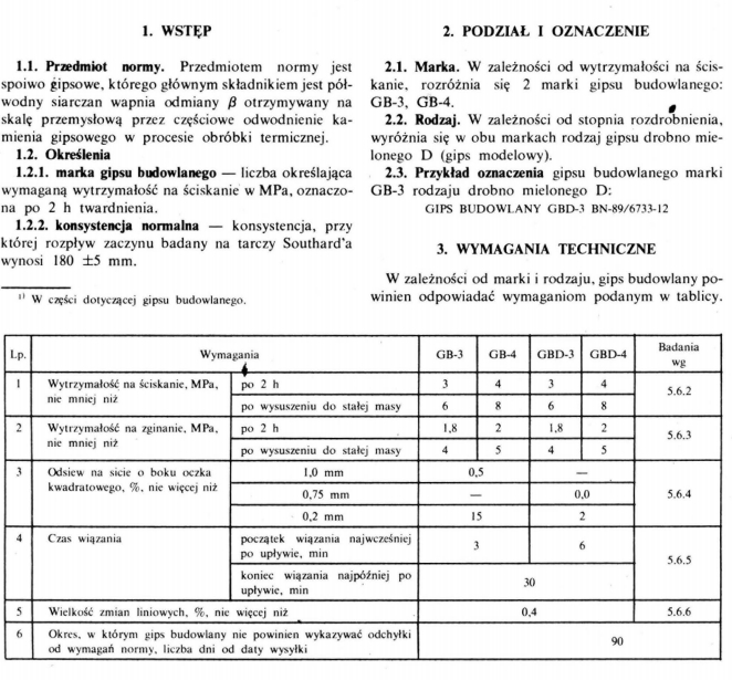

    would I significantly increase the risk of a can tearing out with a stronger one pulling the cable
    I do not advise you to learn this.
    In my opinion, the mixture of construction and putty gypsum does not interfere with anything.
    Anyway, you can search, for example:
    Mixing 2/3 Plaster and 1/3 Gypsum for Cans: Strength and Adhesion Queries
    and compare with the properties of putty, according to PN-B-30042: 1997.
