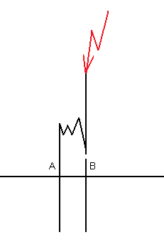

Should the PE conductor from the main earthing bus be connected to the ring earth electrode outside the building at the nearest test joint, or brought into the building and connected to the GSW?
Bring the ring earth electrode/tape to the GSW and connect the PE there; if you have a choice, connect the earth electrode directly in the ground rather than at the test/control joint [#14738659][#14741662] The standard cited in the thread allows a Type B arrangement as either a ring earth electrode outside the building in contact with the ground for at least 80% of its length, or a foundation earth electrode [#14740955] The PE conductor from the GSW should then go to the switchgear’s PE rail [#14738659][#14740039] Several replies also stress that the installation should be done according to the project and that both the ring earth electrode and any foundation earth electrode should be bonded at the GSW, or optionally in the ground [#14739113][#14746105]

    It is me who, in addition to the above post, will illustrate what the excavated ring looks like after about eight years:
    Connection of the PE conductor from the GSW with the ring earthing tape Connection of the PE conductor from the GSW with the ring earthing tape Connection of the PE conductor from the GSW with the ring earthing tape
    In this photo you can see a 4mm tape cut with a normal spade while digging:
    Today's quality of zinc is not comparable to that of several decades ago.
