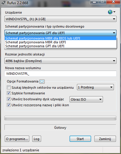

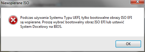

    I ripped the Windows 7 CD to an ISO image. System version to be installed - all versions of X86 and X64. From the rufus program, I select the GPT to UEFI patrition system and the previously created Windows image.
    Unfortunately, I get the message:

    Something wrong with the system image, it must be 64 bit.

    The board does not boot from UEFI - only LEGACY.
    There is such a thing in RUFUS.
    RUFUS - Issues Creating a GPT to UEFI Partition for Windows 7 Using ISO Image
    GPT must be selected for UEFI otherwise I will not install the system on a GPT disk.
    As for the installation, it's not important for now because I need to have something to install the system from.

    I looked at these guides and I see that the problem is not the preparation of the flash drive itself, because the computer boots from it, and the disc image that after such a boot does not want to work. This message pops up:

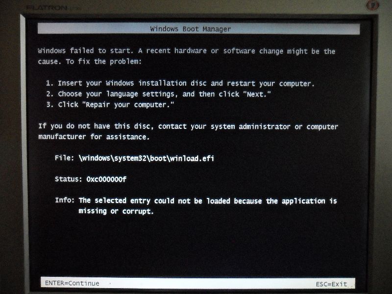

    It doesn't work the same from a CD as it does from a flash drive. It boots up but I get an error.
    It takes a bit of fiddling to boot from UEFI.
    there is a link in the #10 post and I did it, but it does nothing because the error is shown - #11 post.

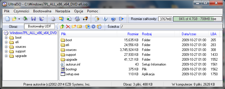

  • 32-bit Windows 7 ISOs are unsupported by the guide
    #17 14838231
    Heinzek
    Posts: 3732
    Help: 554
    Rate: 494
    In the guide you have:
    Requirements:
    At least a 4GB USB flash drive
    64-bit Windows 7 ISO or DVD (If you want to install Windows 7)
    64-bit Windows 8 ISO or DVD (If you want to install Windows 8)
    64-bit Windows 8.1 ISO or DVD (If you want to install Windows 8.1)
    32-bit is not supported.
    Look for the 64 bit version.

    In the meantime, I checked from windows to DVD. Boots normally and with UEFI.
    Now it's copying to the flash drive. If I can install it, I will go back to trying with windows 7.
    I was restoring the bios settings with a jumper because something was broken there (e.g. the mouse did not work and it is not known why the settings were not always saved).
    Edit
    I don't understand why windows 7 with UEFI can't boot. I've tried several versions and each one is the same :(
    EDIT
    Now I know what is the reason for this message. There is simply no WINLOAD.EFI file. This file must be in the BOOT.WIM archive.
    I finally found such an archive and the installation from the flash drive started.
