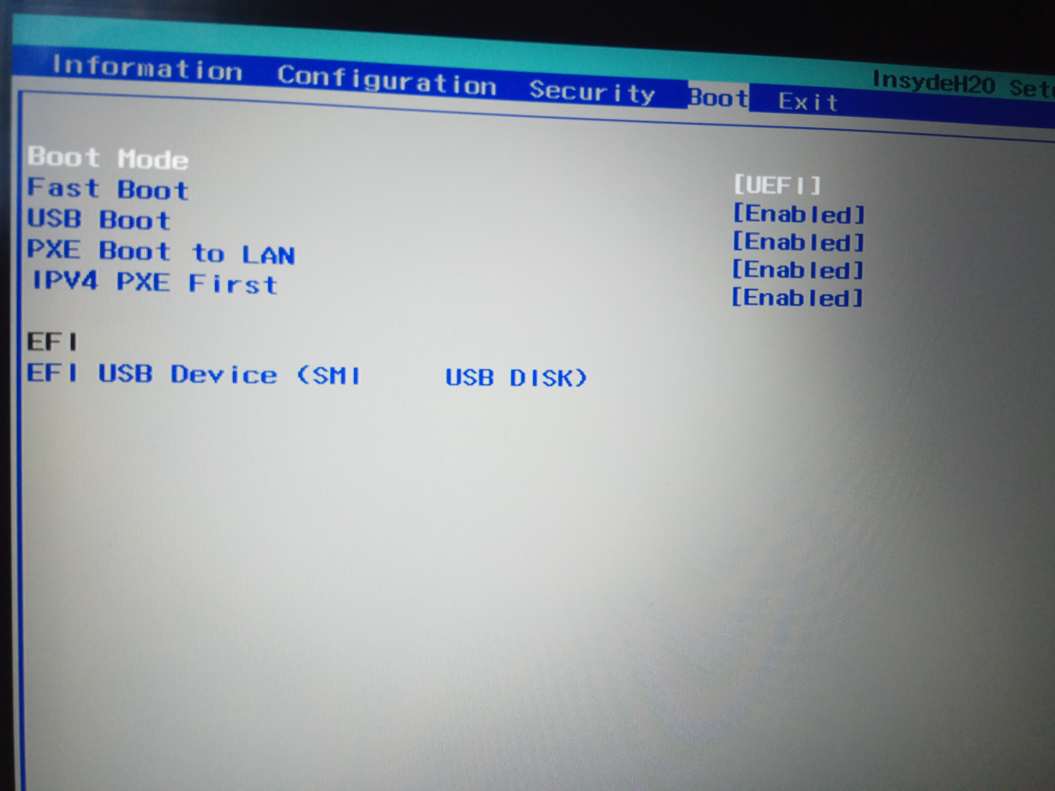

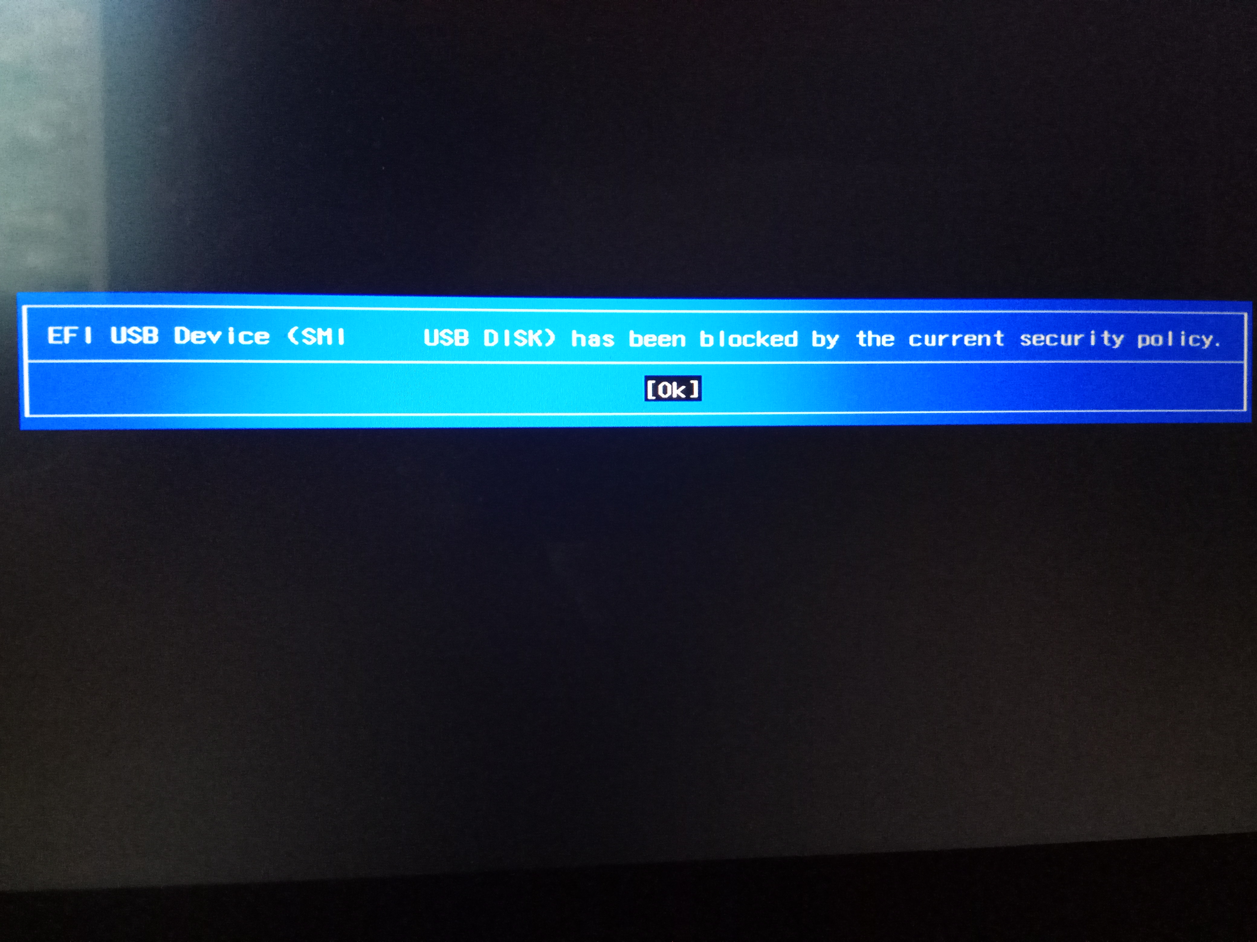

  • #11 16508956
    MrZiolo116
    Posts: 43
    After the change, something like that appeared to me Installing Windows on Lenovo Y700-15 Using a Pendrive: Step-by-Step Guidance Required
  • #12 16508961
    mikomaaz
    Posts: 242
    Help: 18
    Rate: 33
    Disable the Secure Boot option. It should be in the Boot tab.
  • #13 16508969
    MrZiolo116
    Posts: 43
    I do not have anything like that Installing Windows on Lenovo Y700-15 Using a Pendrive: Step-by-Step Guidance Required
  • #14 16508972
    mikomaaz
    Posts: 242
    Help: 18
    Rate: 33
    There may be a similar option in the security tab.
  • #15 16511158
    MrZiolo116
    Posts: 43
    I was able to install the system, thank you very much for your help :)
