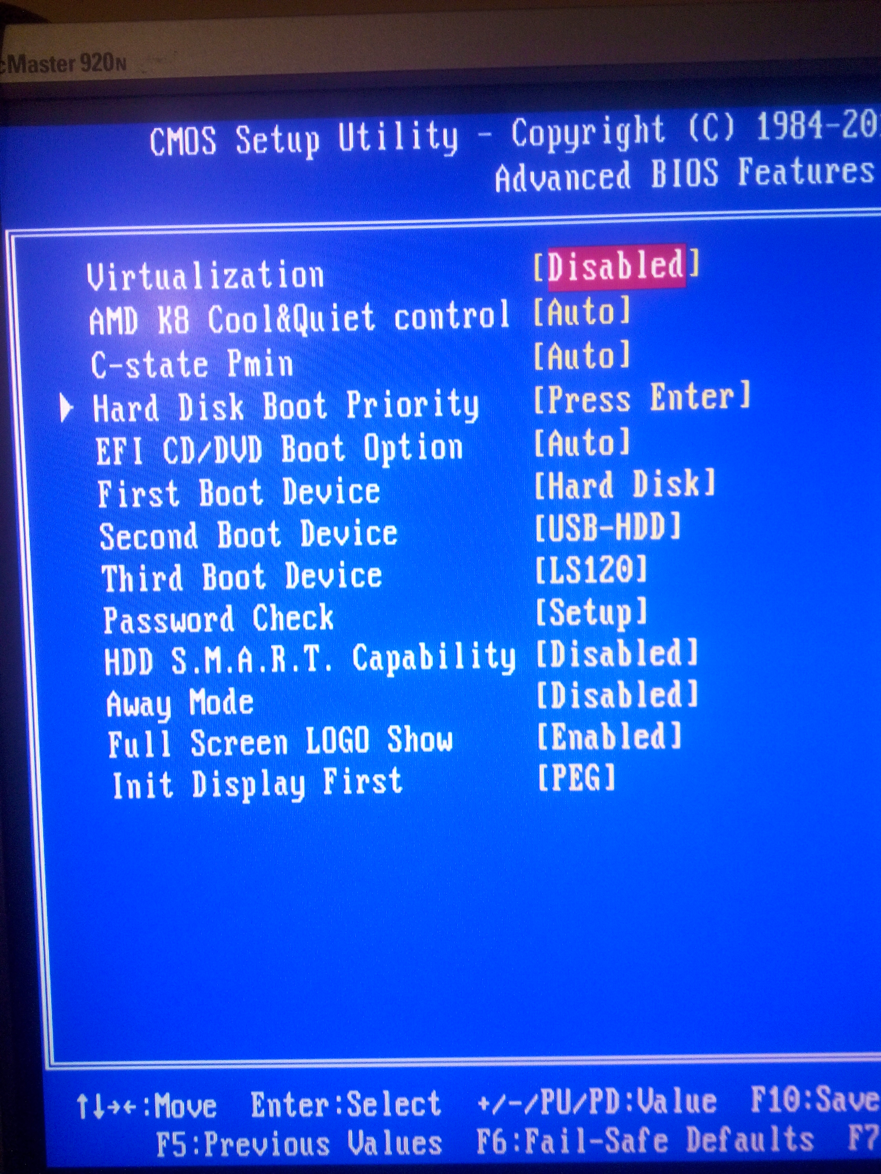

    Hello, I have a problem with the computer, and after using the programs and turning them off, I cannot run another one. I decided to reinstall the wines 7.
    I have win7 in the .iso image
    I made a bootable flash drive with rufus
    And here the next problem begins, because by changing the first boot devices in bios, I set this USB and then my drive with the current win.
    But it still runs win from disk, not the installer from pendrive.
    I will add some information
    8gb flash drive
    Gigabyte motherboard - GA-A75M-D2H
    Maybe some of you know the answer what to do to run the installer from this usb?

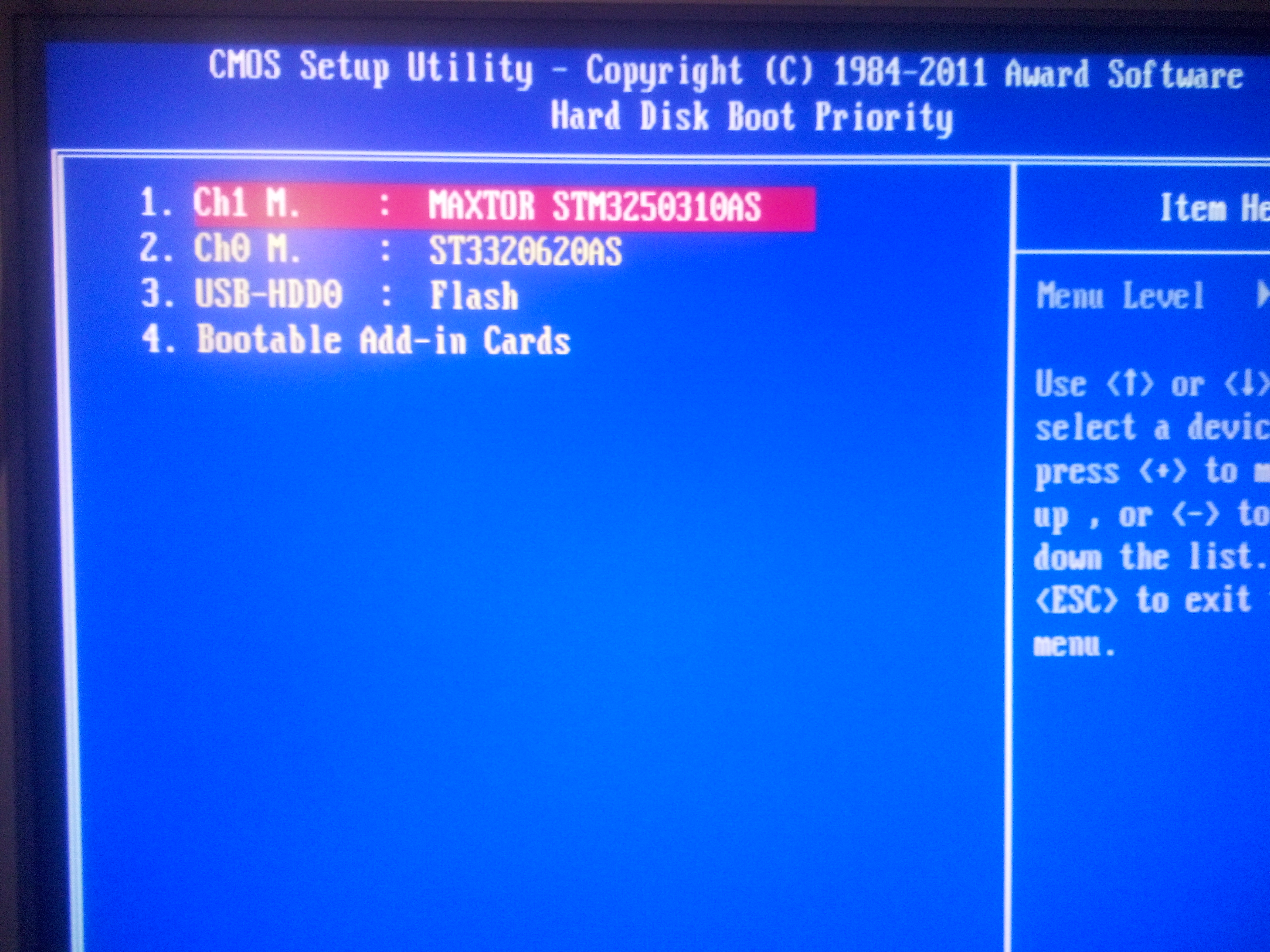

  • #3 16240111
    Vethix
    Posts: 73

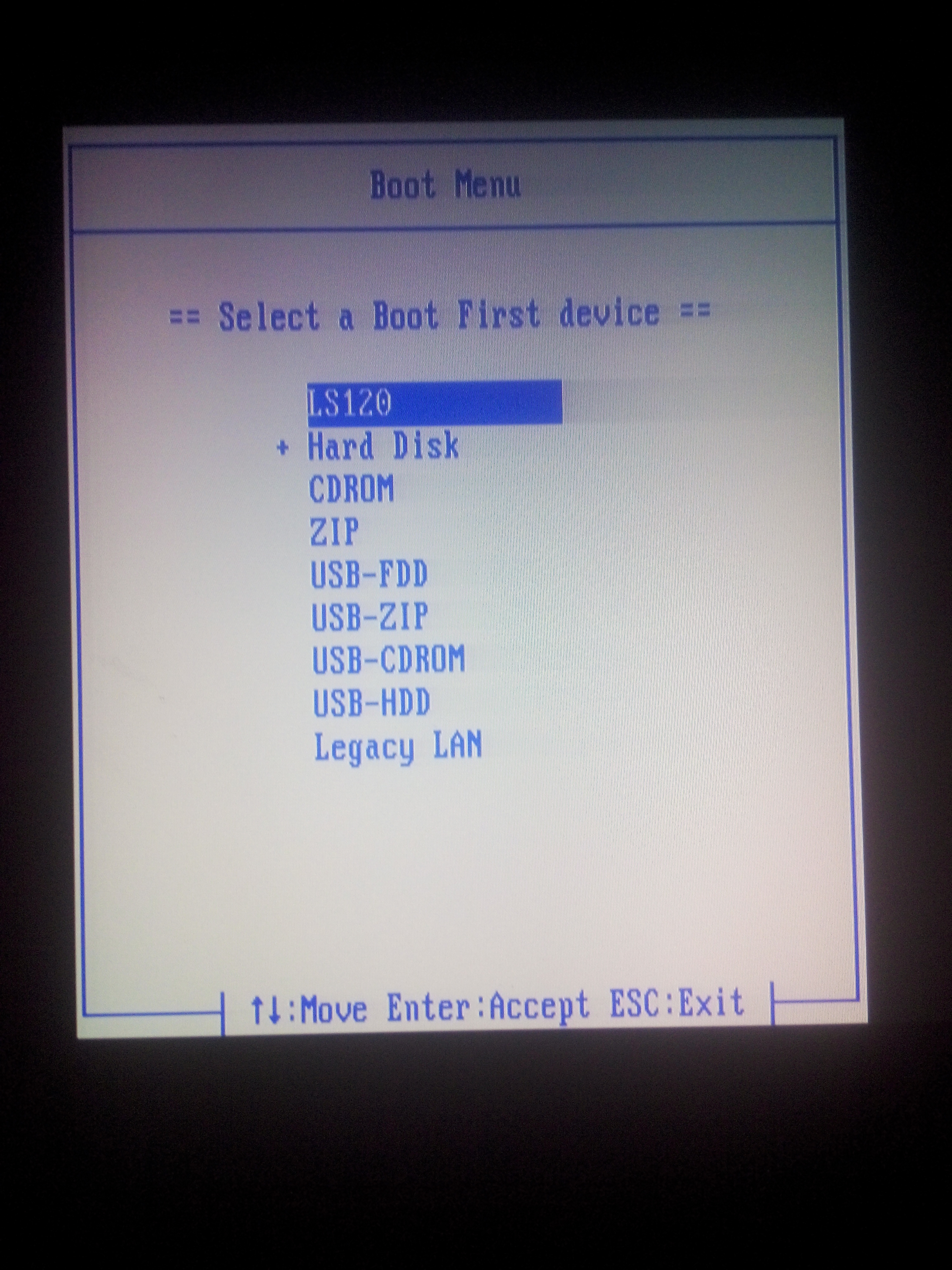

    I did everything but it doesn't work :(
    I will upload a photo from bios and boot menu
    • Bios Boot Menu: Boot from Pendrive with Win7 ISO using Rufus on Gigabyte GA-A75M-D2H Motherboard IMG_20170130_175732.jpg (5.47 MB) You must be logged in to download this attachment.
    • Bios Boot Menu: Boot from Pendrive with Win7 ISO using Rufus on Gigabyte GA-A75M-D2H Motherboard IMG_20170130_175801.jpg (3.32 MB) You must be logged in to download this attachment.
    • Bios Boot Menu: Boot from Pendrive with Win7 ISO using Rufus on Gigabyte GA-A75M-D2H Motherboard IMG_20170130_175715.jpg (3.94 MB) You must be logged in to download this attachment.

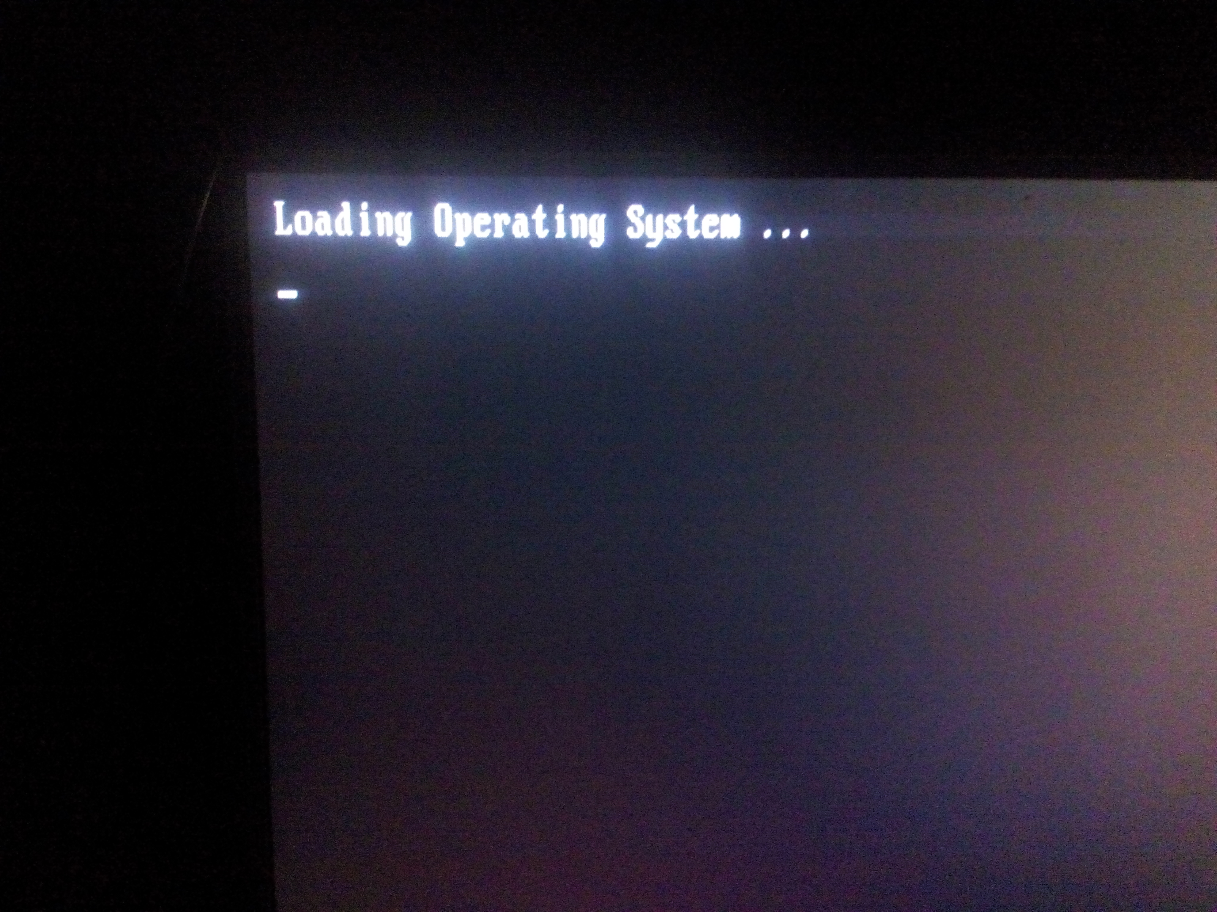

  • #7 16240228
    Vethix
    Posts: 73
    I disconnected the disks, it appears:
    I don't need to save anything from both disks
    • Bios Boot Menu: Boot from Pendrive with Win7 ISO using Rufus on Gigabyte GA-A75M-D2H Motherboard IMG_20170130_181424.jpg (3.08 MB) You must be logged in to download this attachment.

    You still have a badly configured BIOS.
    You did not read everything from the link of post no. 2 or you have not made all the changes to the BIOS.
    It's best to show all possible BIOS tabs (screenshots), maybe we'll see the gaps on them.

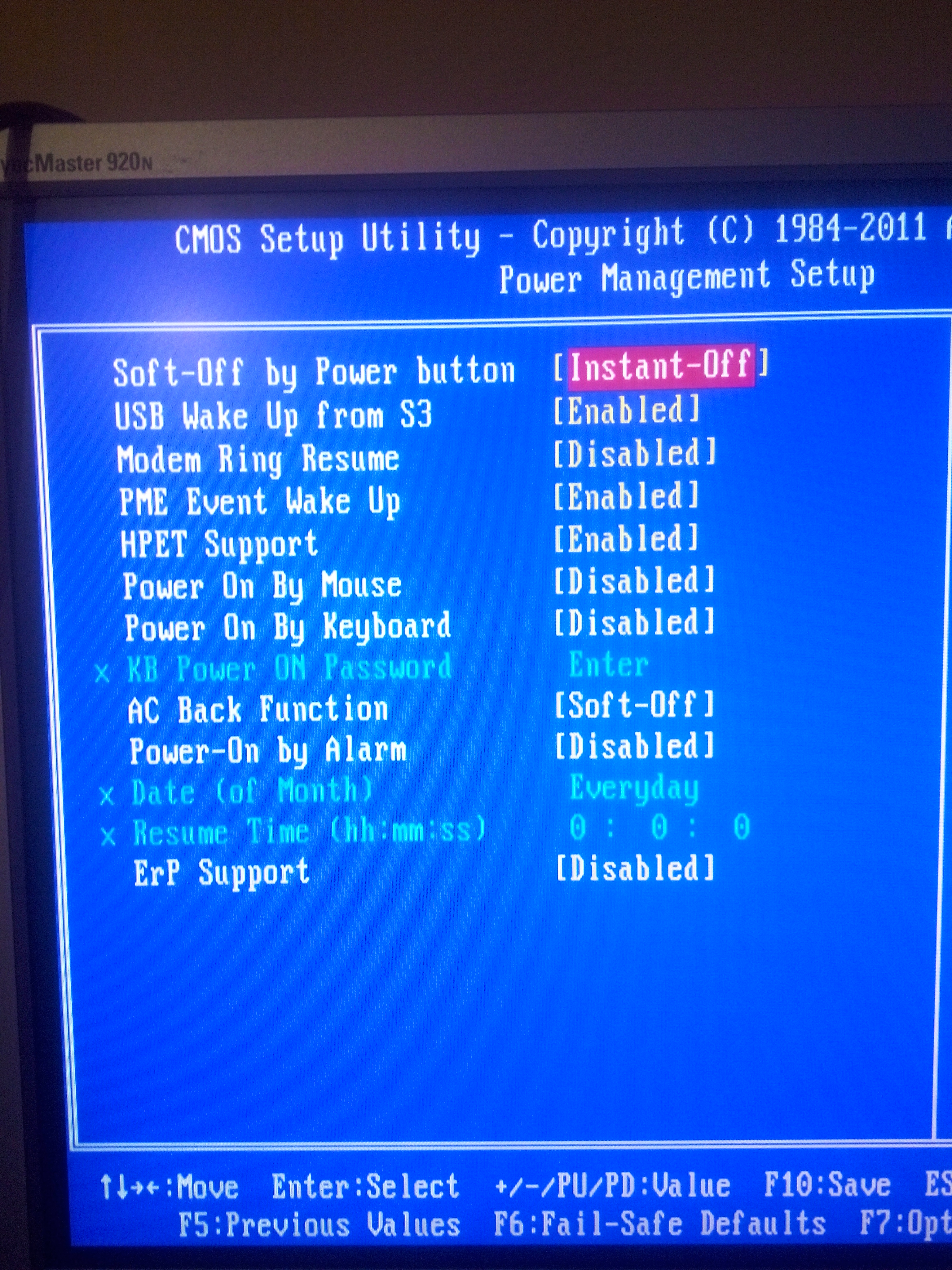

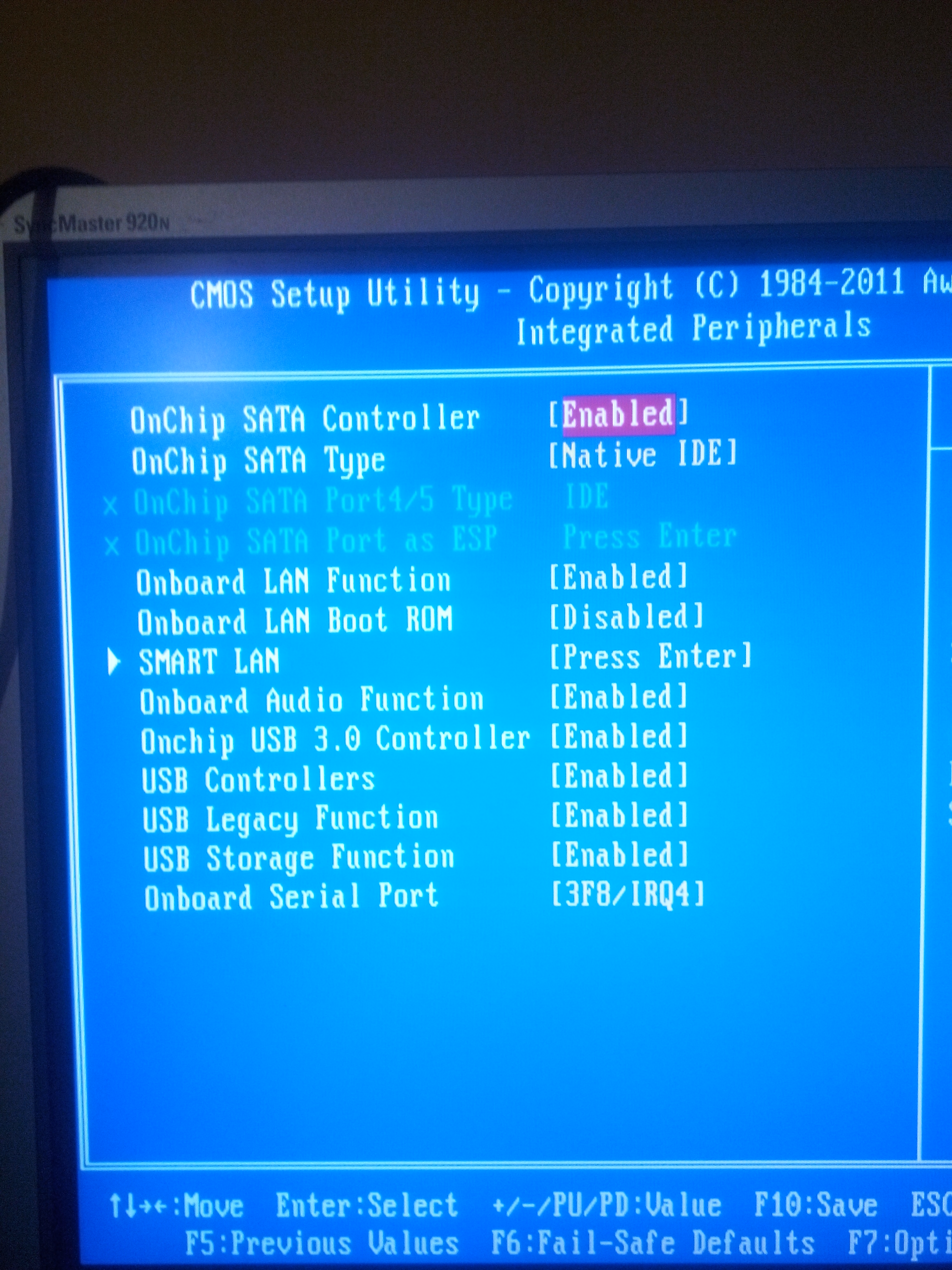

  • #9 16240325
    Vethix
    Posts: 73
    All options are set as at the beginning (before changes)
    Those with changes are a few posts above :)

    OK - it's not even a UEFI bios.
    Connect the flash drive to USB 2.0 (not 3.0).
    Check without disks if it boots. If not, it was badly prepared.
    What other computer do you have to prepare the flash drive (PC, laptop, what operating system on it)?
  • #11 16240374
    Vethix
    Posts: 73
    After disconnecting the disks, you only see this inscription
    "Loading operating system" (comes on usb 2.0 port)
    And nothing else happens :)
    It is possible that it is badly prepared, I do it 1 time, but all of the instructions from the link from the 2nd post, the rufus program
    I want to install win 7 HP

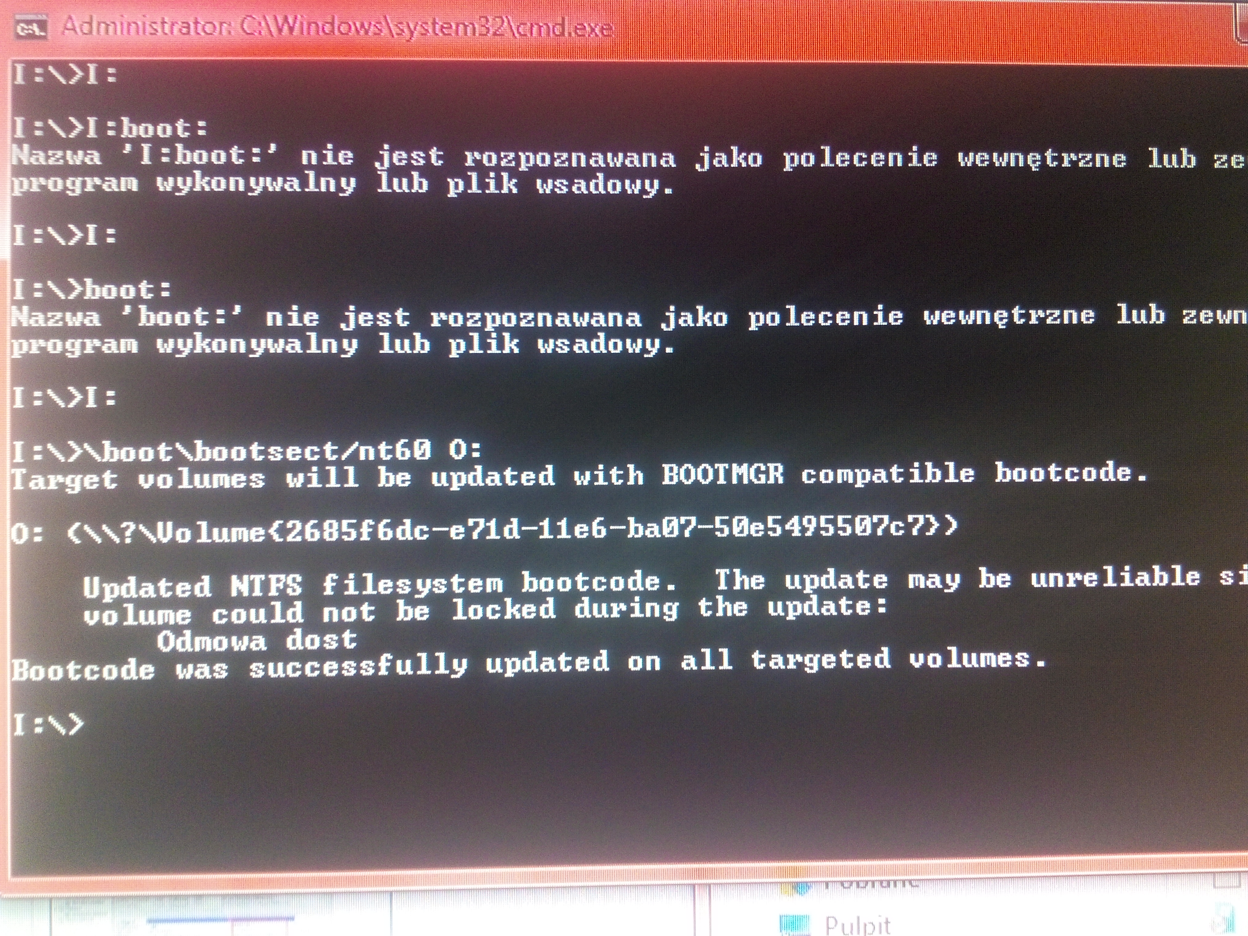

  • #19 16240501
    DriverMSG
    Posts: 44094
    Help: 3984
    Rate: 4883
    Not.
    In the CMS console, enter the letter of the DVD on which you have the Windows installation files, specifically the boot folder with the bootsect.exe file, for example:
    e: ENTER
    cd boot ENTER
  • #20 16240566

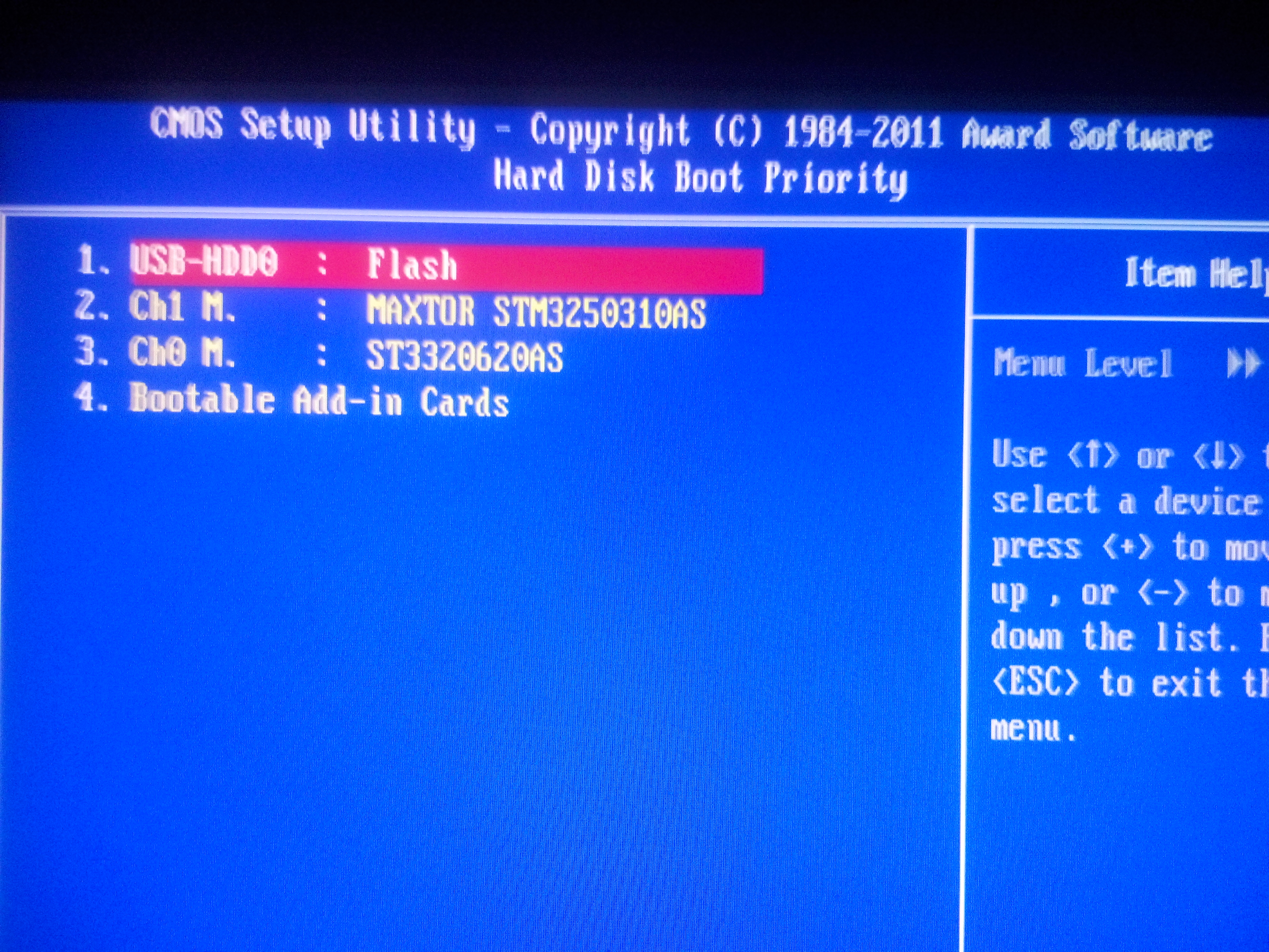

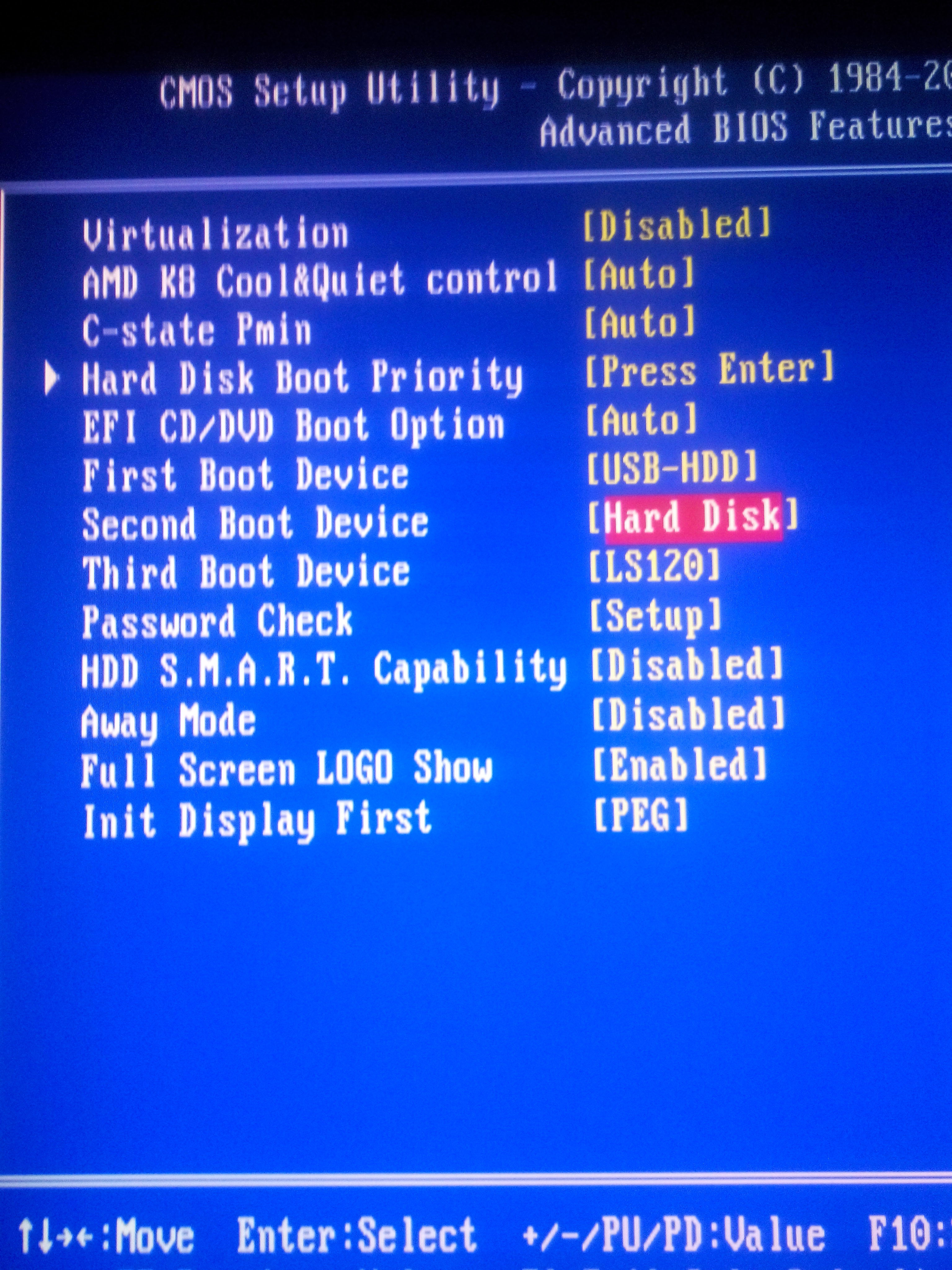

    You set booting in bios to USB HDD.
  • #24 16240618
    Vethix
    Posts: 73
    ok, from the bios level, I still set usb hdd as 1 boot device and so it runs win normally from the hdd drive
    Check again if this flash drive starts up after disconnecting the HDD.

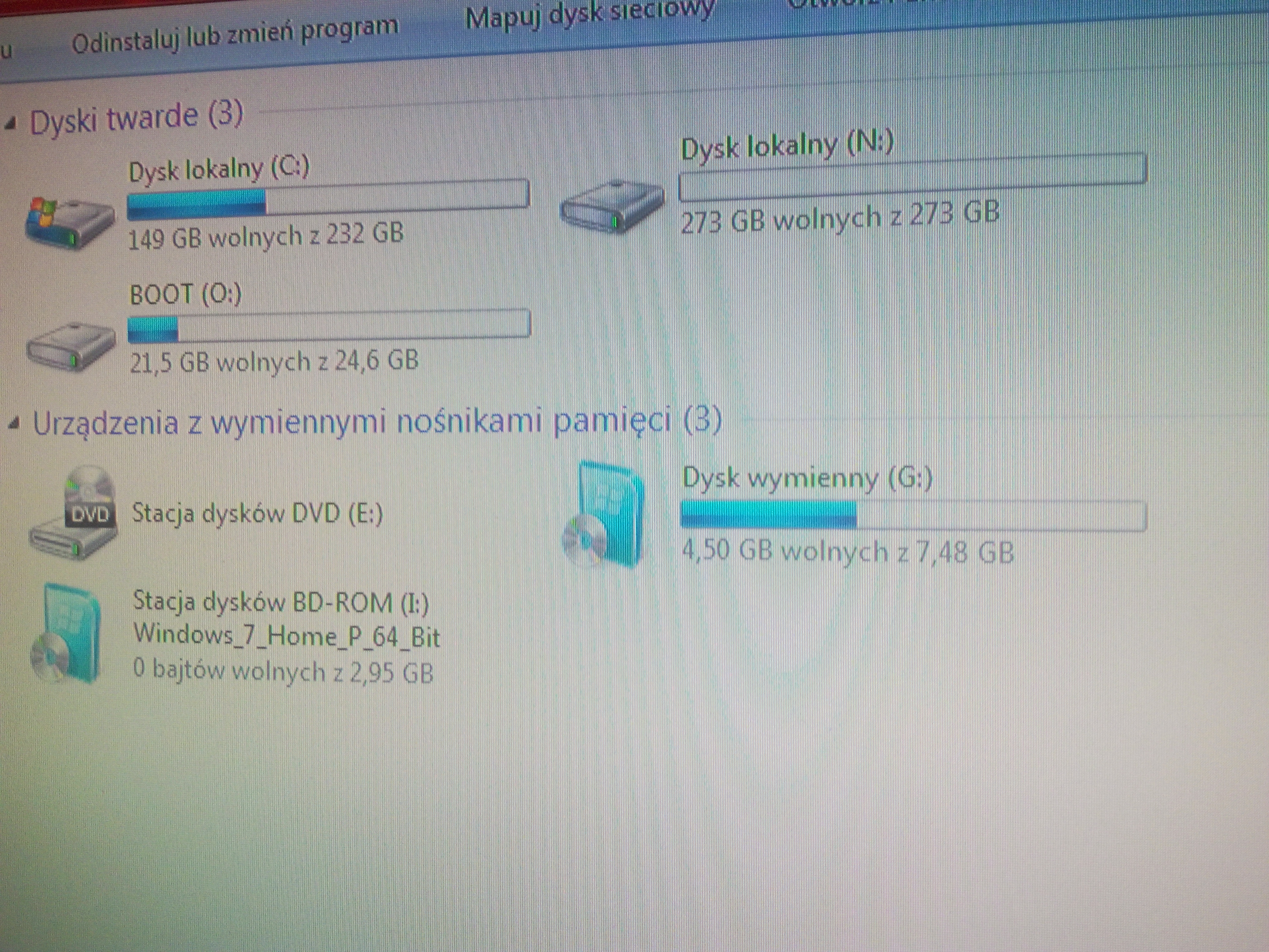

  • #28 16240754
    Vethix
    Posts: 73
    Sorry, but I still don't understand point 7, I did everything as in your guide. But point 7 is impossible to pass,
    my BOOT drive has the letter "O" optical drive "i".
    I do not know what to enter in cmd
    Added after 5 [minutes]:
    Ok, I guess I understood
    ok, point 9 done
    Now 10. disconnect the C drive with the old win?
    or just change booting to my BOOT disk and install windows on C or O?
    • Bios Boot Menu: Boot from Pendrive with Win7 ISO using Rufus on Gigabyte GA-A75M-D2H Motherboard IMG_20170130_204032.jpg (4.45 MB) You must be logged in to download this attachment.

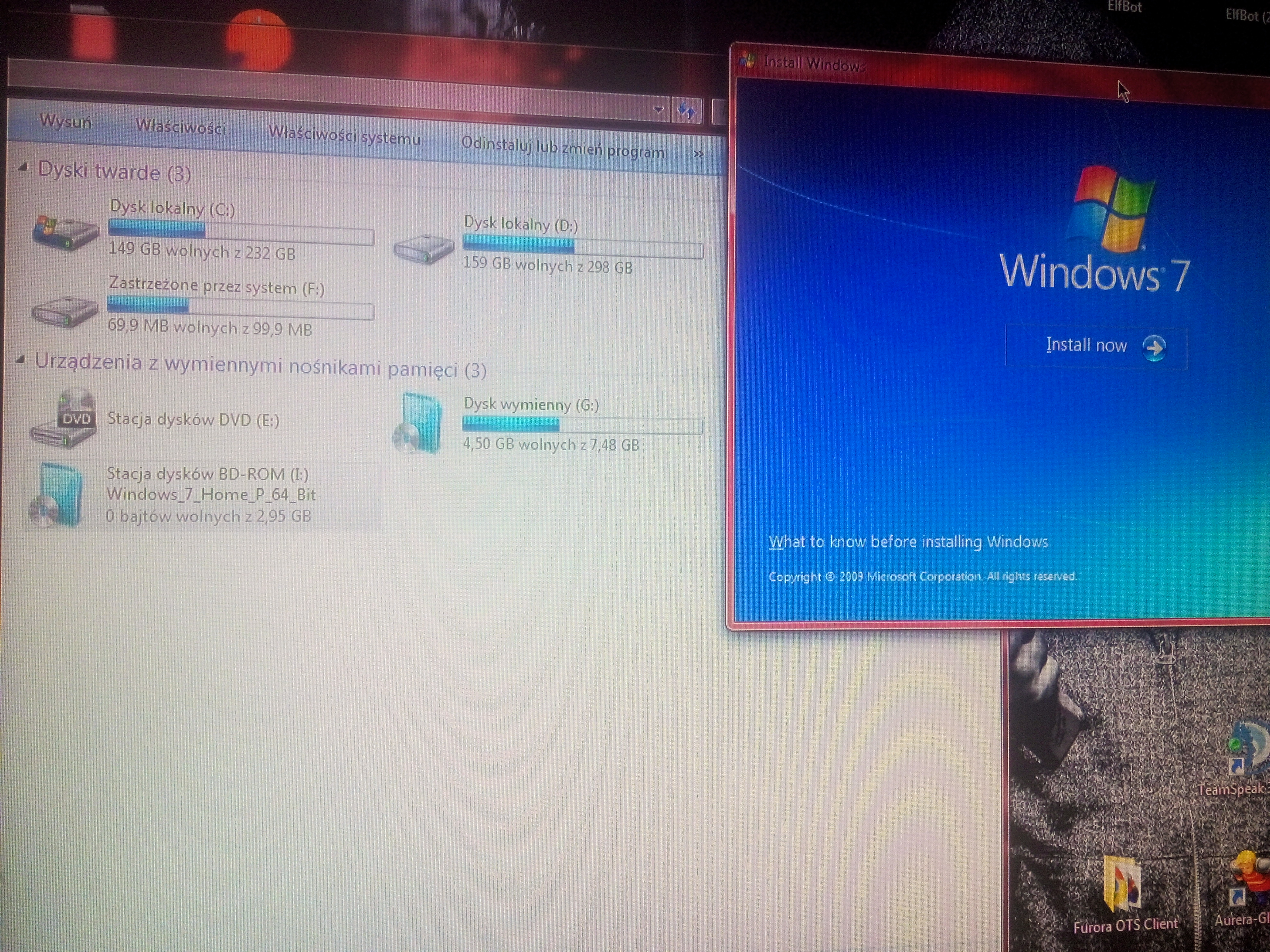

  • #29 16240801
    Vethix
    Posts: 73
    It looks like
    • Bios Boot Menu: Boot from Pendrive with Win7 ISO using Rufus on Gigabyte GA-A75M-D2H Motherboard IMG_20170130_204731.jpg (4.82 MB) You must be logged in to download this attachment.
  • #30 16240809
    DriverMSG
    Posts: 44094
    Help: 3984
    Rate: 4883
    The screen shows that the command has not been initiated. You must run the CMD console as an administrator.
    Unless you already have it behind you and have done it correctly.
    After the copying operation, restart the computer, in the BIOS select the disk to which you copied the Windows system from the disc, that is the disk with the "O" partition.
