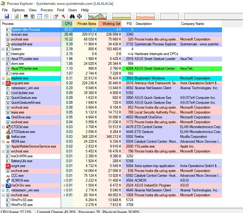

    Hello everyone, I`d like to write right away that I`m new when it comes to computers, so I`m asking for your understanding. After installing Windows 10, a circle appears next to the cursor every now and then, as if the computer was doing something, even though I`m not even using it. The updated system is doing something in the background, or should I look for the cause elsewhere? Please help.

  • #5 14898546
    Kolobos
    IT specialist
    Posts: 85178
    Help: 17171
    Rate: 10456
    Use Process Explorer and check what process is active at that time.

    Turn on sorting by CPU load and give a screenshot of the entire window from Process Explorer, take a screenshot when it appears circle next to the cursor.

    Did you mean the "CPU" column? If so, here is the screenshot:
    Circle Rotates Next to Cursor After Windows 10 Install - Background Activity?
    I turned on the computer scan, but the circle appeared earlier, so it`s not because of Avira.

    After closing both AsusTP* processes, does anything change?
  • #10 14898746
    Julkaaa90
    Posts: 68
    Now there was only one AsusTP, I clicked "suspend" and the circle disappeared for now. Does this mean that I have to do this every time I turn on the computer?
  • #11 14898805
    Kolobos
    IT specialist
    Posts: 85178
    Help: 17171
    Rate: 10456
    These processes (AsusTPCenter and Loader) are part of ASUS Smart Gesture, the touchpad software.

    As for the touchpad, after the update it did not work, only after installing the Windows 7 drivers everything returned to normal.

    This may be the source of problems.
    Uninstall ASUS Smart Gesture for now and check if everything is OK.
  • #14 14899095
    Julkaaa90
    Posts: 68
    I uninstalled and installed the newer version and it`s ok, thank you :)
