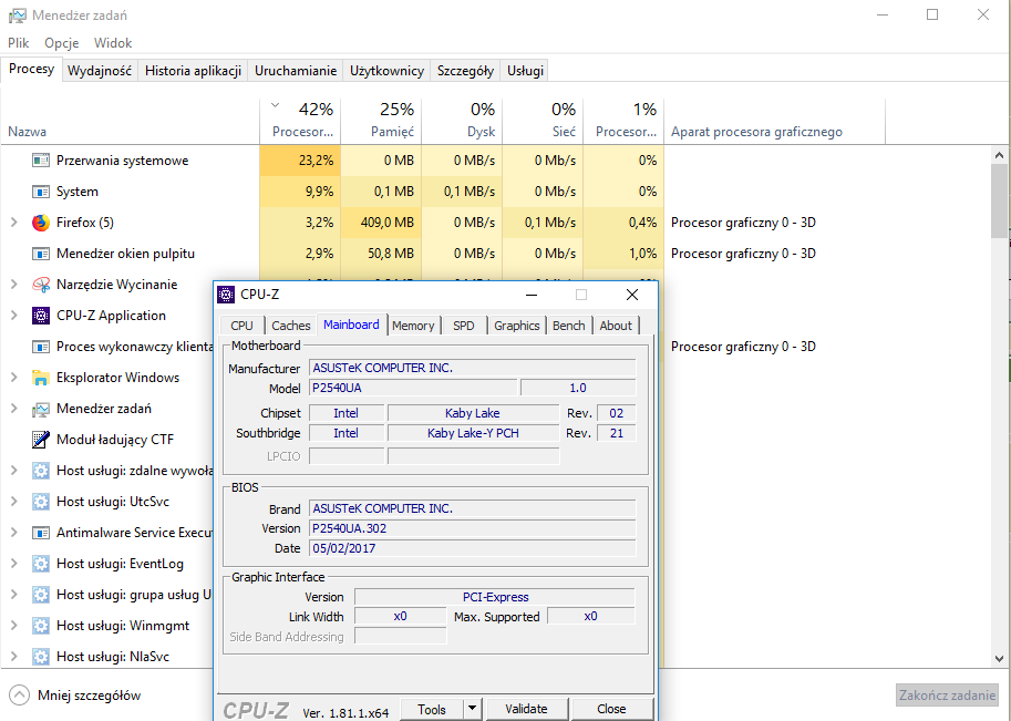

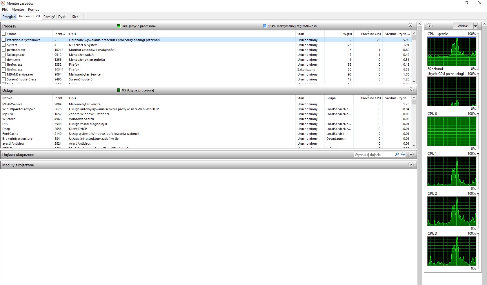

    For some time, the "System interrupts" process has been consuming around 20-25% of the CPU all the time. I did a Malwarebytes scan - found something, removed, restarted, scanned again and restarted the laptop. It did nothing, system interrupts are still eating up the processor. Nothing I would like to turn on in the autostart - I checked in CCleaner and Autoruns. I attach a scan with OTL and laptop information from Everest. The system is original Windows 10. I am asking for help.
    best regards
    EDIT: I add a picture which shows that the CPU is 100% used when idle.

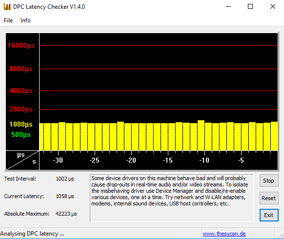

    For example, how to suck a program here and check the latency:
    http://www.makeuseof.com/tag/fix-high-cpu-usage-caused-system-interrupts/
    you have to turn off the components, because the problem may be physical damage.
    Turn off in turn:

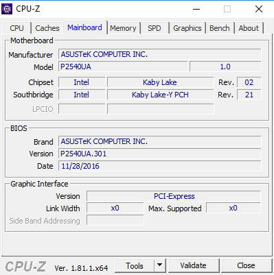

    Place the CPU-Z tab. Update the BIOS.

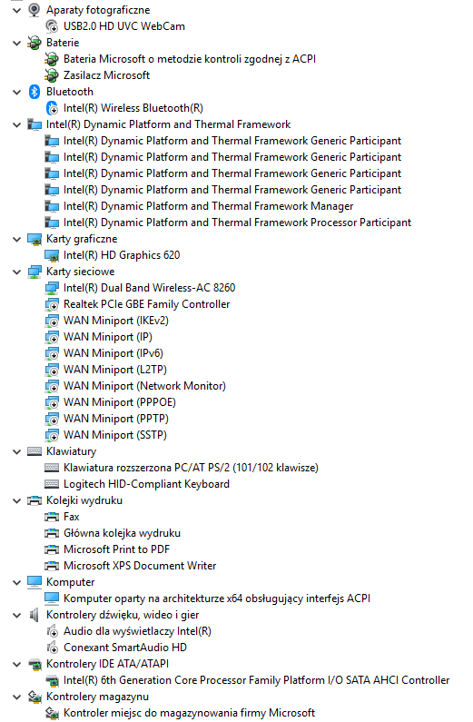

    The system is on SSD so I quickly restored it to factory settings On a fresh bet it is the same.
    The driver for the integrated graphics card was previously installed, but in the end it was not possible to install it.

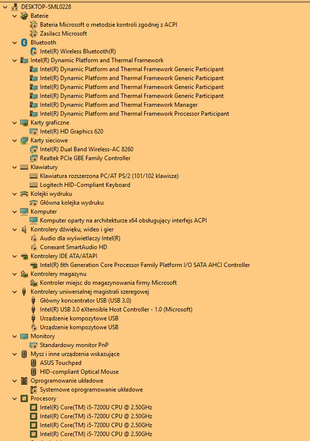

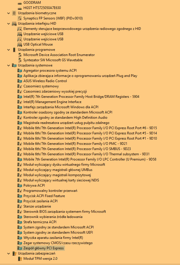

    I turned off the camera, bluetooth, graphics card, network cards, audio, fingerprint reader - nothing changed. I don't know which things I can turn off yet, I attach a list and screenshots.
    EDIT: Before refreshing the system, the sound disappeared for some time for unknown reasons. A long time later after scanning Malwarebytes I got a bluescreen ...
    EDIT2: Every device that had the option to turn off including system devices was turned off for some time. CPU consumption from system interrupts was 18-25% all the time.

    Bios flashing, the problem is still the same. Does your friend have any other ideas?

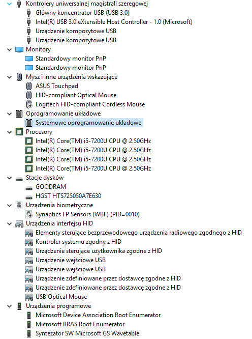

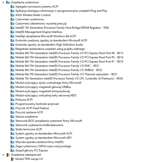

    Unfortunately, I don't have a dump. On battery power it is the same. Disabling "Magic Packet" did nothing. Now the slingshot consumption ranges from 11 to 27%. I keep searching.
    After installing all available drivers (bluetooth, graphics, hotkeye, touchpad, wlan, chipset, bios, card reader, line reader) without changes. Once again I turned off some devices (as in the attached screenshots) and checked the CPU consumption - also without changes ...
    EDIT: Babol found - after removing the HDD tray in place of the DVD, the AK184B has no system interrupts. Putting in the other pocket the same interrupt problems are gone. I also came across club art. Problem found.
