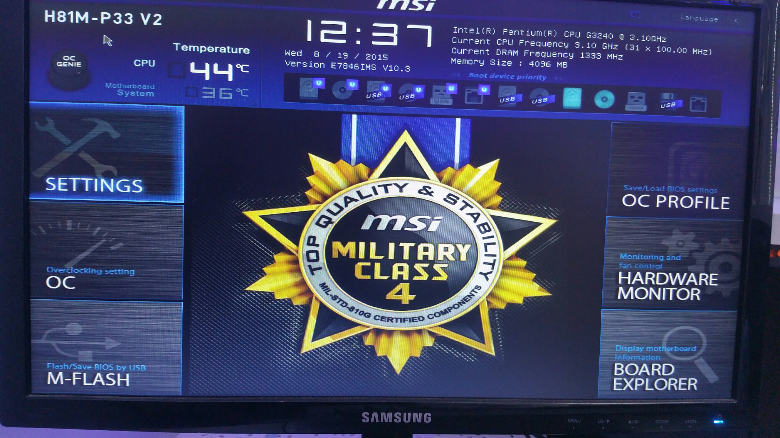

    I have a problem when I open the computer, it appears: No BOOTMGR this problem, I know how to solve it, but I can't open the BIOS. I hit F2, F10, F12, and Supr. With the first three, nothing opens, while pressing Supr, the screen appears as in the appendix. My questions
    1. How to boot into the BIOS so I can fix the error.
    MSI mainboard intel pentium CPU G32403.1GHz

    This is a bios. What settings do you have in "Settings"?
    Have you tried to press F11 (boot menu)?

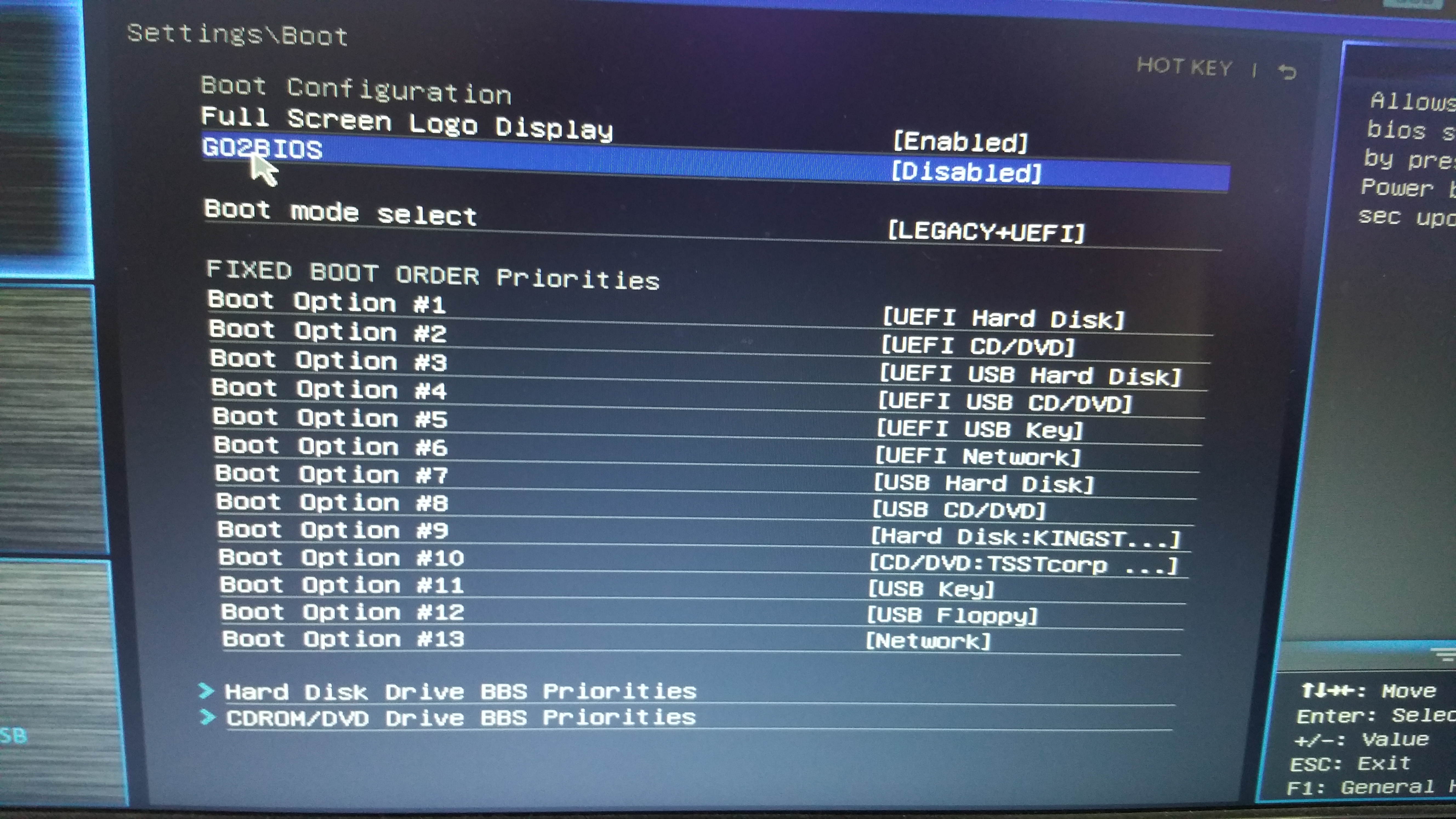

    I have SETTING as in the attachment

    The screen shows the boot options. Set cd / dvd first.
    It may be required to disable secure boot.

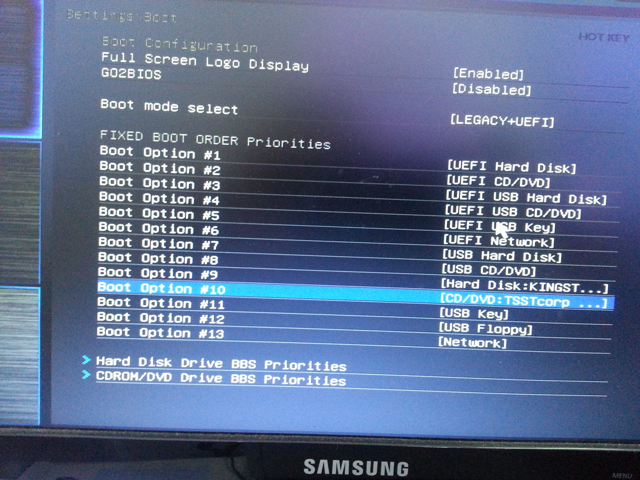

    I read on the net and found out that my computer has a UEFI interface
    there is an instruction somewhere how to fix BOOTMGR is missing in case I have UEFI
    the information "Set cd / dvd first" does not tell me anything if it is about what is highlighted in the picture in the first place

    Turn off the computer, press F11, turn on and check if the boot menu starts.

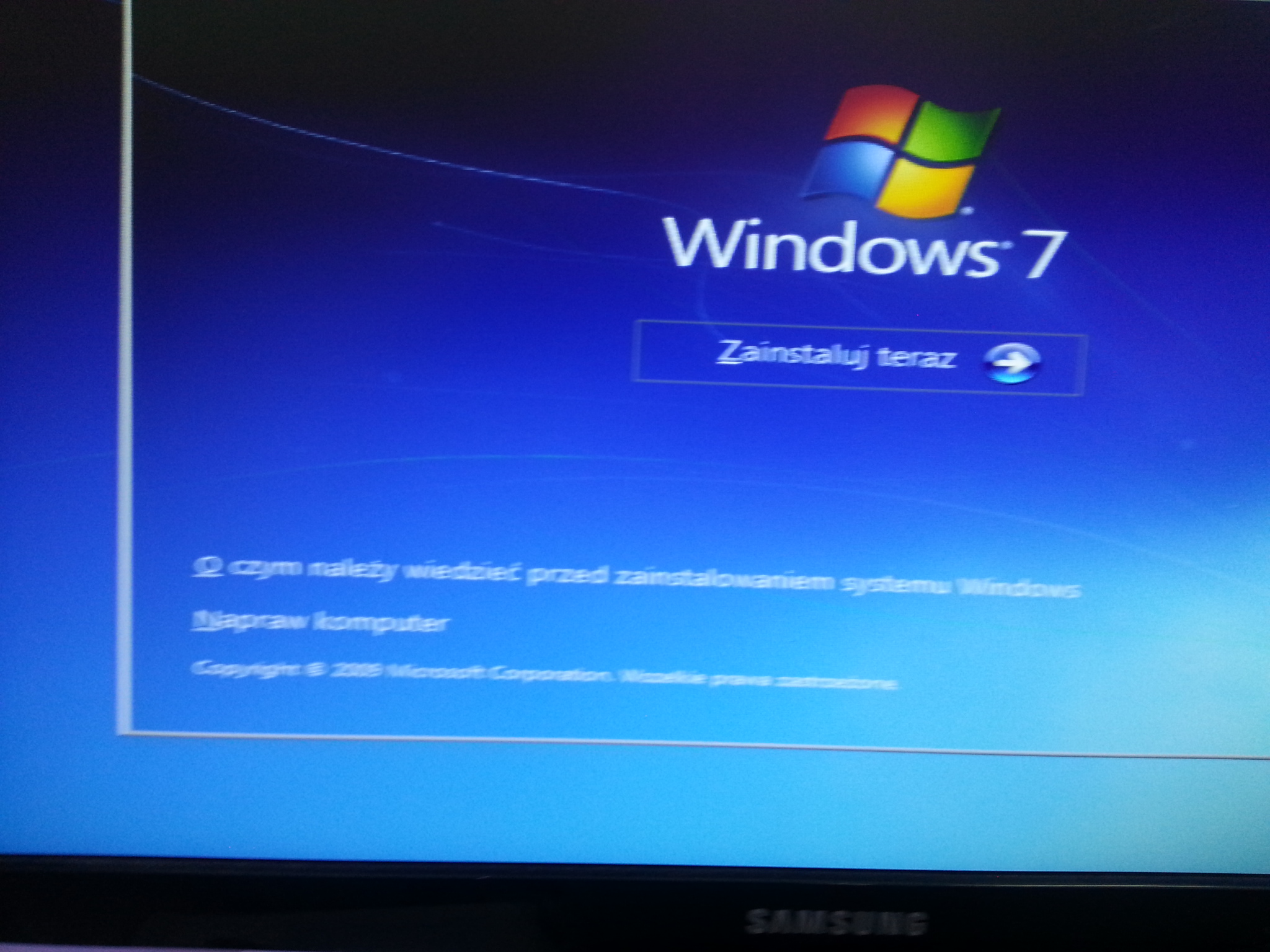

    I ran over SATA4: .... I fired with ENTER I am at the stage of the view as in the picture, you have to press "repair the computer", I prefer to make sure

  • #10 14932512
    Kroovka
    Posts: 572
    Help: 46
    Rate: 83
    Hmm ... You already got into UEFI, so according to what you wrote above, the rest was clear to you. So what's your problem now?
    You are asking for the repair option - did you have a system installed on your hard drive, it broke and you want to repair it, or did you install a brand new drive in your computer?
