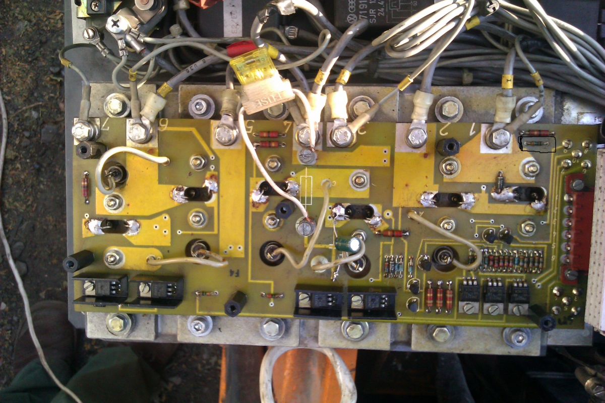

  • #14 20624984
    zwinka25
    Posts: 27
    I got a power board for repair and I need to find out what the resistor marked in the picture below is and if there are any replacements for the transistors (BUV18A) or if those from Aliexpress will be good.
    Electronic circuit on a printed circuit board with a marked resistor and a query about substitutes for BUV18A transistors.
  • #15 20680094
    faza1111
    Posts: 40
    Rate: 35
    I have a similar one on the table 100 ohm 2%, and I'm interested in what the original transistors in these black heat sinks are. One is 2N6111 and the other?
