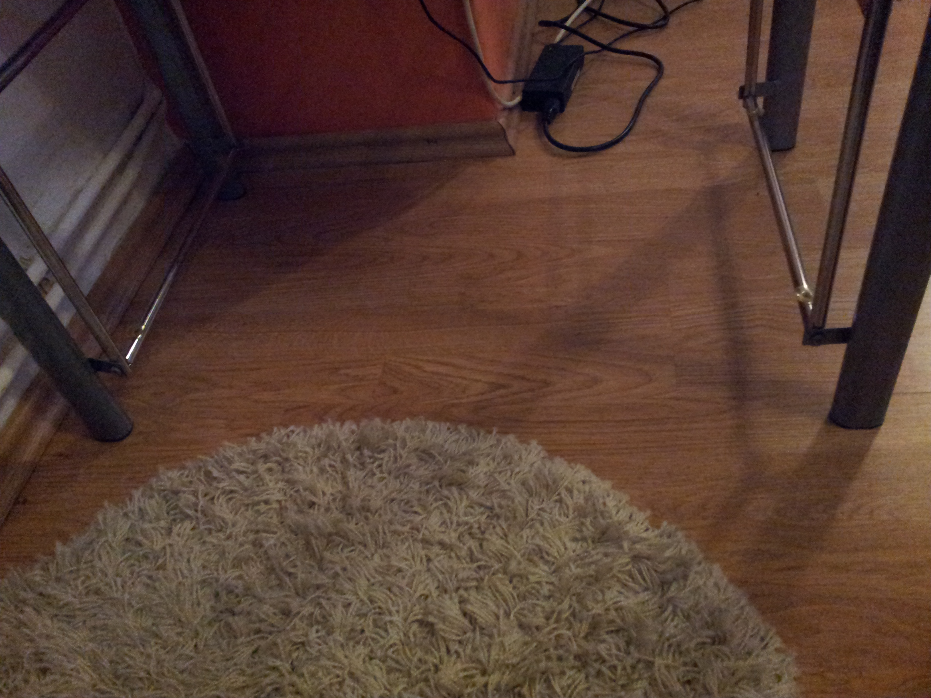

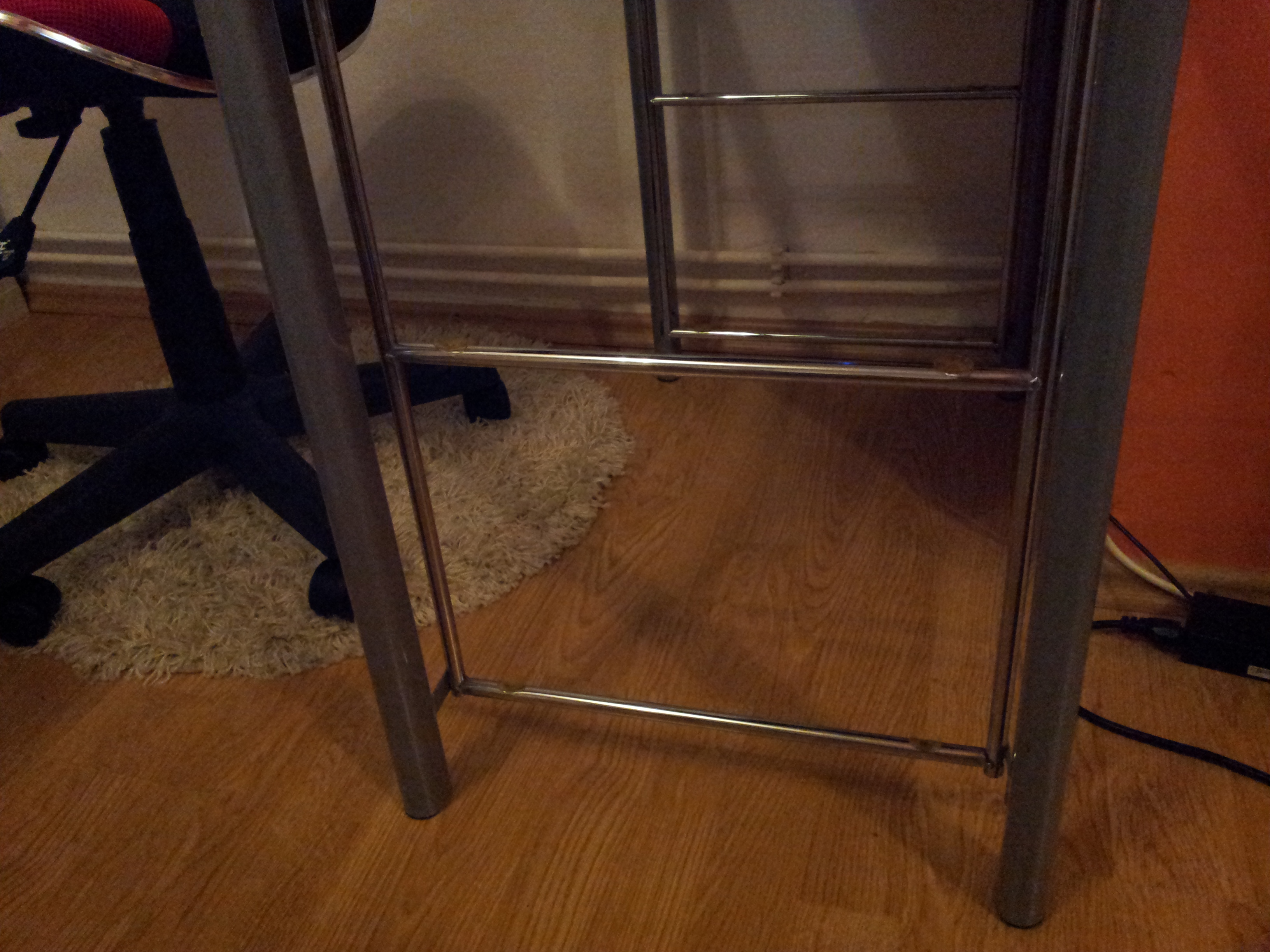

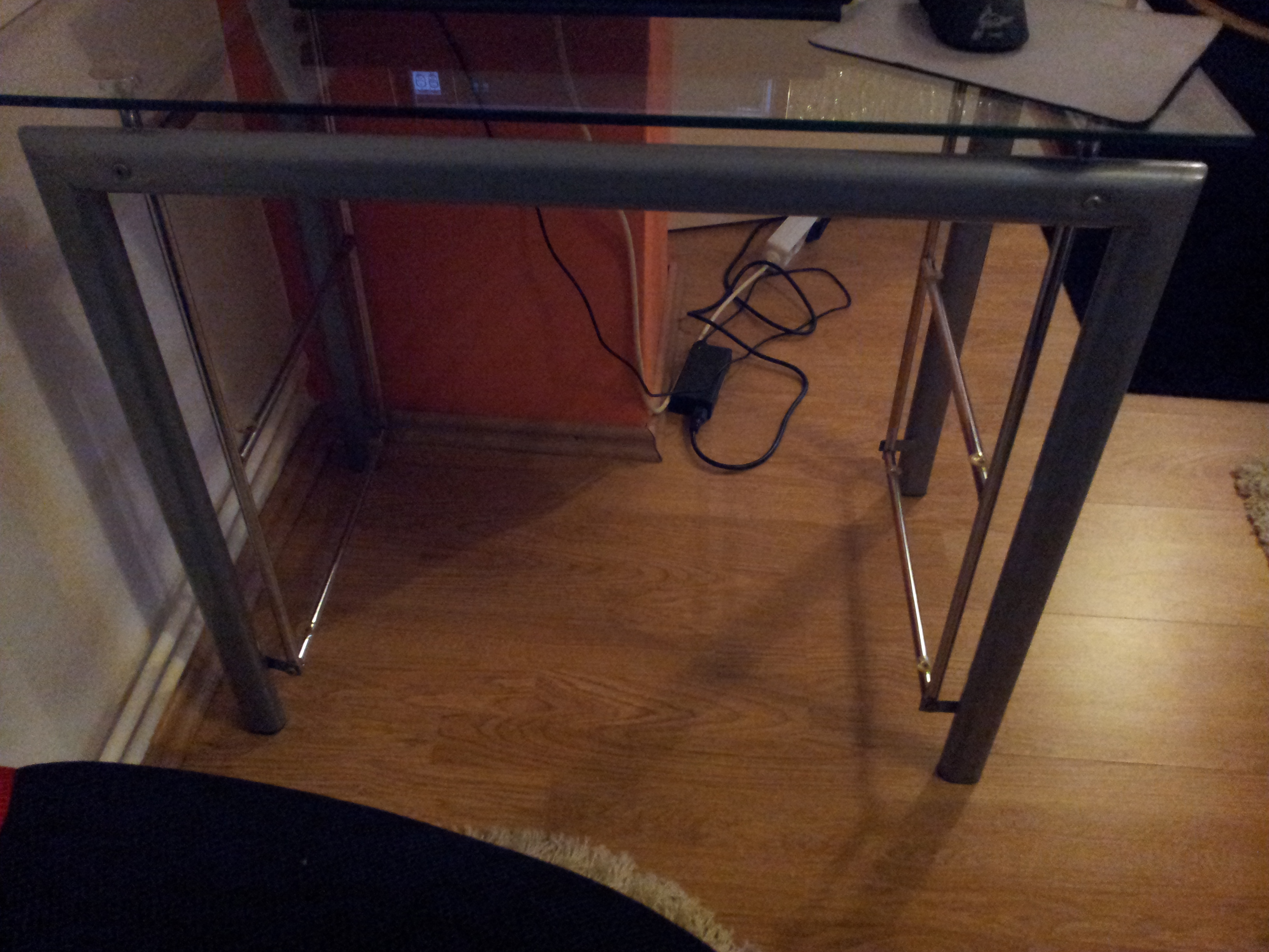

    Oki, photos of how it looks (there are black plugs on the bottom of these legs that can be removed):

    And also the dimensions of this profile (approximate).

    So they have feet
    A - 4cm
    B - 3cm
    C - 2mm

    You have two ties - or the extension of the legs from the floor side - the easiest way is with a square tubular profile that can be inserted into the interior (connected with self-tapping screws or blind rivets). A hardwood batten will also be suitable for raising the height. The second option - drilling new holes in the structure in order to raise the part of the furniture made of chrome rods by the desired height in relation to the tubular structure.

    It also seems to me that the idea of a Jdub colleague to raise the glass top is the most appropriate idea for the above task
