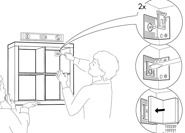

    Ikea adds two small steel angles 1.5 mm thick to its shelves, which are to hold the whole thing to the wall so that it does not swing. In the case of a 2x2 bookcase, they are enough to hang it.
    IKEA KALLAX 2x4 & 4x4 Shelving Units: Mounting Techniques for Small Spaces & Storage Solutions
    Can it follow that 4 such plates will hold the 4x2 rack? Somehow it would be hard for me to believe it ..

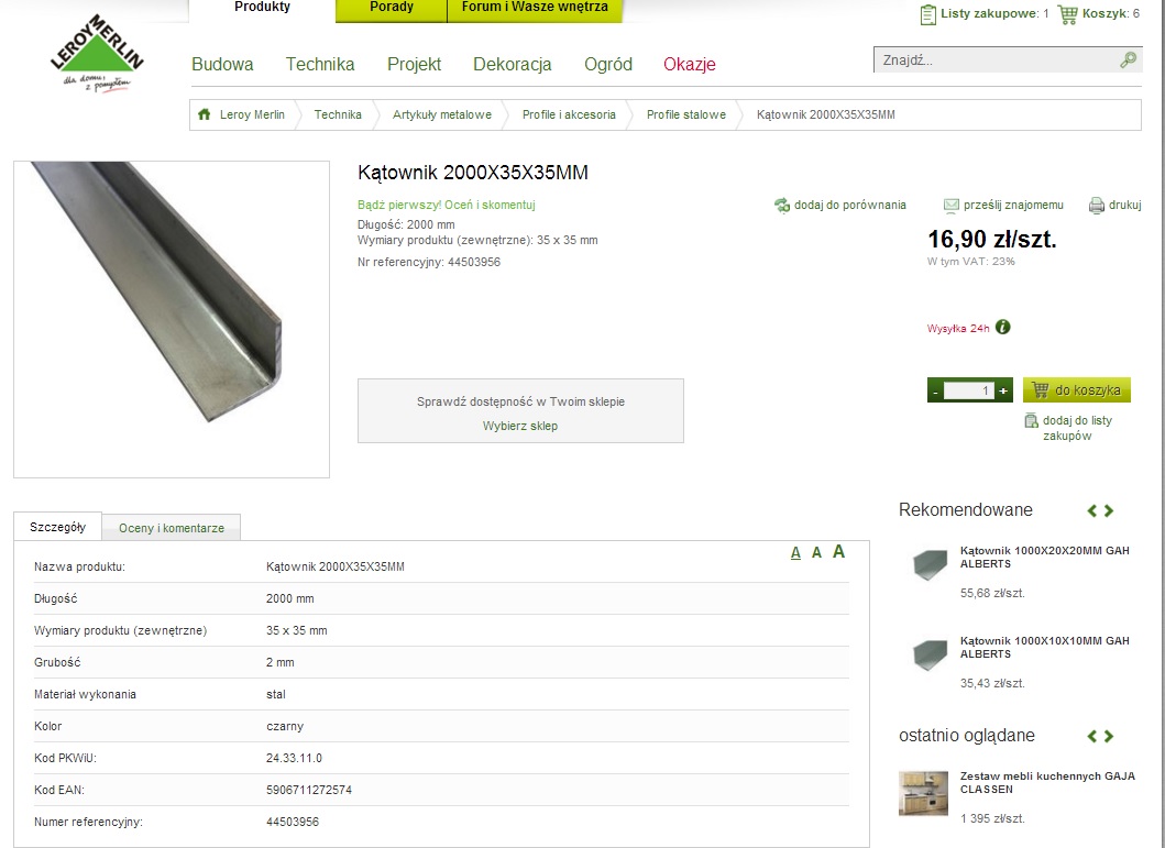

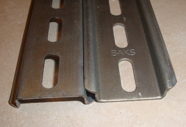

    I myself thought about the profiles attached horizontally along the wall and to the shelves. At the bottom, a 2 mm steel angle, e.g. such
    At the top, overlapping steel profiles of 1.5 mm.

    The second option is to use IKEA angles instead of profiles at the top, then the rack would be adjacent to the wall. The third is some systems for hanging kitchen cabinets, which have a load capacity of two / four times higher than I need, e.g. scarpi 4 (unfortunately, I do not have the right to post links).

    If the outer walls are solid, the concept with the rail along the vertical is probably the only correct one. The rail should be attached with special shafts or, as a last resort, with black wood screws, after drilling holes. Better not to use self-drilling screws. And these rails should be hung on the wall.

    If I understand this correctly, only supporting the wall side is unlikely to solve the risk. These sheet angles seem to be sufficient fastening if it is steel sheet. Then the bookcase will not slide down, but when tearing from the top, it can fall into the room. Perhaps you should add some legs to the hanging corners of the bookcase from the inside of the room or grab the side surfaces of the bookcase from the top. It all depends on the solidity of the structure.
