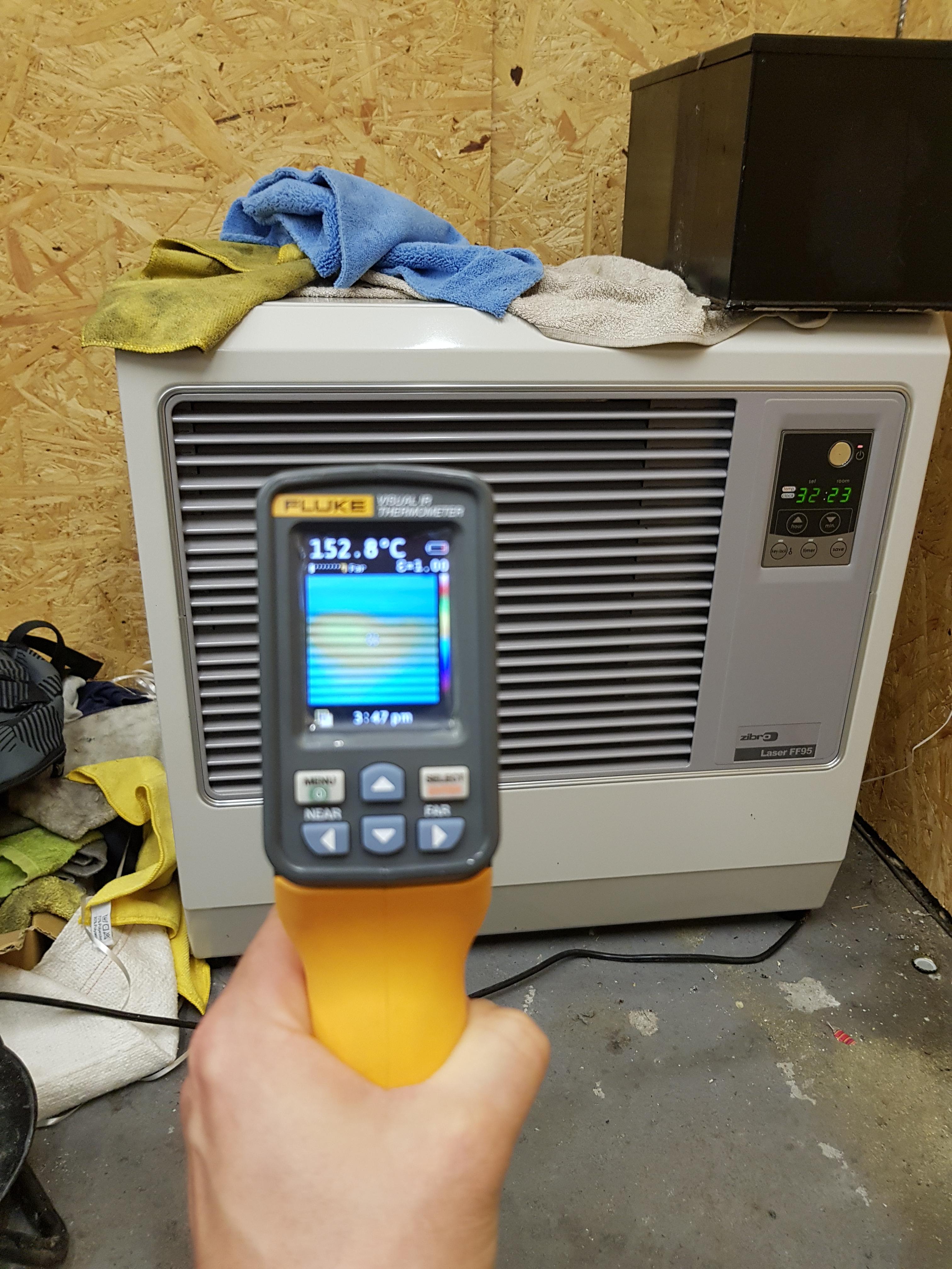

    The FF95 furnace is a normal Webasto for heating oil or crude oil. A closed combustion chamber with a chimney, a Japanese product, and they heat with a more calorific mixture of crude oil and kerosene. Go ahead and pour ON or firewood. Kerosene stoves without exhaust will also run on oil and even light kerosene, you'll only suffocate! Pure kerosene leaves only moisture, it stinks when ignited and that's it. I cured myself of it, I also bought the FF95 and recommend it.
    • Using Fuel/Diesel Oil in Traditional Kerosene Stoves (Zibro) vs Expensive Zibro Kerosene 20181109_232358.jpg (1.21 MB) You must be logged in to download this attachment.

    I confirm, I have had the FF95 for a year and a half and I have no problem with them, I pour them with diesel and smoke them without any problems, I agree with Mr. At the beginning I had problems with starting because the stove requires a gravity tank, of course it has a built-in fuel pump that supports the fuel from the outside. A 30 liter tank with a tap was enough for me, which is enough for me for 2 months. The only downside is that the stove must be placed against the wall in order to put the exhaust pipe outside. You have to drill a hole in the wall. The package includes an exhaust, it has adjustments according to the thickness of the wall. It's a great thing, it heats without any smell, practically no unpleasant odors. After turning off, the fan continues to run, throwing an unpleasant smell outside. The stove has a built-in fan which spreads heat around the room. Controls by computer. It works very well, without interruption, it has temperature sensors, if after exceeding the set ambient temperature, the stove goes to sleep for a while and when the temperature drops below 2 * it starts again. I have a garage with dimensions of 50 m2, it warmed up to 20 degrees in 15 minutes. It smokes very little. It is protected against children, when it falls on the floor, it immediately goes out, everything closes the injection blockages, protects against self-ignition. A great thing thought out by the Japanese because in Japan they have frequent earthquakes, various earthquakes, so an invention like this Zibro FF95 meets their requirements. And the TOYOTOMI company (the same brand as Zibro) are specialists in such matters. They write on the forum that you can confidently pour oil and the equipment has been working for a long time. And I also have a separate set with a remote control with control by day, automatic activation by time, e.g. work. I recommend. Regards.
