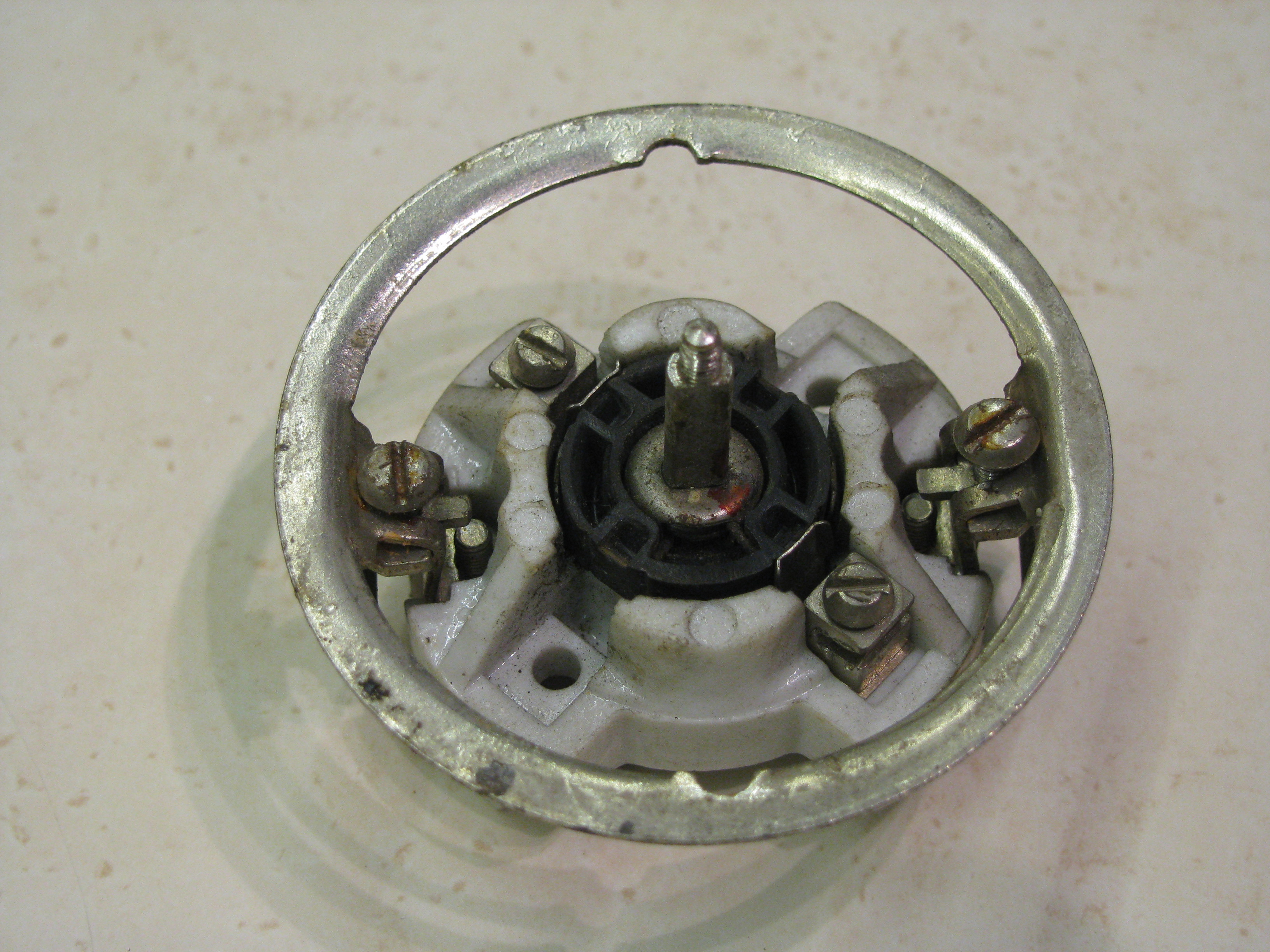

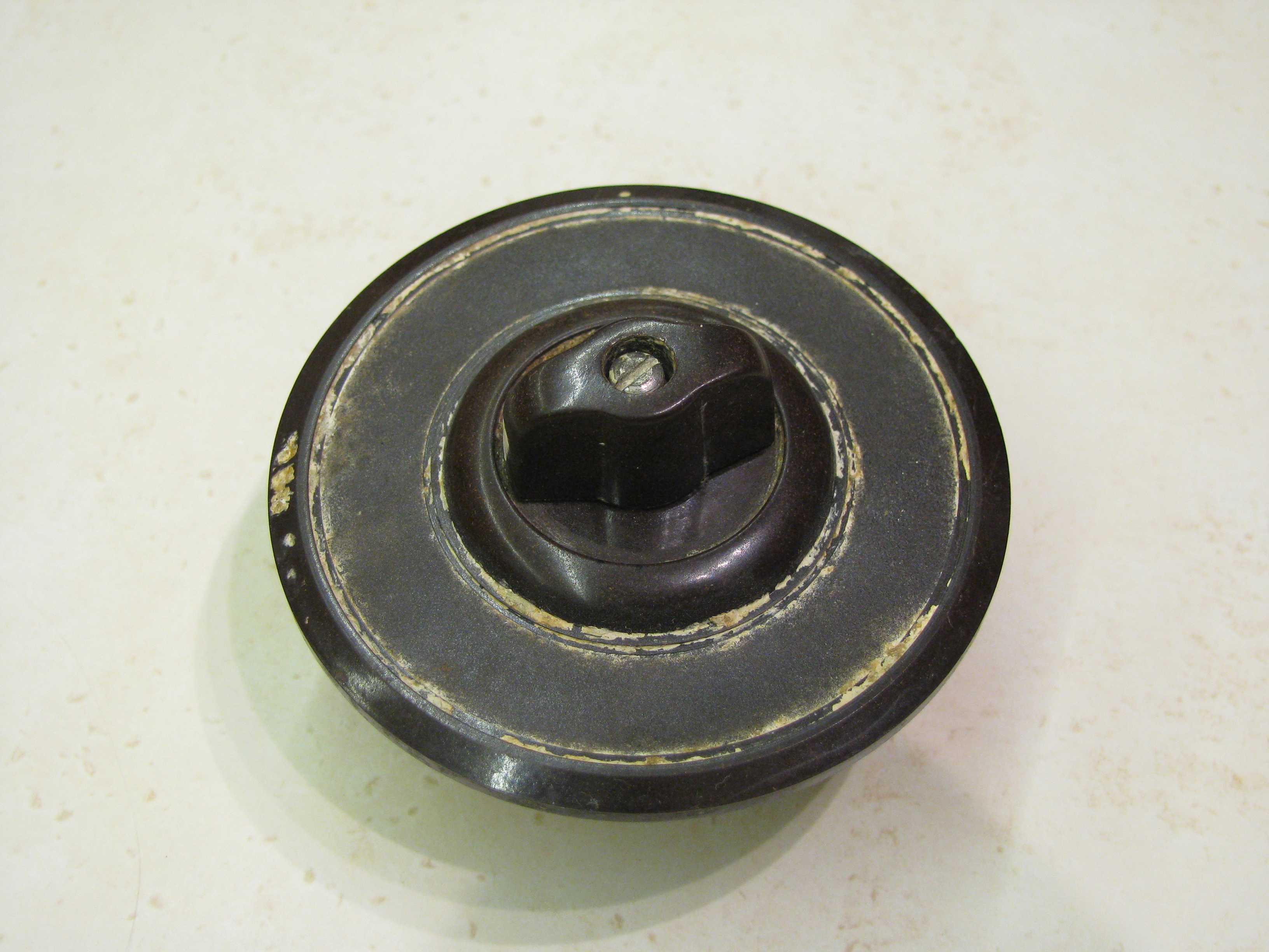

  • #12 15135104
    elpapiotr
    Electrician specialist
    Posts: 12211
    Help: 1015
    Rate: 3532
    retrofood wrote:
    If I find this rotating one in my country, I will check it.
    There were for sure:
    Cross Connectors as Staircase Alternative: Creating Stair Function with Limited Supplies
    And they looked like this single one. They differed only in the construction of the cams in the cylinder and the fixed clamps:
    Cross Connectors as Staircase Alternative: Creating Stair Function with Limited Supplies Cross Connectors as Staircase Alternative: Creating Stair Function with Limited Supplies

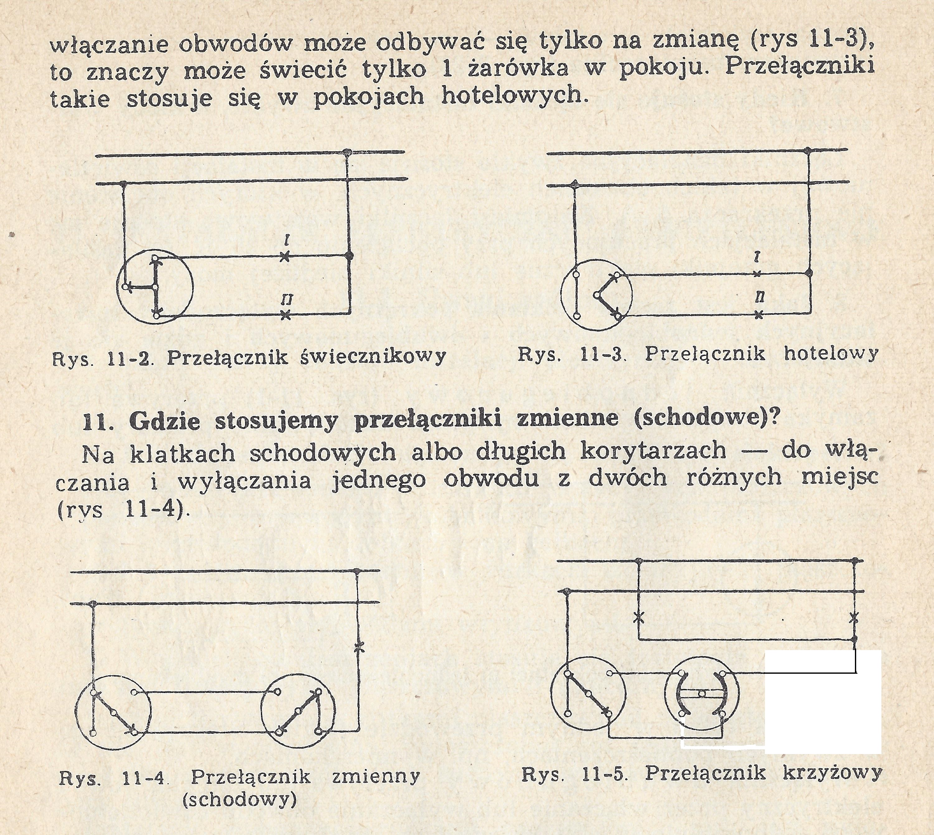

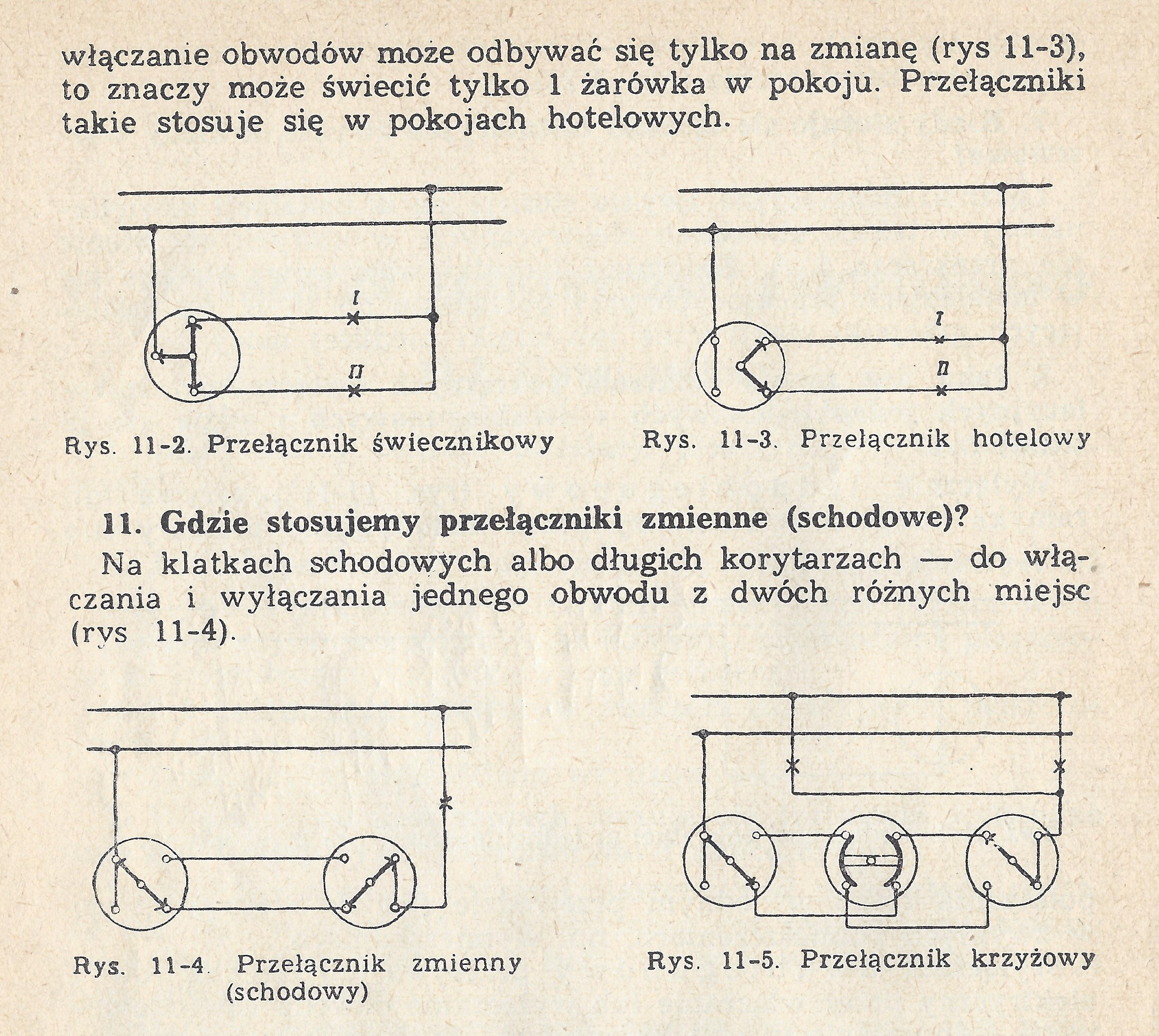

    Fast, cross rotary in the role of a staircase:
    I cannot imagine such a construction that could not work like this. Pol102 why it was not possible? The very principle of operation shows that everyone is suitable, unless, I don't know, they have a processor that controls the voltages and currents or something like that.
