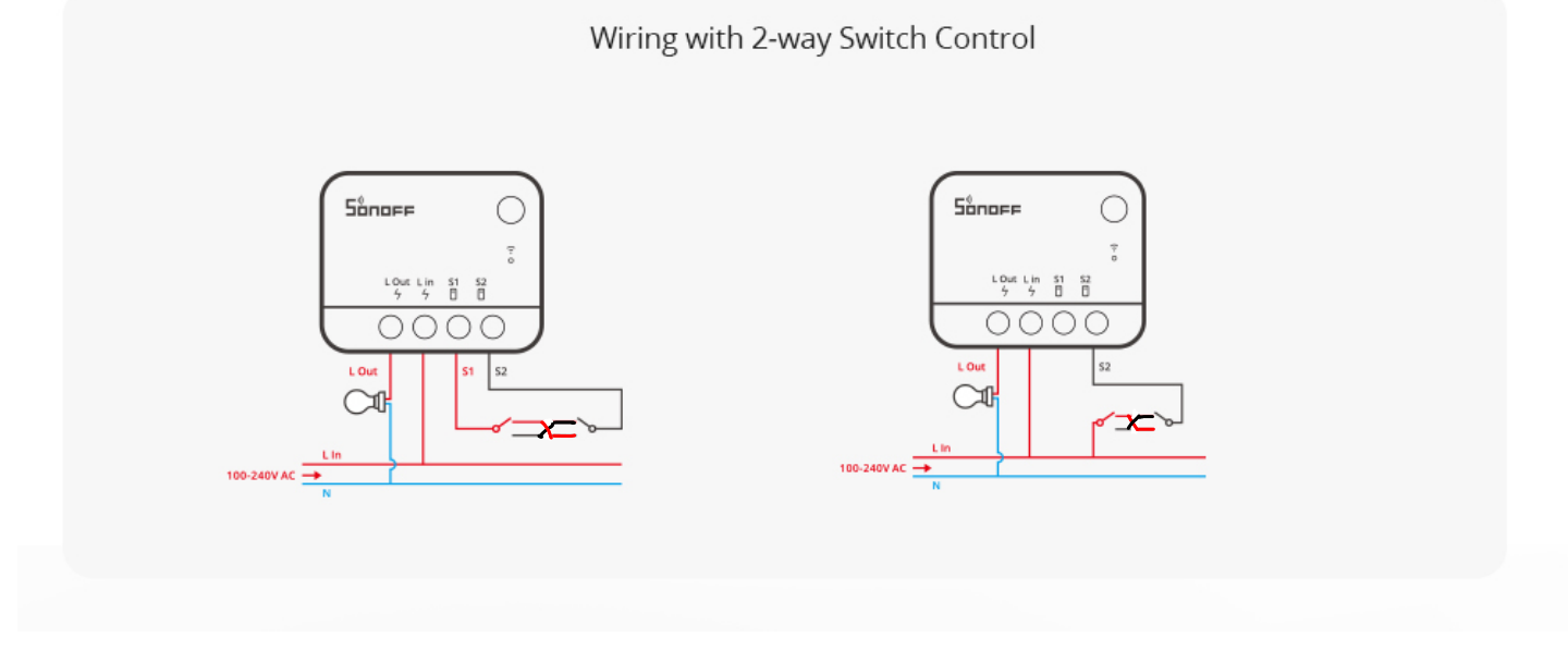

    Can any esteemed colleague help to connect this Sonoff ZBMINI L2 switch to a staircase - cross - staircase circuit in an old installation? Schneider SEDNA bistable switches.

    According to the instructions, one or both end wires of the switch unit must be connected to the Sonoff and the Sonoff itself must control the lighting directly.
    Wiring diagram for Sonoff with two-way switch control

    Thanks for the hint. Connected and working.

    >>20746761 Hi. In order for the staircase system to work properly, is one module enough? Or do there have to be two - one under each switch? Maybe a diagram of how to wire it under the switches? 😁😉
    Thanks in advance.

    You only need one, connected according to the diagrams posted earlier, only instead of the usual switch there is a stair switch arrangement.

    I guess I'm too thin on the subject because I'm experimenting and nothing is coming up. Can someone smarter tell me how specifically to connect the relay contacts to the switch? Does any modification need to be done to the other switch?
    You have the option to
    1) add another wire to existing 2 way wiring following the original diagram like this (ignore the neutral wire)
    https://sequr.be/blog/2020/07/intro-into-shelly/#two-way-toggle-switch-with-shelly1pm
    2) or simply convert existing switches to momentary so you don’t need to install new wire
    https://sequr.be/blog/2020/07/intro-into-shelly/#two-way-momentary-switch-with-shelly1pm
    https://youtu.be/hNZh8gnXLqs?feature=shared

    But he has an installation there with stair switches just can't figure out how to connect it to a Wi-Fi switch now.
