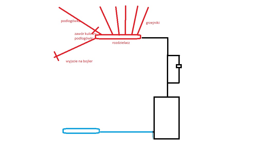

    legro
    Posts: 45
    I am giving a diagram, but I do not know if it can be called a diagram, at least this is what it looks like in my basement.
    Controlling Temperature in ZEBIEC S1WK10 Furnace: Managing Overheating and Water Pump Setup
    The floor is powered from the distributor. A few centimeters behind the manifold is an ordinary butterfly valve.
    Forum member Ptak3124, thank you very much for your contribution to this topic. Just remember that I am looking for a reasonably rational solution to the high temperature problem. I want to be sure that the installation does not boil over and that the living conditions are bearable. I would like to provide myself with some protection against reaching over 70 degrees on the stove and that is why this topic was raised. It is different in life, I may not be at home, my wife will go and throw in 2 cubes of coal too much and it will be linden. I know it sounds stupid because if there was no problem, we should throw in less than more. But it's a bit like airbags in a car - I wish it was just in case. It won't be great for this.

  • #19 15182302
    gersik
    Posts: 1717
    Help: 164
    Rate: 639
    Put some coal in and light it from above. If there is such an installation as in the diagram, I do not envy you. If you want to lower the temperature on the radiators, use the 4d valve and connect the boiler to the installation correctly. You can write more when you are ready and willing to remake.

    vodiczka
    Posts: 30276
    Help: 1185
    Rate: 4311
    legro wrote:
    After 1 hour, there were 68 on the stove.
    In my opinion, this is what it should be. I remember similar heating in my parents' apartment years ago - a stove in the kitchen, radiators in the rooms and bathroom. Gravity water cycle. We kept the water temperature in the furnace between 60 and 80 degrees and there was no problem with that. If, with economical burning, the temperature is still too high, then the stove's power is clearly too high in relation to the needs. It remains to build a small greenhouse or a frame with a heated substrate and direct excess heat there :)
    If a colleague still insists on draining the water into the sewage system, a temperature controller with a range of up to 100 degrees plus a solenoid valve will solve the problem.

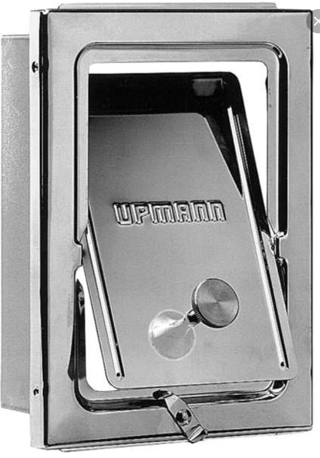

    Phaeton
    Level 19  

    Rate: 169
    You write that you close the door deafly, up and down. What about the throttle on the chimney pipe? If you have a strong draft in the chimney, it will get you everything. I can't imagine that your boiler does not have something like that, but upload photos. Adding tank pumps etc. can be done in order to increase efficiency and comfort, but the boiler itself should be stable without such additives.
  • #28 15186092
    Ptak3124
    Posts: 505
    Help: 70
    Rate: 250
    What is the idea of closing the chimney damper?
    Protect yourself from such advice!
    There is a flap in the boiler door, not a damper, depending on the amount of air to the furnace. If the boiler is "tight" (no cracked door, gaskets made of glass cord, etc.), the draft regulator will suffice.
    If, on the other hand, the chimney draft is too strong and the boiler cannot be sealed for some technical reasons, then a chimney draft regulator is proposed and it has nothing to do with the boiler.

    Phaeton
    Level 19  
    Posts: 414
    Help: 15
    Rate: 169
    Of course, it closes, so it is installed by the manufacturer in the boiler at the outlet to adjust the air draft to the chimney and the current air demand. It is coarsely regulated in a wider range and more precisely with the flap on the door. This is the basic issue if we want to heat the house, not the surrounding area.
  • #30 15186175
    Ptak3124
    Posts: 505
    Help: 70
    Rate: 250
    Yeah!
    And what will happen when an inexperienced smoker ignites the boiler in windy weather, when the chimney draft is extremely strong?
    Use the chimney flap to regulate the draft and cover the outlet almost completely. Apparently it is good ... But outside, the wind stops and the chimney draft decreases. There is a lot of coal in the boiler. And suddenly you can smell the stench in the boiler room, which can sometimes poison the household members.
    I'm not sure if the boiler flap at the chimney outlet is such a good idea.
