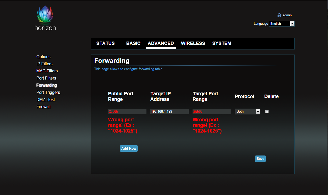

    I have a problem with horizon, can't unblock ports. Please help. Maybe I'm doing wrong?
    Greetings.
    • UPC Horizon: Step-by-Step Guide for Unblocking Ports Effectively and Efficiently upc.png (135.25 KB) You must be logged in to download this attachment.

    Range = width / range. Have you tried to enter "25565-25565"?
    It's just ...

    And my colleague knows what port forwarding is and what is port triggering, what are port ranges, etc. - or is it just blindly hoping to hit?
    Since you want a range of ports, how do you want to only forward one port?

    I don't know, and the horizon tutorials don't work.
    Kolga above asked for it and I did. (it's about the port)

    In forwarding a port range is redirected, in port triggering a given single port is redirected.
    You want to forward a single port in a forwarding port - not this tab - you do it in port triggering.
    Please also remember that Horizon is something like a modemorouter - here the port is unblocked on Horizon and not a given computer.
    It remains to enter the IP of the computer in the DMZ Host tab - people who have their modem routers: Thomson, Cisco or Technicolor have similar - here and there the external IP has a modem router, not a computer in the network and the redirection does not work.
    It remains to replace Horizon with a regular cable modem by changing it from modemorouter to bridge (it should have such an option) - but this requires buying your own router, if we have more than one computer on the local network - only one computer works in a bridg without its own router.

    I added the console ip and nat is open. Thanks for the help!
