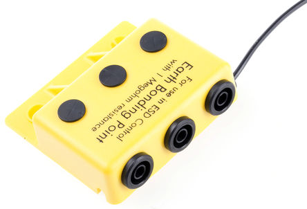

  • ESD wrist straps use 1 MΩ safety resistors
    #38 15204756
    tplewa
    Posts: 6741
    Help: 222
    Rate: 1009
    Kraniec_Internetów wrote:
    cooltygrysek wrote:
    If the neutral circuit is broken, phase potential will appear on the neutral wire by other devices connected to it. If someone has a bracelet or antistatic mat connected, you know how it can end. I have seen such things more than once in apartment blocks, tenement houses and houses.
    As? After all, these bands have a 1M? resistor or more, right?
    Personally, I have no resistor, maybe you can buy "with a crocodile clip" in May ... but it is "maybe" :)
    Well, unless a friend has one with a resistor and checked with a meter - but judging by "or more or not" :) rather not :)
    Usually everything is connected to such earthing boxes that contain resistors:
    What soldering iron to start your adventure with electronics up to PLN 80?
    They are also in the form of a plug to a PE socket.

    The colleague has a splitter for connecting wires with banana plugs. ESD Protection also has the mentioned resistors.
  • #40 15205220
    tplewa
    Posts: 6741
    Help: 222
    Rate: 1009
    He writes on the casing "With 1 Megaohm resistance" ;)

    Ah, my fact, not my attention, but the photo turned upside down
