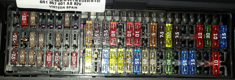

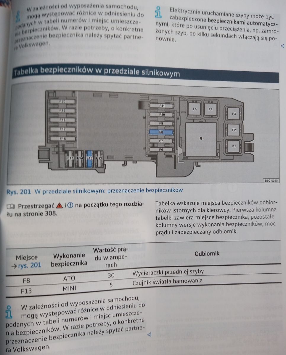

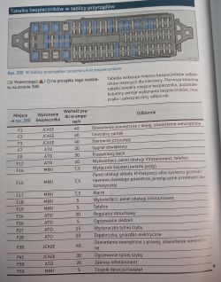

    Hello, I will probably win a golden spade for digging up a topic from years ago, but it's hard. I have the same problem as the predecessors: the washers in the VW Polo 6R 2016 1.2 TSI do not work, there is liquid, the indicator is not on, so I wanted to start with the fuses. The manual has "brilliant" wording for describing the fuses: "important for the driver". :p
    Can someone help me determine which fuse is for the windshield washer - there are 2 fuse boxes? The front and rear wipers work (there are no rear washers). Below are the photos.
    I did some reading and found out that the windshield washer system can only be activated when the hood is closed. So where is (if fitted) the hood contact switch -F266?
    And what else can I easily check without dismantling the wheel arch to get to the reservoir and fluid pump?

  • #19 20847759
    yoshi9148
    Posts: 6
    Rate: 19
    The mass switch is located in the latch lock of the hood, you can remove the plug or use a screwdriver to slam the hood, in your case the pump is 99% dead, (

  • 7.5A washer fuse under steering wheel box
    #24 21151835
    weer
    >>20847903 .
    Hello, did you find out? :D
    Edited as I found on some video. The 7.5A fuse, located in the box under the steering wheel, in my case completely on the left side, and in the 2 videos I found, completely on the right side. This is probably the only 7.5A fuse.
    Videos:
    I'm posting here because this is the first thread that google spits out when typing in the phrase "polo 6r windshield washer fuse", and if that doesn't help anyone, I recommend typing in "2016 VW Polo 6R 1.2 TSI windshield washer fuse"
