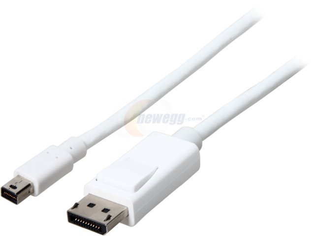

    I have an iiyama GB2488HSU monitor and an AMD r9 280x graphics card and I can not set more than 60hz. My monitor is connected via a DVI-D cable. Both the card and monitor drivers are as up-to-date as possible.
    I will just add that very rarely but there are bluescreens (I don't know if it has anything to do with it).

    For 144Hz, you need a DualLink DVI cable as far as I know.
    Ew DP or HDMI.

    I would not buy a monitor for over a thousand if I wanted the standard 60hz. From what I read, the DVI cable should normally reproduce the 144hz for me. The card does not have a displayport input, so it is off, and after connecting with an HDMI cable, everything remains unchanged, only the 60hz option is displayed. In my opinion, the cable does not matter here, but something in the system. I even tried to reinstall the complete graphics card, but to no avail.

    In fact, after reading HDMI, it will not be possible. 60hz max.
    How much DVI does your card have?
    Sometimes, with many DVIs, not every connector is DualLink.

    I sat a bit yesterday and managed to get 120hz but only at 720p
    @_robert_ BW one of your links I found such a cable iiyama GB2488HSU Monitor: Achieving 144hz with AMD R9 280X Graphics Card via DVI-D Cable and I am thinking about buying it, maybe it could help in getting better results.

    I just connected the cable as in the post above and another problem appeared. When I select the displayport input in the monitor, I can only see my wallpaper, neither the start bar nor the icons are visible. Anyone know what this could be about?

    Divided the image into 2 - the extended desktop.

    Thanks to everyone for your help. Currently, everything is fine on the mini displayport and I can finally use 144hz :D
