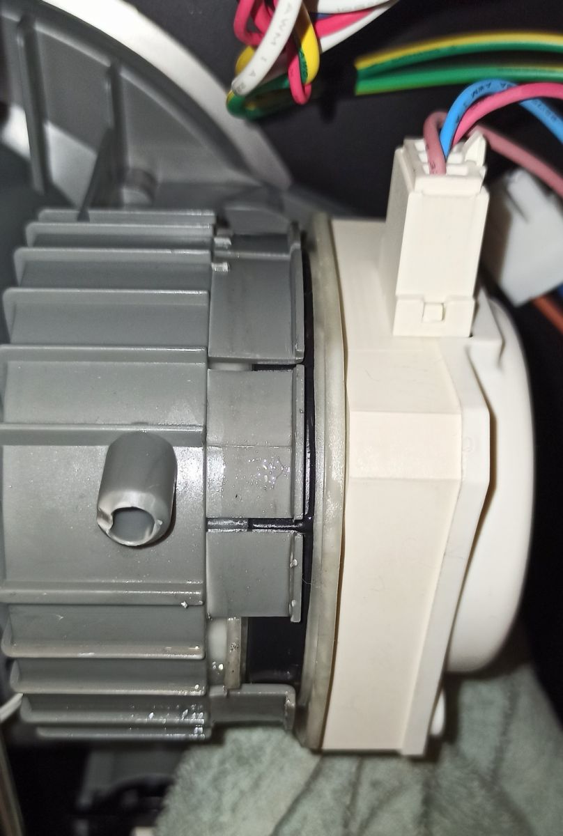

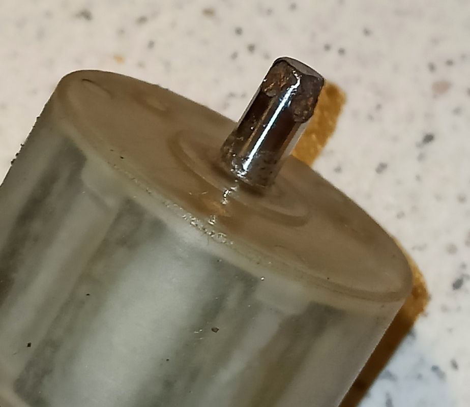

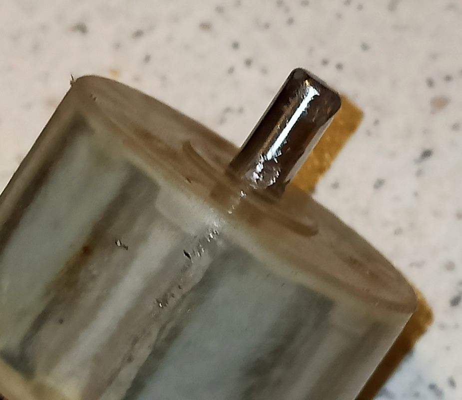

    jam_es
    Posts: 491
    Help: 75
    Rate: 94
    noma99 wrote:
    In my case, after measuring the resistance, it turned out that there was a problem with the washing pump. After disassembling it, it turned out that the impeller was welded (glued, permanently connected due to friction) with the body.
    I would like to add the so-called "three cents". In my case, "Error C" occurred after the dishwasher had been left unused for a long time.
    After performing additional diagnostics (holding the "+" and "-" buttons for 5 seconds), I received error L9 (washing pump BLDC motor failure).
    After removing the engine from the dishwasher and removing the impeller, it turned out that the shaft was seized in the rear slide bearing, and it rotated with great resistance in the rubber O-ring.
    After removing the rear plain bearing and inspecting the shaft, the diagnosis was that manufacturing defects and an aggressive environment had caused corrosion and severe pitting, causing delamination of the metal.
    There were visible cracks in the structure of the roller material, which I could chip out in pieces using a sharp tool.
    After cleaning the shaft from falling fragments and sanding it with fine water-based paper, the bearing moved with the correct clearance.
    The pump was assembled, installed in the dishwasher and fastened with a new stainless steel screw clamp (range 90-110mm).
    Fortunately, after starting the dishwasher, the pump started the first time and completed the washing program.
    I am attaching some photos with details of the damaged roller surface (after initial cleaning):

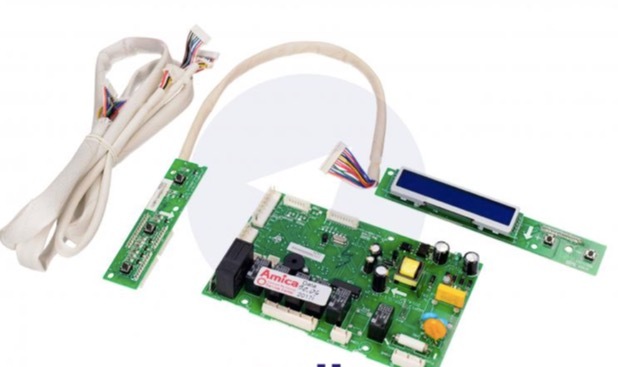

    #46 20455771
    janusz-szcz
    Posts: 110
    Rate: 48
    I took the dishwasher to the service center because everything I found in the user`s advice turned out to be incorrect.
    In the service - without going into detail - the control board was replaced (a set from Amica, i.e.:
    - Board with a display and two control buttons,
    - Plate with three control buttons
    - Main board, incl. with a transformer, with a control card attached - the inscription AMICA-U7311....).
    - 3 cable bundles with connectors.
    The dishwasher has been working without problems since then.
    I sold the old set of tiles as damaged, but the buyer did not report any problems, I believe that at least part of this set was functional.
