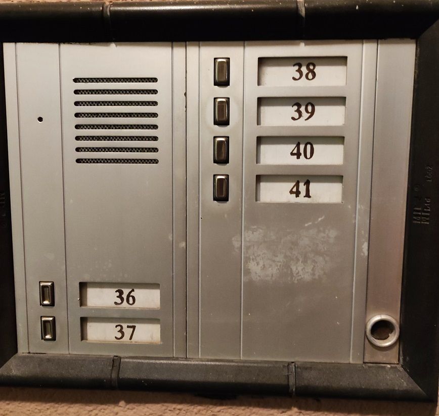

    Provide a photo of the calling cassette (at the entrance door) from which you are called.
  • #3 20920478
    JumalIO
    Posts: 6
    Thanks for the reply, this is the unit at the entry:
    Intercom panel with buttons and apartment numbers 36-41.
  • #4 20921409
    Ircys
    Intercoms specialist
    Posts: 6971
    Help: 1342
    Rate: 2085
    Approach one of your neighbors and ask to open the casing and take a photo of the connections inside, because if you do this you will be in trouble for a long time and it is not known whether these actions will damage the entire system in the gate.

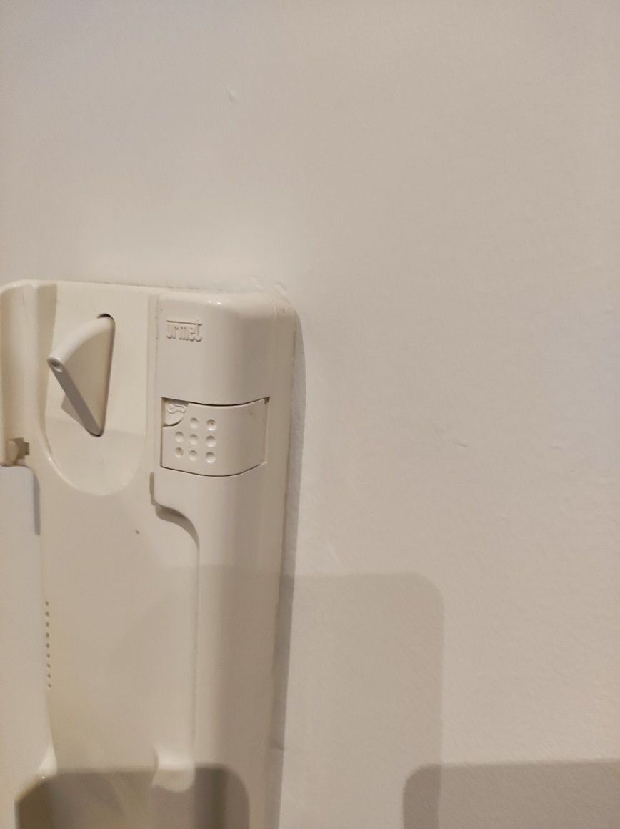

    No, that's not an option. They won't let me open the phone, I'm a complete stranger to them. I managed to take a picture of their phone if it helps:
    White intercom mounted on the wall with buttons and a lever.
    Can you tell which wire goes where by checking them with a multimeter?
    I have no other choice but to take a risk and find the right cables...
    (Translated with Google, original):
    No, that's not an option. They won't let me open their phone, I am a complete stranger to them. I was able to get a photo of their phone if that helps.
    Is it possible to know what wire goes where by testing them with a multimeter?
    I don't have any other options, just to risk it and find the correct wires...

    JumalIO wrote:
    No, that`s not an option. They won`t let me open the phone, I`m a complete stranger to them. I managed to take a picture of their phone if that helps
    The photo doesn`t add anything.
    You can also call a service technician for your system.
    If you really want to do it yourself, here`s a good guide:
    https://www.elektroda.pl/rtvforum/topic3289894.html from point 4.2
