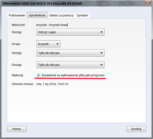

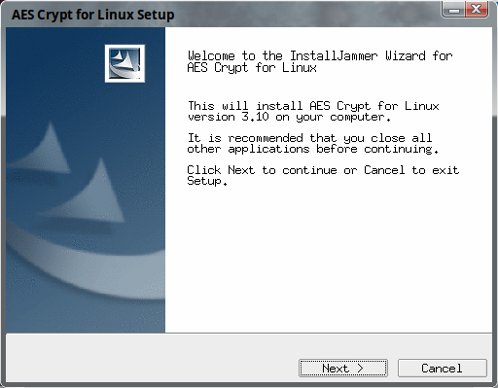

    Is the package the download folder I want to install? Maybe I'll start at the beginning. For example, I want to install the AES Crypt program, go to the manufacturer's website and download the Linux version. I save it in the Downloads file, unpack it and what do I do next? Because entering commands in the terminal does not do anything.

  • #7 15309879
  • #8 15309967
  • #9 15310039
    finlande
    Posts: 6
    yes, I have this option selected
  • #10 15310104
  • #11 15312890
    finlande
    Posts: 6
    On the third try it finally turned out :) I used this Midnight program. Christophorus you are a miracle worker, thank you very much. One more little question: will I have to do all these steps every time I install a program?
