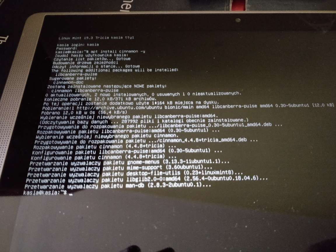

    adamm1709
    Posts: 1505
    Help: 44
    Rate: 107
    uname -a
    Spoiler:
    uname -a
    Linux kasia 5.3.0-53-generic # 47 ~ 18.04.1-Ubuntu SMP Thu May 7 13:10:50 UTC 2020 x86_64 x86_64 x86_64 GNU / Linux
    K_o_s wrote:
    if you have it:
    and ask me; I don't know if I typed it correctly (copied it)
    Spoiler:
    sudo apt-get remove --purge alsa-base pulseaudio
    [sudo] password of the user Kasia:
    Sorry, please try again.
    Reading package lists ... Done
    Building a dependency tree
    Reading status information ... Done
    The following packages will be REMOVED:
    alsa-base * cinnamon * cinnamon-dbg * libcanberra-pulse * mint-meta-cinnamon *
    pulseaudio * pulseaudio-module-bluetooth *
    0 updated, 0 newly installed, 7 removed and 0 not updated.
    After this operation, 7,121 KB of disk space will be freed.
    To continue? [Y / n]
    #11 18740736
    K_o_s
    Level 26  
    Posts: 629
    Help: 94
    Rate: 116
    So the sound chipset is supported on your system version. You have the ALSA drivers, but it looks like they're not picking up your sound properly. You have to look here, so I suggested reinstalling. Follow them, we'll see if it helps.

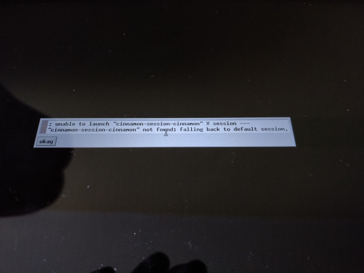

  • #12 18740748
    adamm1709
    Posts: 1505
    Help: 44
    Rate: 107
    ok but i don't understand what to do now. You mean press T?
  • #13 18740771
    spy
    Posts: 770
    Help: 86
    Rate: 261
    Yes, you have to press the T and keep it going until you reach it.
    These commands were from the thread https://forums.linuxmint.com/viewtopic.php?t=271667
    At the end you will find a link to this:
    https://github.com/heikomat/linux/tree/cx2072x/cx2072x_fixes_and_manual
    You have to apologize to google translator and start reading what people in the world write.

    there is still no sound, I wanted to enter "sound" but there was an error so I restarted it and such a surprise:
    Linux mint - no sound at all (and simple questions about linux itself will also
    I think linux does not like me ... I will screw something up as usual, I pressed ok but black screen and cursor

    As I wrote: I pressed ok but the screen is black and the cursor. Found some shortcut on the net ctrl + alt + F1 and it looks like I got into the console. As if it is full screen and nothing for it - I just had to enter the login and password
    EDIT: Now I see that you've added something.
    Added after 16 [minutes]:
    So this is what it looks like and what next?
