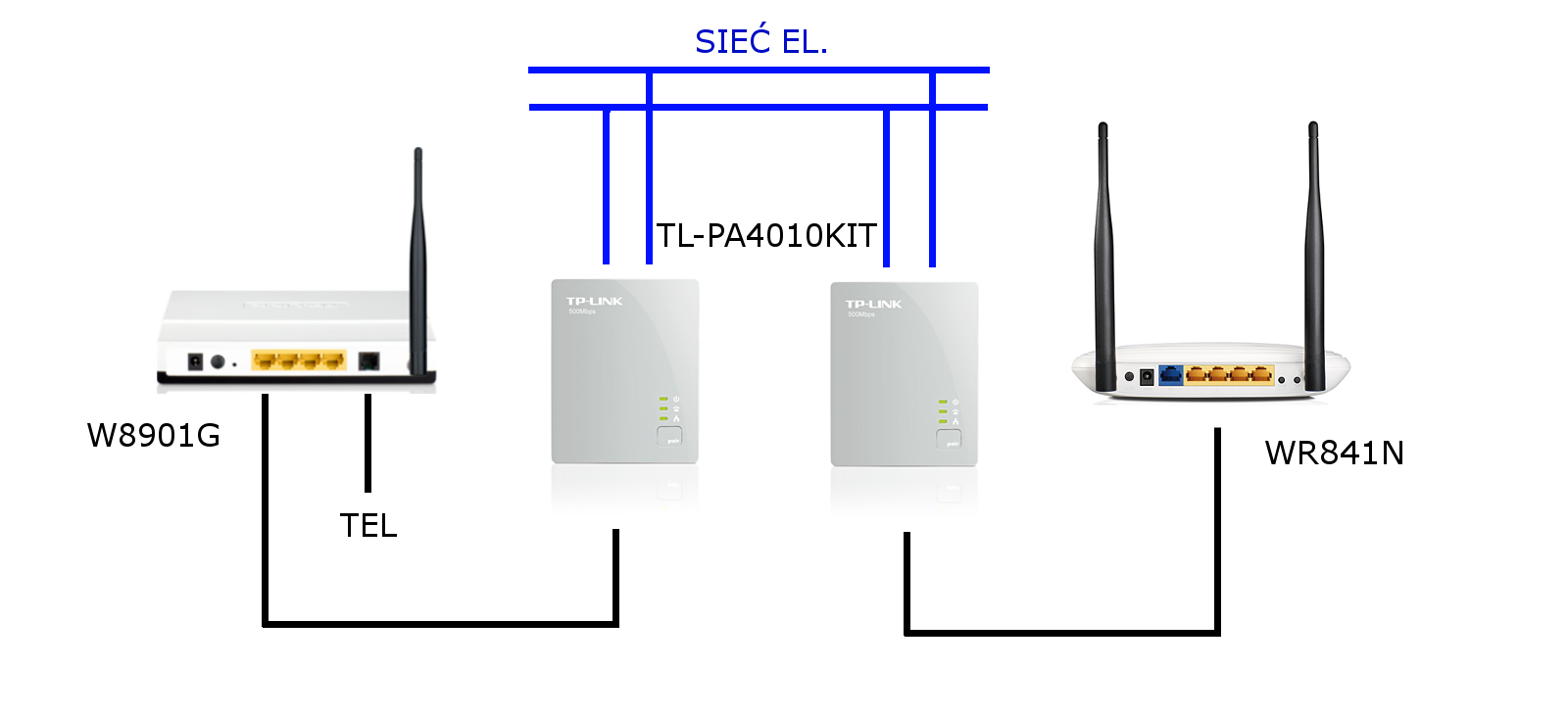

    For some time I have had a problem with the network at home, an error appears in the browser (as in the topic) every now and then indefinitely, once a day, sometimes every several minutes for an hour. It cuts off the internet completely, there's nothing you can do.
    Internet: Neostrada.
    The network looks like this:
    Main ADSL Router (DCP Enabled):
    TP-Link W8901G
    Access Point:
    TP-Link WR841N
    Routers connected with a LAN LAN cable, additionally with TP-Link Powerline transmitters. DNS servers set as recommended by Orange. Firmware updated to the latest version. WiFi on both routers the same, SSID and password the same, channels different (1,6).
    I have found that the problem only occurs when connected to the second WR841N router. I changed the software to DDWRT and the problem persists.
    What could this be a problem and why? I do not remember exactly when the problem started to occur, but it is definitely not the fault of the computers, because no matter what computer / phone I connect, there is no internet anywhere.
    In my opinion, the fault lies with the communication between the routers, but the signal in the transmitters is good, so it's probably not that.
    I am asking for some hints, best regards.

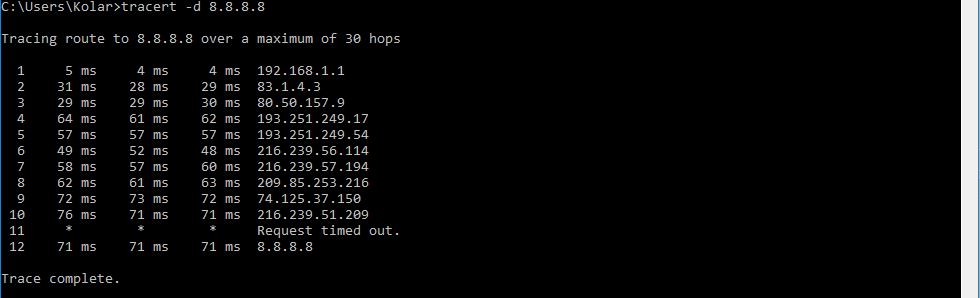

    How to cut off the neta show
    tracert -d 8.8.8.8
    ping IP_YOUR_ROUTER_NEO
    ping IP_NEXT_ROUTER_BUT_ YOUR_ROUTER

    Sorry to write back so late, here are the results:
    DNS Probe Error with Home Network: Neostrada, TP-Link W8901G & WR841N, Powerline Transmitters DNS Probe Error with Home Network: Neostrada, TP-Link W8901G & WR841N, Powerline Transmitters
    192.168.1.1 is the main ADSL router
    192.168.1.2 is the access point that I connect to normally, also during this test.
    I would like to add that after resetting the access point, the internet works again.

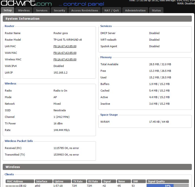

    Did you disable DHCP server in 841?
    Show status page with 841.
  • #9 15428621
    26eXpert
    Posts: 60
    Rate: 13
    Yes, DHCP is turned off on 841. Currently, I have DD-WRT loaded there, which I have uploaded to check if it is the fault of TP-Link software, but after the change (a few weeks ago) the problem is the same. Screen below.
    I wonder if this is not the fault of these transmitters, but I don't know how to check it exactly. The signal between them is quite good:

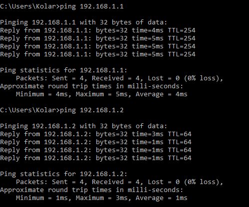

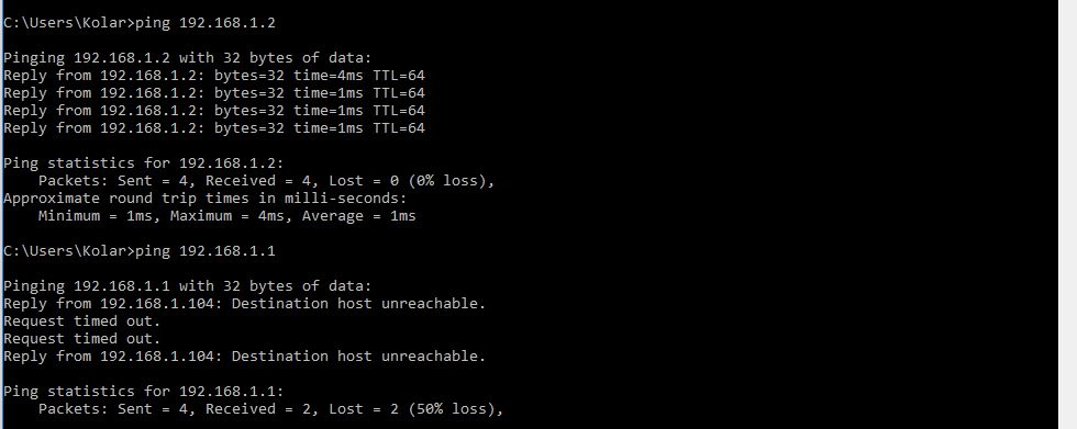

    Draw a diagram, place all devices, powerline, router, RJ45 ports.
    ping 192.168.1.1
    ping 192.168.1.2
    do both pings work as is net?
    do both pings work if there is no net?

    Diagram:

    There is a net:
    No net (192.168.1.1 net is back at the end of pinging):

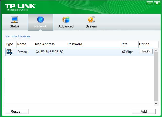

    How many mbs do powerline adapters tighten?
    It should be shown in the tplink program for adapters.
    If there is no net, you can see both adapters in the tplink program?
    - from page 8901?
    - from page 841?
    If there is no net, is there a net over the cable to the 8901?
    If there is no net, what is the state of the LEDs on the adapters?

    The adapters are currently clamped at about 70 Mb / s, while on the first floor the adapter is plugged in by a thief, when I plug it in directly, it is about 113 Mb / s. I have an internet connection of 7-8 Mb / s, so it is enough.
    On the 8901G, the internet is available all the time, even when the net on the 841 is cut off (but I don't know how it is over the cable, because it connects to the 841 via wifi).
    After cutting off the net in the Tp-Link program, the adapters can see each other, certainly from the 841 side, I haven't checked the 8901.
    I am also wondering if this is not the fault of the wifi in 841, I did not have time to check if the internet also cuts off the cable. The SSIDs are the same on both routers, channels are different, so it shouldn't be a problem, I guess?
