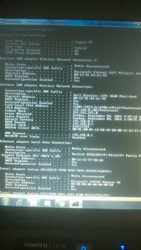

    Show all IPCONFIG / ALL because it doesn't show what is above.
    And do more ping 8.8.8.8 and ping wp.pl
  • #3 15910568
    sylwiawpotrzebie
    Posts: 17
    Rate: 17
    Internet Connection Issue: DNS Error Despite Successful WiFi Connection and Troubleshooting

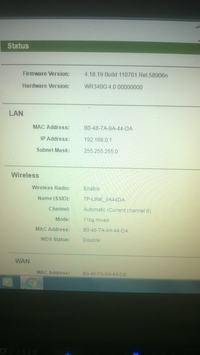

    You can enter the router's configuration page (http://192.168.0.1/ login and password admin ) and show full status?
  • #8 15910813
    sylwiawpotrzebie
    Posts: 17
    Rate: 17
    All diodes are on (wlan wlam sys pwr) Internet Connection Issue: DNS Error Despite Successful WiFi Connection and Troubleshooting

    You don't need to specify, so write only two starting octets from the WAN addresses, e.g .:
    ip 192.168.xxx.xxx
    mask 255.255.xx
    gateway 192.168.xx
    dns 8.8.xx
  • #10 15910835
    sylwiawpotrzebie
    Posts: 17
    Rate: 17
    88.156
    255.255
    88.156
    37.8 , 31.11
  • #11 15910850
    Heinzek
    Posts: 3732
    Help: 554
    Rate: 494
    So the router gets the IP. It is possible that this "old man" is damaged and does not transmit the Internet.
    You can try to reset the router with the button on the back. If that doesn't work, technicians may need to be called in.

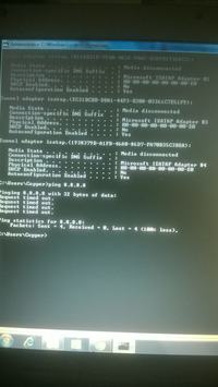

    It shows that the modem is responding. Go to the page 192.168.100.1 and take a screenshot of the modem operating parameters.
    Now ping 8.8.8.8 and then wp.pl. If there is no response, you will need to set the appropriate DNS server addresses on the router.

  • #19 15911652
    sylwiawpotrzebie
    Posts: 17
    Rate: 17
    Ping 192.168.100.1 did not produce any results

  • #21 15911809
    VooVoo
    Posts: 2177
    Help: 215
    Rate: 266
    You ping a completely different address in the photo - focus or let's give it up :(
