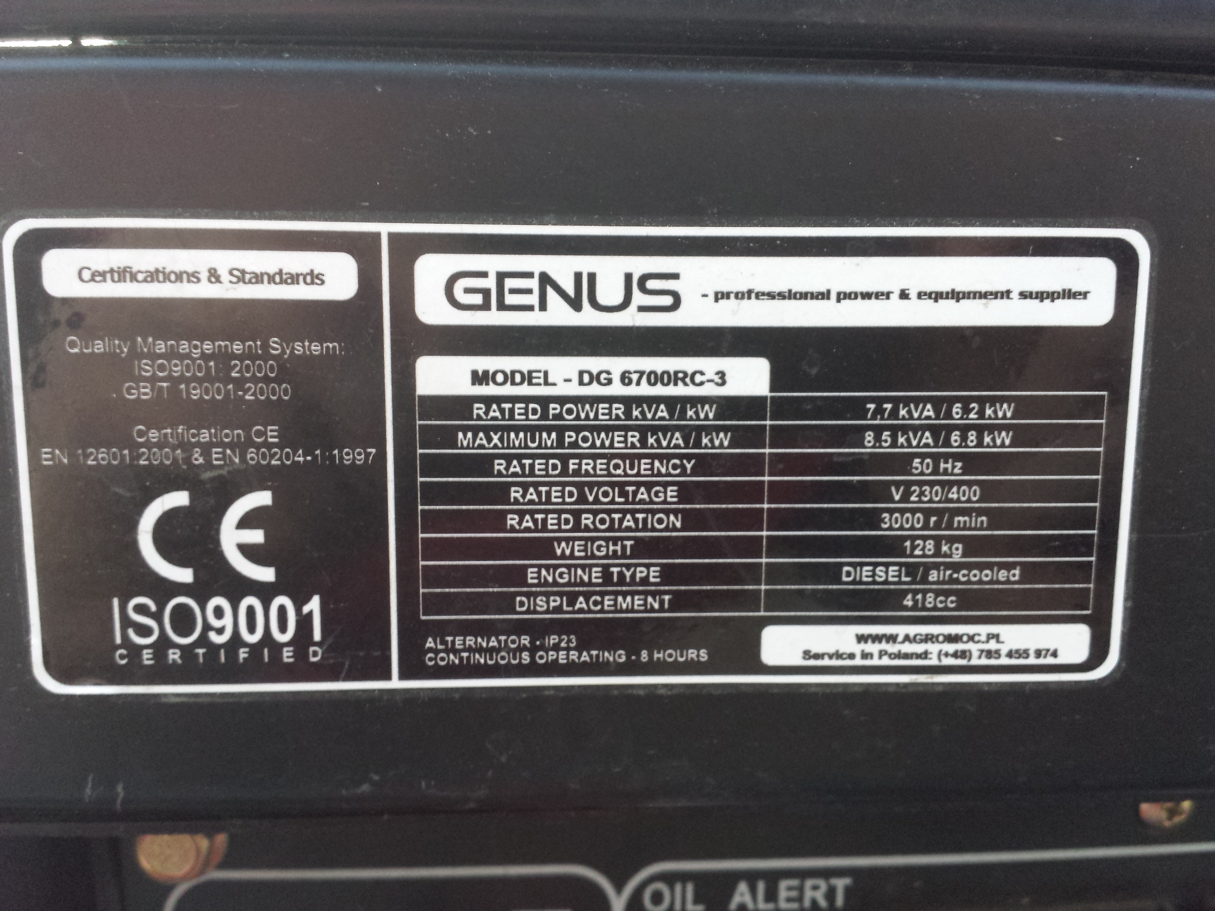

    I bought a Genus DG 6700RC-3 with a diesel engine for my construction site, it was equipped with a 320L concrete mixer with a 2kW engine, a 2200kw flex and a water pump. And everything went smoothly without any problems. The unit didn't even groan. Theoretically, it has a power of 6.2kW and under 80% load 6.8kW, I don't know if it's true, but it's really efficient and doesn't burn much. I bought it last year in June, worked all summer at the construction site and all winter like a fork and drilled at home for electricity and water. Like a bomb for me. In addition, it has an output for powering the house (the module for automatic activation in the event of a power failure costs about PLN 400), but my brother-in-law installed a manual power source switch in the box. Unfortunately, it is too weak for a plastering unit and it blows the fuse right away. My model has a 10A fuse and a 418cc engine but the 2016 models already have 16A fuses and a capacity of something around 458cc. At the moment, I have only replaced the starter because the sleeves have fallen apart (the service guy sent me a new one and I sent the old one back by post). In my opinion, if you do not have a company and the generator does not work non-stop after 10-12 hours, it is worth spending PLN 2999 (in my case) to build and finish the house if you do not have electricity on the plot yet. Yes, I know it's Chinese to some extent (like the voltage regulator, it even writes in Chinese), but parts such as a generator that is actually all copper and not aluminum painted in copper color will give you the opportunity to connect equipment during construction with a relatively low operating costs.
    For me, a big plus is the remote control, when I drill on the first floor, at least I don't have to run up the stairs like crazy to start and turn it off every now and then.
    And below is the nameplate from the generator
    • What power generator for construction, which will also work at home 2238658200_1451510479.jpg (4.47 MB) You must be logged in to download this attachment.

    I dealt with these engines, those with a capacity of 418 cubic meters work in compactors, salt spreaders, tractors and pumps, it is one and the same engine only in the aggregate, it is twisted at 3000 revolutions, has a centrifugal regulator and a conical shaft.
    The real power of such an engine at 3600 rpm, i.e. maximum speed, is 7 kW or about 9.5 HP, in the unit at 3000 rpm it is 6.5 kW or 8.8 HP.
    It is not possible for a motor with a power of 6.5 kW on the shaft in the aggregate on the sockets to give a power of 6.8 kW
    Counting all losses, winding heating, etc., we will get a maximum of 5.5 - 6 kW
    Colleague BASS colors I don't know why, a 3-phase unit on a 418 cm motor will safely give up to 2 kw per phase, be careful with flexes and devices with motors, we have starting current, flex 2.2 kw will get us the stator winding at the first start
