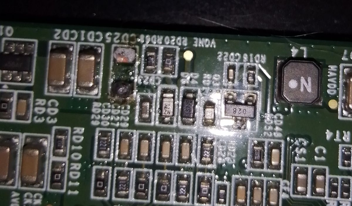

    I found a CD25 capacitor on the t-con board and after desoldering the voltages came back but I don't know what to put in because I don't know the value of this capacitor. I can not replace the t-con either because it is an integral part with the panel. Maybe someone will suggest what value can be assumed?

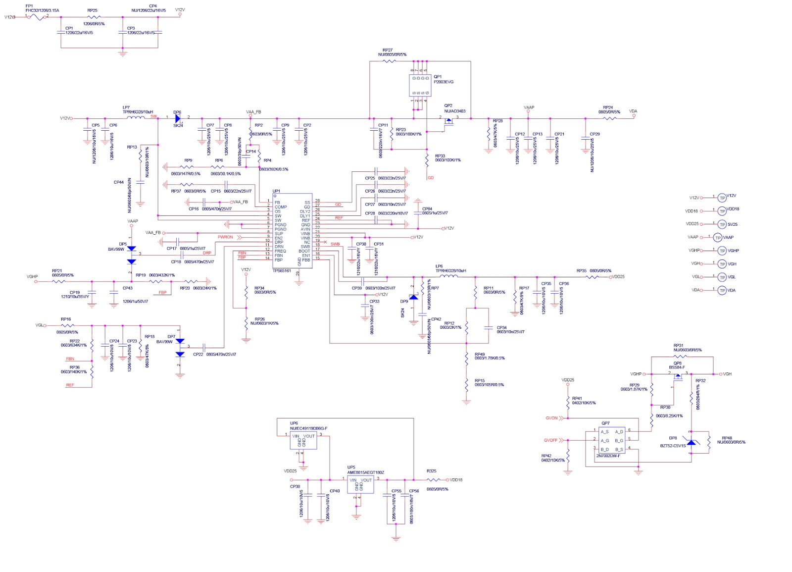

    There is no datasheet for this QFN-88 pin SM4108 chip
    Usually it rains C connected to pin 1 of this system, unless it is responsible e.g. for:
    - for example VONE as is in layout. with Q3 transistor (pnp ala BD140 / ZTX)
    * (or HAVDD)
    Orion 32LBT731 TV: No Picture, Backlight & Audio - VES315WNVS-01-B, 17MB82S, 17IPS19-5 Issue

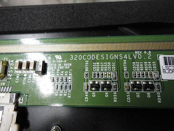

    * with t-con 320CODESIGNS4LV0.2 for VES315WNDS-01 matrix
    * the same SM4108 is on
    - T-con 1CA320AP18S4LV0.1 for matrices: LTA320AN01, or its "analog" TCL LVW320SSTM E1
    - TA320AP05 matrix and T-con: A320AP20S4LV0.4
    You have to look at the solutions of other systems. DC-DC SM41xx, something was written in this forum
    Or similar as DC-DC, e.g. TPS65161, CM501
    Draw on a piece of paper the layout of work with this C (damaged) and by analogy

    ps
    Damage with T-con on this SM4108 is
    - usually there is backlight, no image or pin lines on the screen, or a horizontal duplicate image, milky image (image content visible behind a transparent white curtain),
    sample voltages from the LTA320 matrix ...
    VIN = 11.9V
    VCC = 3.25V
    VDD1 = 3.25V
    VDD1L = 3.25v
    VONE = 27.8V - up to 29.7V
    VOFFE = (-8.9v) with a minus
    AVDD = 15.8 - up to 16.5V
    HAVDD = 7.8V
    VCOM usually around 1/2 worth (AVDD)
    - made on a separate IC SOP10-pin (2x 5pin) code: 043z that is ISL45043IRZ
    Orion 32LBT731 TV: No Picture, Backlight & Audio - VES315WNVS-01-B, 17MB82S, 17IPS19-5 Issue they usually stand ceramics at 4.7-5uF

    Thanks for the hints, Lisek is about voltage VONE on this capacitor is now 29v. I will immediately substitute and check if this Q3 is still not stoned.

    CD25 replaced, I put 5uF but additionally replaced the Q3 transistor because it stuck. The TV is working properly. Thank you for your help.

    Please, what transistor is used for Q3 on mine, it has the designation O28 and I can't find what it means.
  • #9 21603459
    tofydu21
    bonjour si vous avez trouvé une solution je suis intéressé est ce que vous avez trouvé le transistor Q3 car j'ai le même problème et je trouve pas le transistor Q3 ?
  • #10 21603557
    lisek
    Service technician RTV
    Posts: 39992
    Help: 6352
    Rate: 6883
    above is written
    Q3 (pnp ala BD140/ ZTX)
  • #11 21603809
    tofydu21
    >>21603557
    Bonjour avec la référence : Q3 (pnp ala BD140/ ZTX je ne trouve pas.. mon transistor Q3 écrit 028 ressemble à la photo . J'arrive pas à trouver sur internet.pourriez vous me dire où trouver ? Svp
