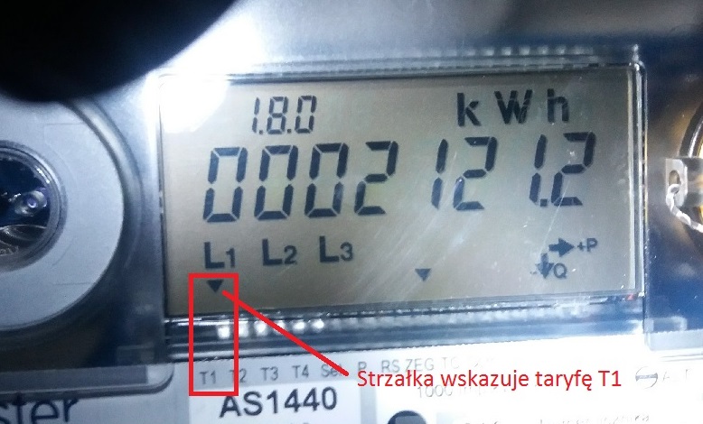

    Jarmie wrote:
    Yesterday I checked the meter set up by PGE. The counter model is Elster AS 1440 (http://ietsklep.pl/07-licznik-elster-as1440-w34c.html). With a total production of about 2.8 kW from a three-phase inverter, i.e. about 0.9 kW on a phase, a load of about 2.5 kW on almost 1 phase, within 3 hours the meter, even after a decimal point, did not show the movement of the consumption counter, i.e. it balances between the phases . After 8 hours of observation, the consumption of 1.1 kWh was recorded in the first tariff, 1.7 kWh in the second, 6 kWh in the second tariff, and 0.5 kWh in the second, but this resulted from partial cloud cover in certain periods of time.
    Does anyone know how to check the current tariff in this meter? Does it count with T1 or T2?
  • #41 16487044
    akrawiec
    Posts: 165
    Rate: 45
    At the bottom left of the meter screen, an arrow pointing to T1 or T2 is visible under the symbols "L1 L2 L3".
    The symbols T1 T2 T3 T4 are printed on the housing under the window.
