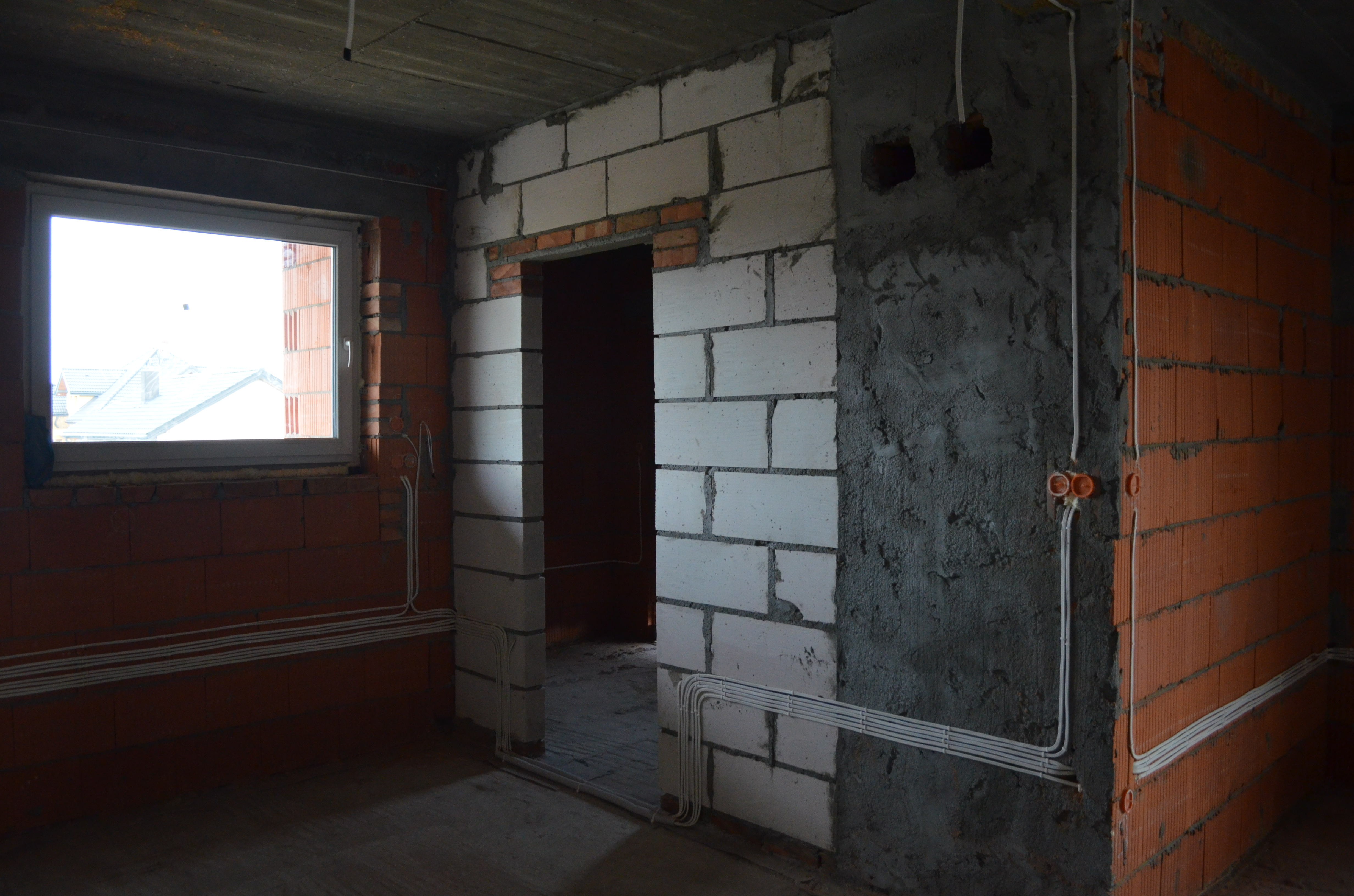

    I used to work as a technologist / programmer and this is my original template cut on a laser made of polished stainless steel :)
    But a piece of plastic or a hard cardboard will work just as well, it's just a matter of durability.
    The spacing is selected for 3x2.5 cables, but smaller ones are also suitable, they only have a slightly larger distance between them, they also fit 4x1.5mm.
    I make all the holes with a 7mm drill.
    This is what it looks like:

    Come on, buddy :) . I want that too and I will try to make such a template. What else, I will be laying the wires boxless, I'm going to pull the wires to the farthest room first, and so on, is this the correct method? In addition, the wires for 3x2.5 sockets, which will be 30 cm from the floor, better to put on the wall next to the lights, or under the floor in a conduit?
    I am going to place the light switch boxes at a height of about 125 cm from the floor and 20 cm from the edge of the door, will it be okay?

    As for the route of laying cables, each concept has its supporters and opponents, it is not for me to judge which is better and which is worse.
    I do not need junction boxes, I connect everything under the accessories in deep (60mm) boxes using WAGO connectors.
    I do not know what my colleague has experience in this matter, but if it is small, I recommend arranging at least two meetings with an electrician: the first where he will suggest and advise on the spot what and how to do, and the second where he will check how it was done and whether everything is OK

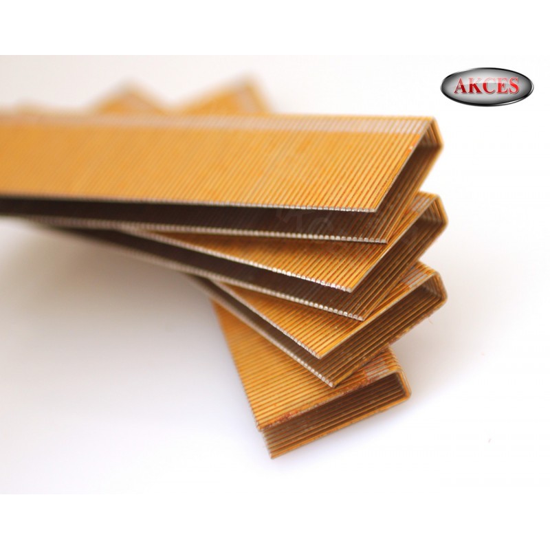

    I use the following staples to fasten cables in aerated concrete:
    Best Methods for Securing YDYP 3x1.5-2.5 Cables to Aerated Concrete Walls
    I am buying a pack of 15,000, enough for a few construction sites. I use the same staples to nail the alarm and antenna cables.
    The only inconvenience is that you have to separate them before nailing.
    The standard length is 40-50mm.

    These staples are a very interesting solution.
    So far I have used USMO type brackets for small diameters, antenna and LAN cables fit perfectly but the thin alarm cables had a lot of slack, which was manifested by sticking out from the wall.
    I also tried thermo-glute for the alarm bell, but it requires cleaning the substrate from dust before sticking it, and it does not give as certainty as the handle.
    It is a pity that I have little contact with aerated concrete (about 10% of construction sites) and the staples are unlikely to enter into harder materials.
    A friend uses a tacker or nails them by hand?
    Is there no damage to the outer insulation?

    As for staples, it is an interesting option, there must be an electric tacker for sure, but how is it held in aerated concrete?

    Worse, when a bricklayer knocks these staples into the cord. Then it's fun.
    And the taker is a failure, so hit the wires with it as much as you can, buddy Lidben.
    If it does not hold, correct it with a hammer.
