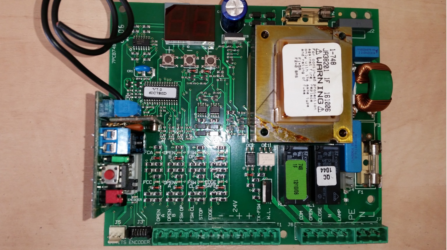

    Hello. I am in possession of the FAAC 740 gate drive. I learned that in order to program remotes for it, the following steps should be performed:
    1.Take off the red jumper
    2. Press the red button. And put a jumper on it, the red LED should light up.
    3. Press the button on the remote control and hold it until the green LED lights up.
    4. Press again to make it go off
    5. The End.
    The problem begins at point 2, because in addition to the red LED, the green LED also lights up and after the entire algorithm has been executed, the remote control works only once, then the drive does not detect it again. I would ask for help. Thank you in advance.

    ... remove the red jumper or switch off the power. They don't write anything about it in the manual?

    fredpostrach wrote:
    Does anyone know the answer to post # 1?
    Read post # 2 ....
    Let me once again describe the procedure / correct errors in the topic ...
    1.Take off the red jumper (or turn off the power)
    2. Press the red button. Set the jumper (or turn on the power), while keeping the button pressed, then release the button - the red diode should light up.
    4. Press the same button again to turn it off.
    4a. Press the second button of the remote control (for a two-channel receiver with a transmitter on the radio board).
    5. Repeat the procedure from point 2 to 4a for each transmitter.
    6. Remove the red jumper for a while and reinstall it (or turn the power off and on)
    7. The End.

    so it goes like this:
    2. Press the red Learn button. While holding the red Learn button, put the jumper on (or turn on the power) while holding the button down and then release the button - the red diode should light up.
    --------- And here it lights up red and green simultaneously.
    3. When the red extinguisher remains lit green and now press the remote control button, the diode will go out once more press the green diode will flash.
    4.Take off the red jumper for a while and put it back on (or turn the power off and on), this causes the device to remember.
