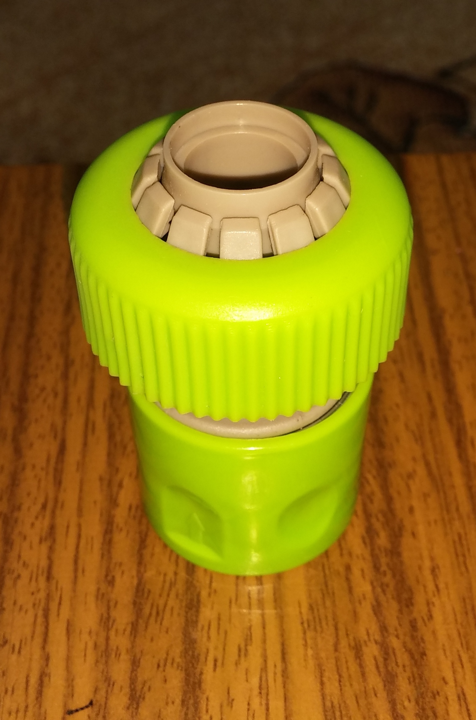

    I have a problem with a 3/4 quick connect garden hose coupling. Namely, when connecting the hose to the quick coupling and opening the water, quite a lot of water starts to drip from the hose side. I don't know if it's a matter of these teeth somehow holding the hose poorly. I also read somewhere that the hose has to be cut perfectly at the end. Maybe you need to buy something better though, like brass quick couplings or plastics from a better company?
    Pictured here is a quick release coupling I bought for just PLN3.
    3/4 quick coupling for garden hose - leaks, what do you recommend? .
    What can you recommend to solve my problem?

    Sometimes the thickness of the hose is too thin and the nut cannot press the serrations well to seal properly. Then it may help to put some thin T-shirt over the tube, the one in the middle, and only put the hose on it.

    I don't choose specifically, but this is the repair I applied myself when I saw that the hose was trying to slip.

    The problem could be an old and hard hose, or a mis-matched diameter.
    Rather, it is certainly not the fault of the quick coupler.
    Put the end in boiling water and try on a soft hose to twist it.

    Push the hose firmly to the end. You need to be sure that you have inserted it well. Also cut off a few centimetres of the hose so that it is not exaggerated at the point of attachment.
    Even cheap bad hoses shouldn't leak that much, although the price translates into quality. In addition to the recommended Gardena for 3/4 hose, I use 'White Line' fittings and they hold very firmly.

    If the hose doesn't stick then wrap insulation around the end a few times, in my case it worked but the hose has to slide into the quick release with resistance.

    Thanks to everyone for the suggestion. I took your advice and so far everything is fine.
