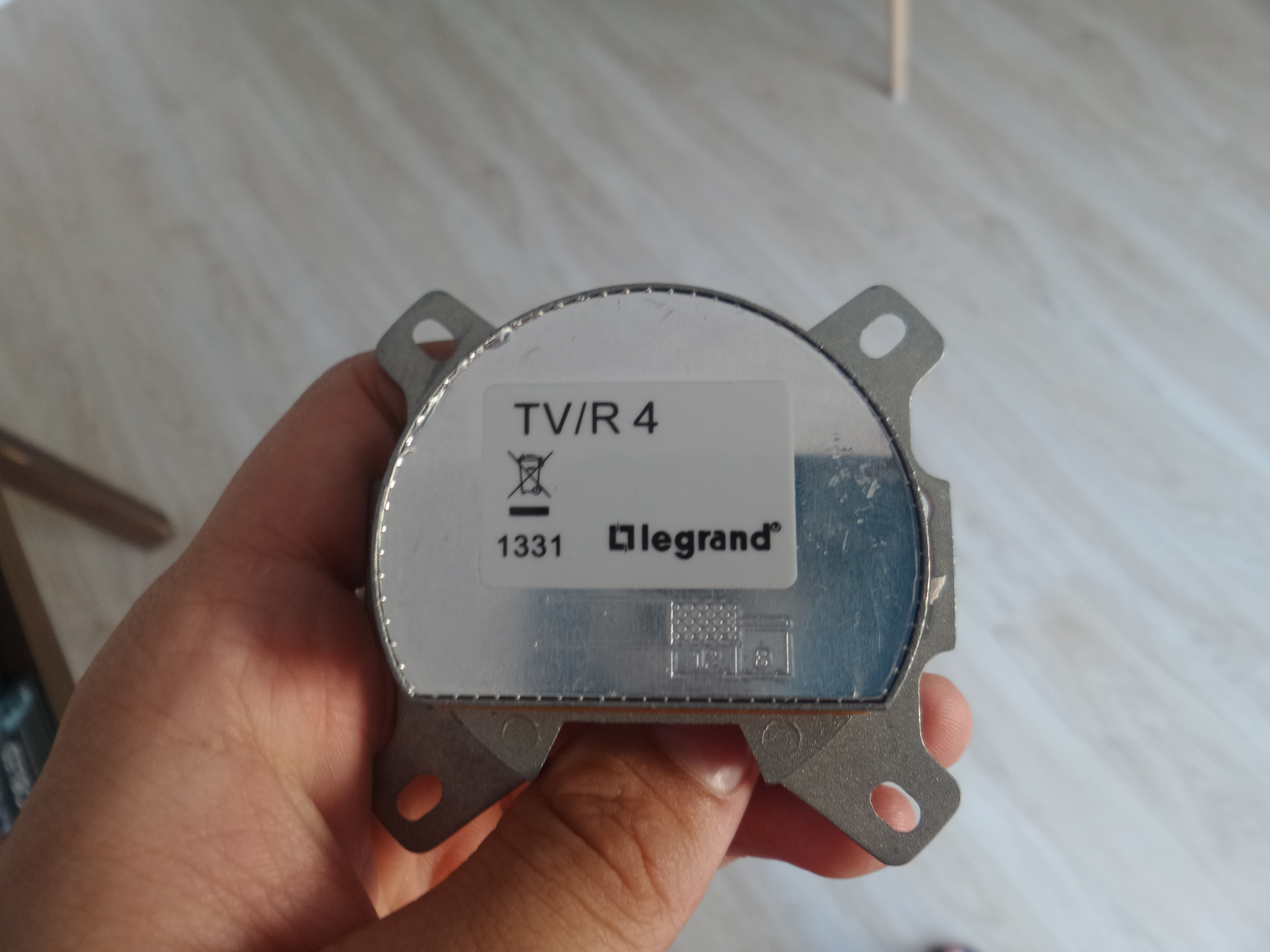

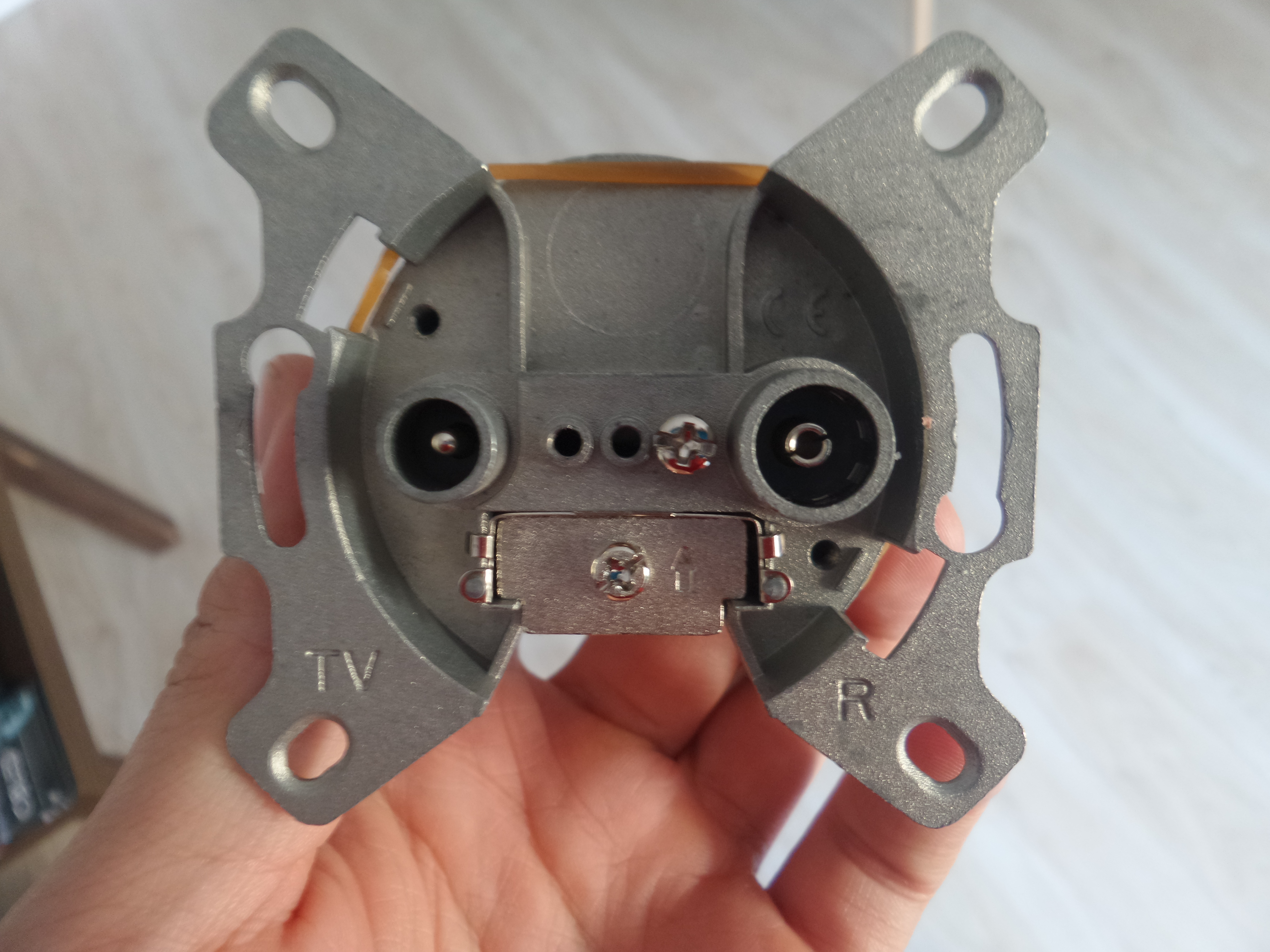

    I have a just Internet access service from UPC.
    Unfortunately, there is only one cable to my apartment, so I do not have access to terrestrial TV. I read that apparently UPC provides free-to-air channels. My tv (LG 32ly330c) has DVB-C support, but it doesn't search for anything. Are these free-to-air channels only for customers who have TV service or what on earth?
    Greetings.

  • #7 15710655
    KOCUREK1970
    Posts: 35673
    Help: 3862
    Rate: 5490
    spibuba wrote:
    One cable goes into the apartment, then there is a 1 to 2 splitter with power pass, the cables go to 2 different rooms.
    And this divider is it?
    spibuba wrote:
    I entered them according to this instruction:
    Did you notice that too?
    Modulation: 256 QAM
    Symbol rate: 6900 kS / s
    And I understand that you are sure your tv supports DVB-C (cable band)?
    2-way 5-2450 Mhz Power pass

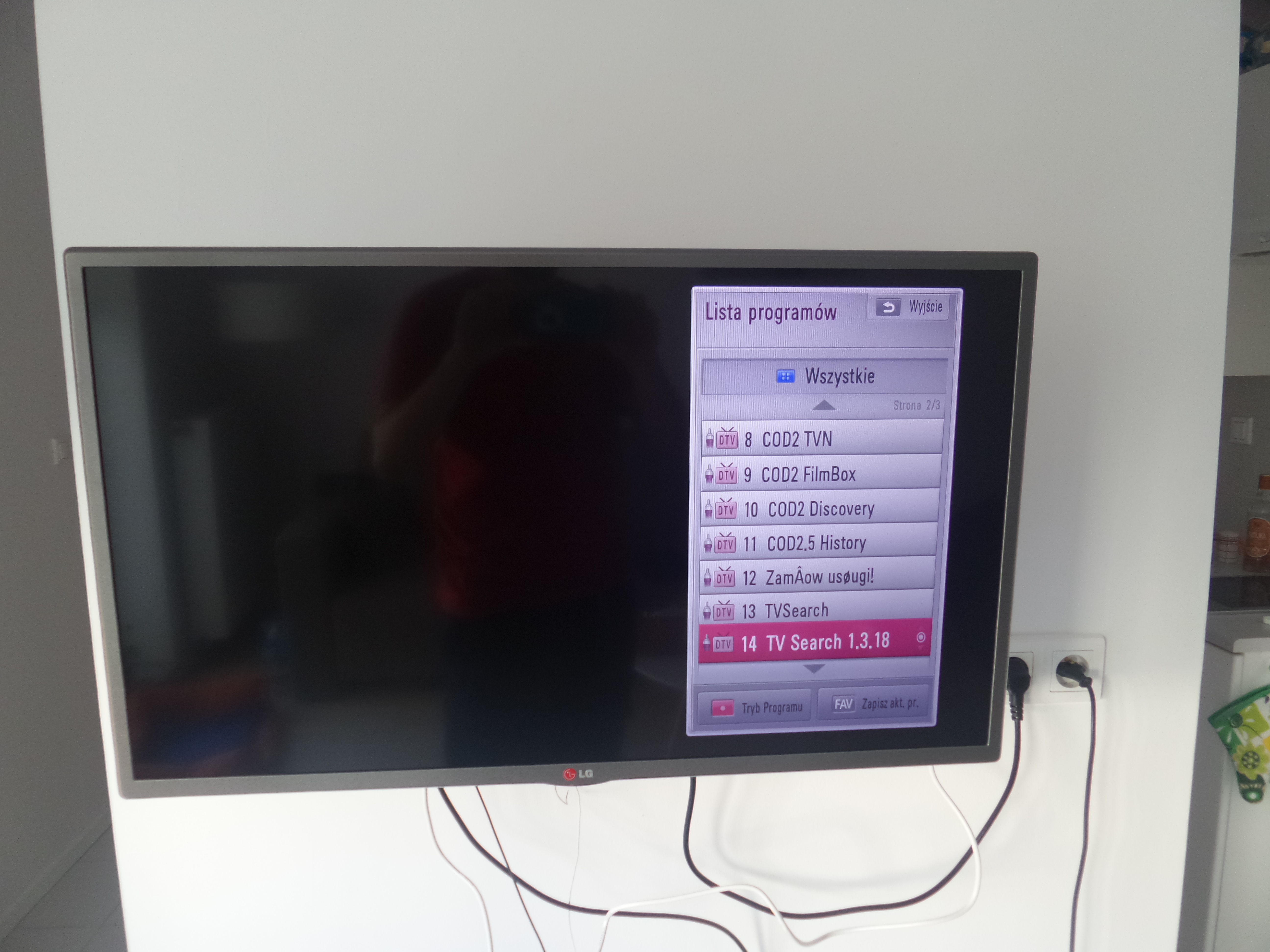

    Modulation: 256 QAM
    But of course I noticed ... and YES I am sure that it supports, if he did not handle it, I would not delve into the topic.
    Tv detected some channels but throws the message "CI module missing".
    Tv searched everything "big" and that's why this effect.
    Delete what is unnecessary and leave what works, or call UPC and ask on which transponders they transmit this packet and then search manually.

    #15 15730381
  • #16 16061158
    mieszko I
    Posts: 483
    Rate: 71
    After replacing the modem, they noticed that after passing the digital decoder a few years ago, the filter in the box on the cage was not installed.
    The fitter said that after passing the decoder, UPC should have the filter installed and the crossover dismantled, but customers are not willing to let them into the house,
    for what reason, since they have to deliver the decoder to the nearest point, which is usually in the provincial city.
    It would be different if they came, picked up the decoder, disassembled the crossover, installed the filter and checked the correct modem parameters.
    But it is a service that reduces the subscription and there is little interest here - costs, no order, no additional costs.
    (that's why the fitter ran very quickly to install it :-) )
    I watched analog TV as a black cloud came and covered the plate in a stormy season, a few minutes a year.
    And I completely missed the period in which supposedly DVB-C channels were working, now, after installing the filter in the box on the cage, there is no analog signal.
    The filter effectively blocks the bandwidth, and the TV (and DVB-C decoder) searches for me 55 dollar channels, encoded :-(
    The filter blocks / cuts the DVB-C band or the cable is plugged into the Data crossover.
